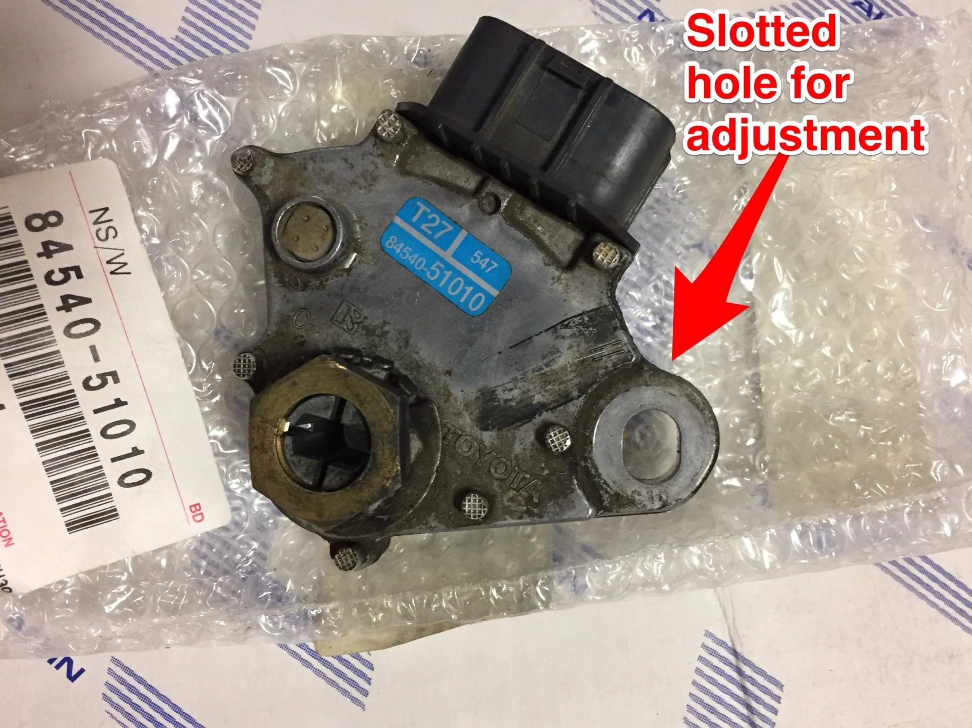

You might want to double check to make sure it didn’t get out of adjustment.
It has to be almost aligned perfect before it will work. It is worth a shot.
This is what it looks like..

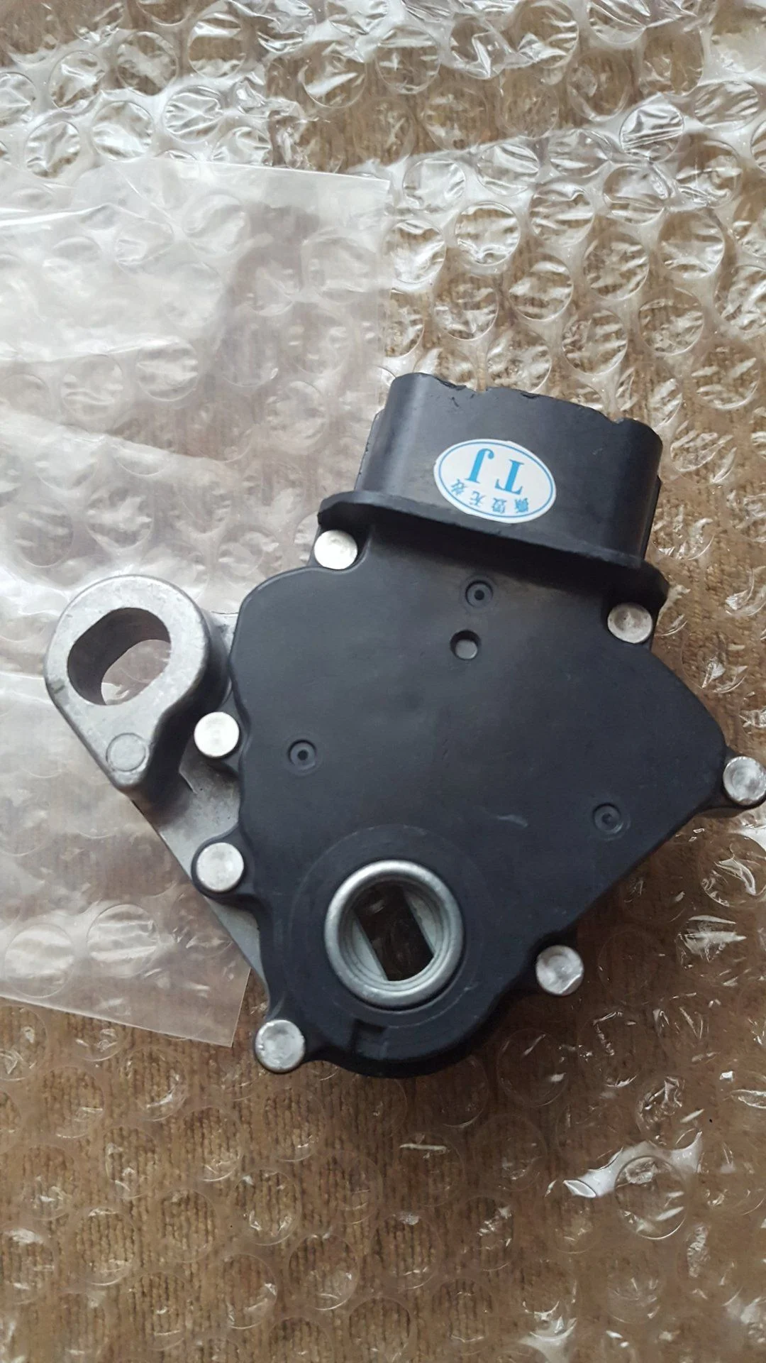

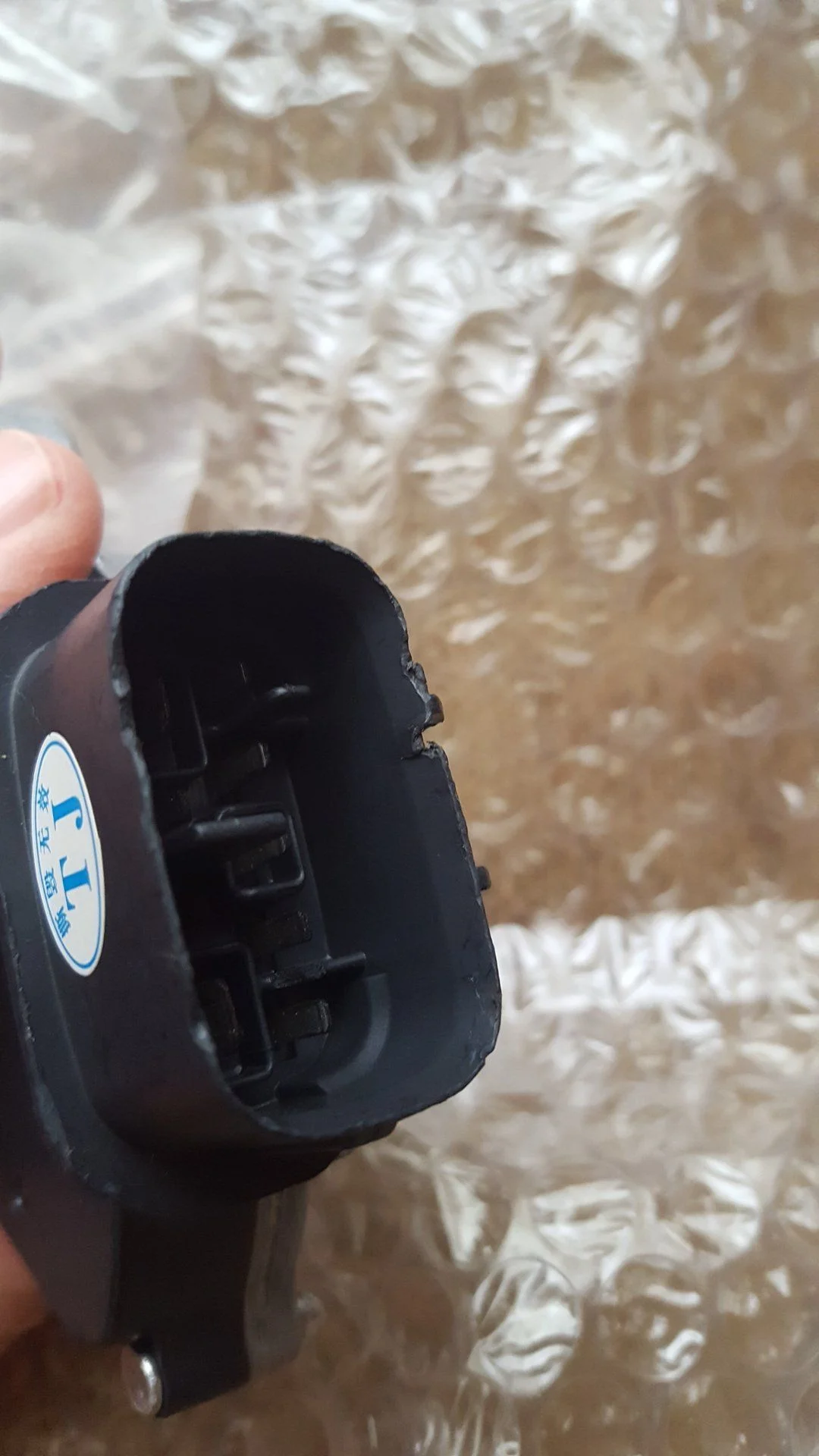

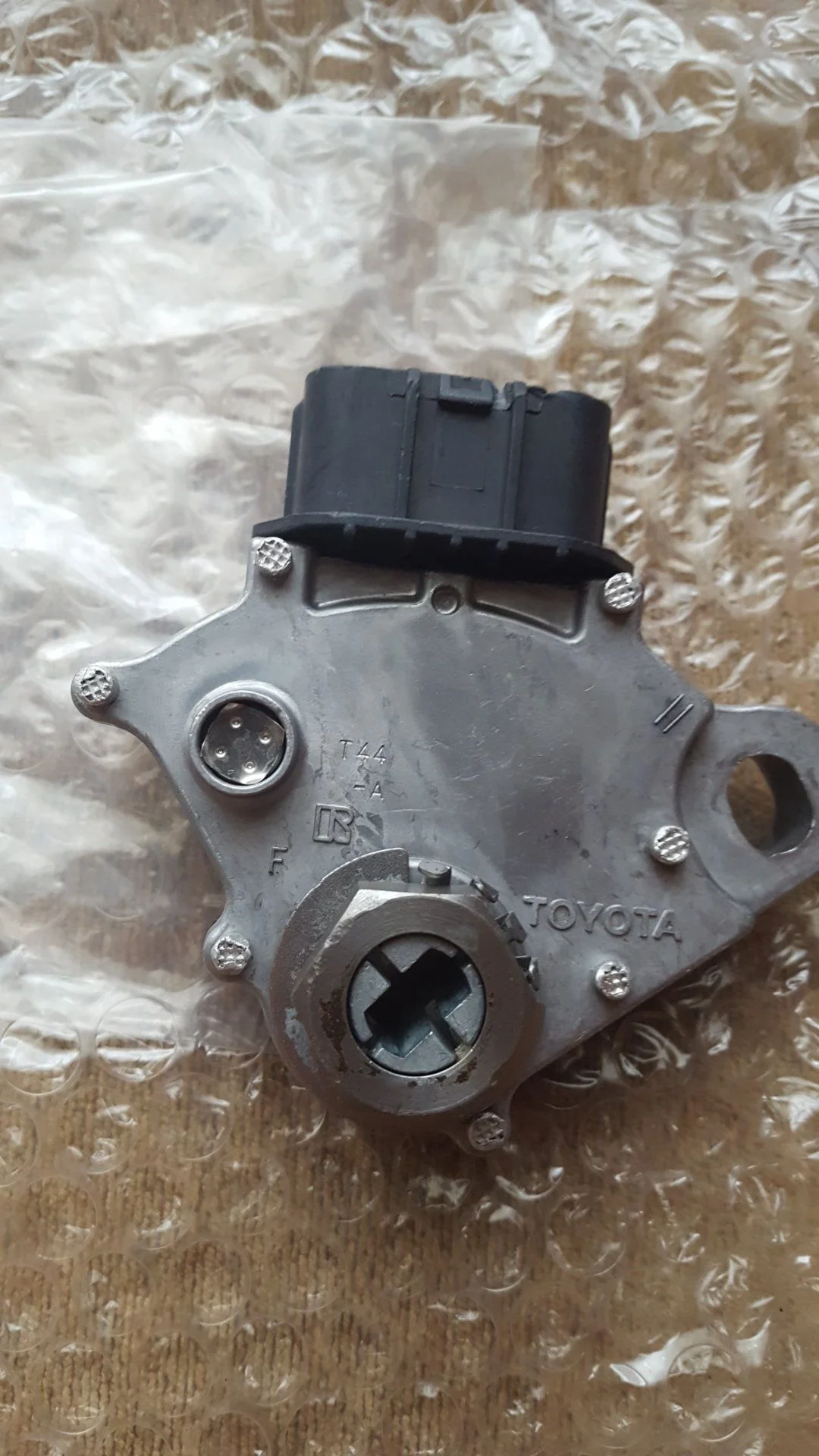

The neutral safety switch might have simply been out of adjustment as suggested above. Regardless, I ordered a new switch off of Aliexpress from China for $45. I realize the risk of ordering parts from China, but thought I would give it a try (cheaper than the $250 prices for genuine that I had been seeing, although Rock Auto had one with TOYOTA raised letters for $146).
Regardless, the switch from China finally arrived and surprisingly, it looks like a genuine Toyota switch (see below)? I don't think it is counterfeit, but it could either be re-manufactured or just a reject. Notice the damage or defects around the plastic shroud that goes around the connector. The plastic is kind of chewed up a little bit? The nut and washer also seem to have some crud on them and a few scratches (it actually looks better than the pictures)... This leaves me to believe that the part I received might be used (maybe remanufactured). Regardless, at $45, I'll give it a try.
I will install this afternoon and see how it goes. Just wanted to share the pictures.

I have the same issue. Any thoughts @outdoorsman suggestion to adjust it? I have an FSM but couldn't find the process or even the location.
Still searching, but thought I'd ask. Thanks
@Qtonic, I'm not sure about the adjustment other than moving it slightly in the oval hole shown in outdoosman's picture. Also, you will notice that there are 2 small raised lines in the metal near the oval adjustment hole, I can't remember if there was a corresponding line where the switch mounted or not, but maybe? Hopefully @outdoorsman will have some better adjustment advice.
