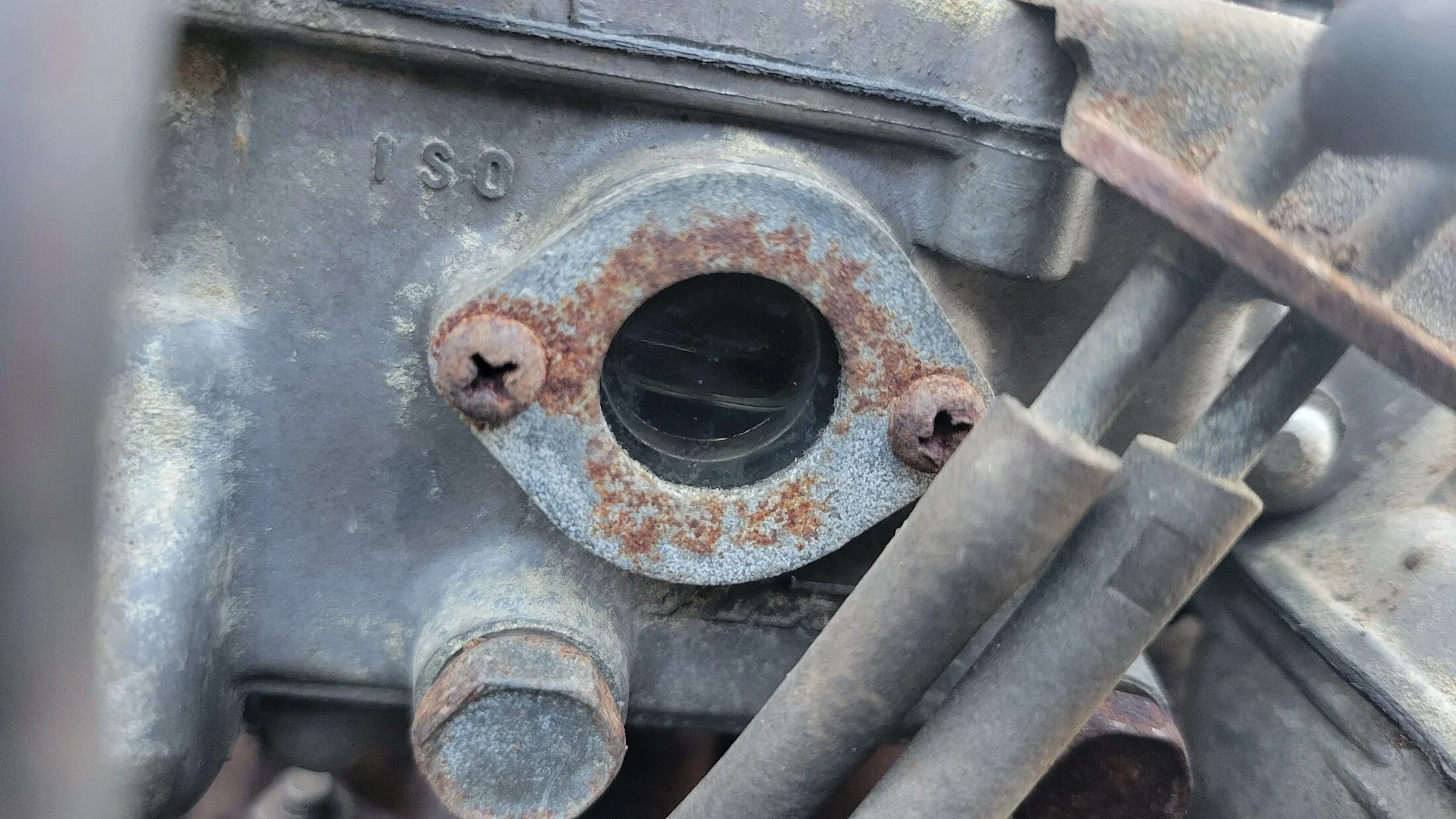

Here is my fuel level in the sight glass with it running
Do you have, or can you get, a vacuum reading from a vacuum gauge?
I am not familiar with sight glass indicator enough, Mark A would be able to tell by the pic if that is sufficient & he did not mention an issue there in his post so I would assume that bowl level is ok.
