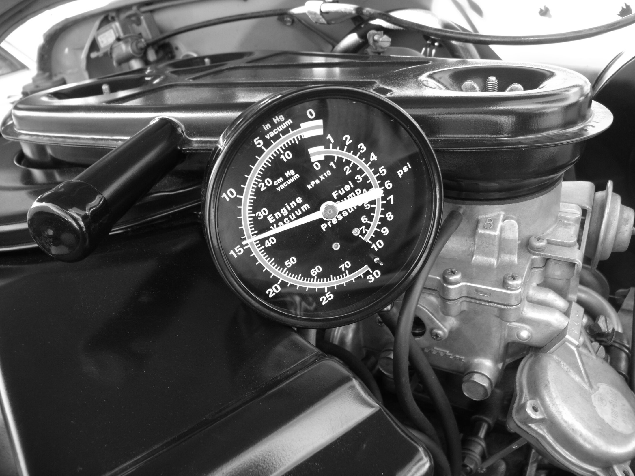

1. Fix all vacuum leaks and get vacuum to read 16inHg or more at sea level. Subtract 1inHg per 1k feet of elevation.

How about a pic or two of where you think it's leaking, and it's surroundings?
I couldn't get a picture of mine because it's dark here but I found one on Google, but this is where its leaking at. Whenever I spray that hose with starting fluid the engine revs up
