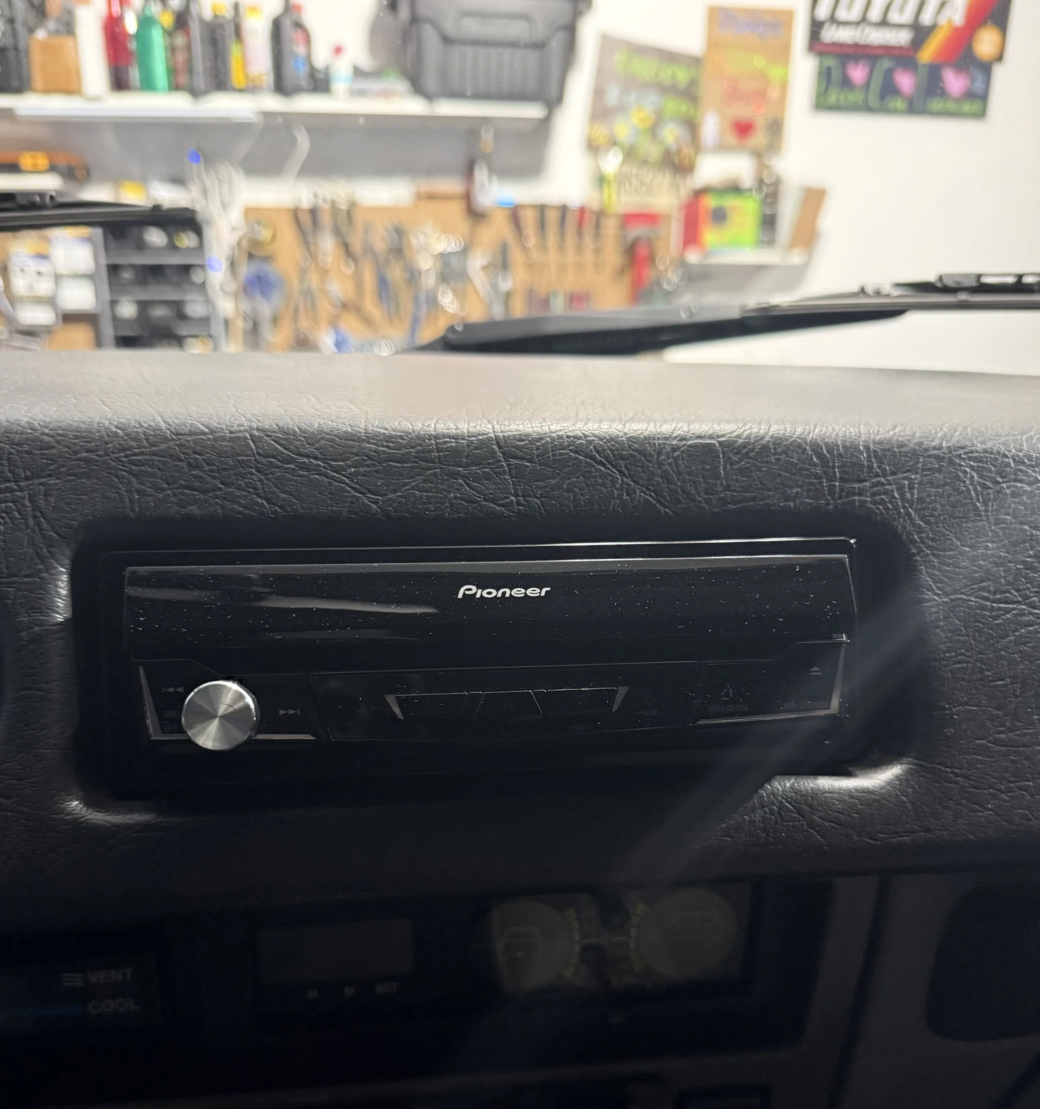

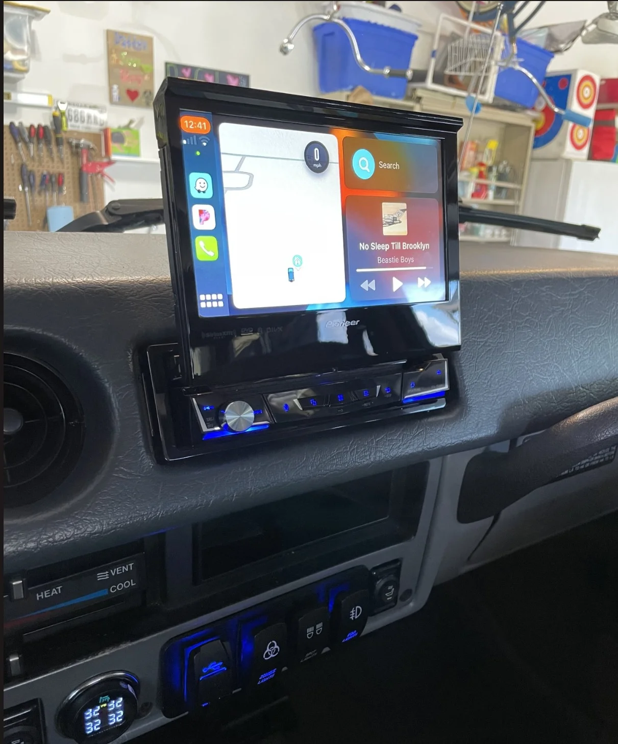

I have a pioneer DMH-WT3800NEX in my van. It allows 2 cameras, and selectable always on with easy switching between front and rear camera in my case. I like to keep the rear camera on when towing b/c I have no rear windows. It will put it in a smaller window on the screen if you want so it's less annoying. My only complaint is that it is full touch screen and no physical volume dial. It installs into a single din slot, 9" diagonal screen IIRC.

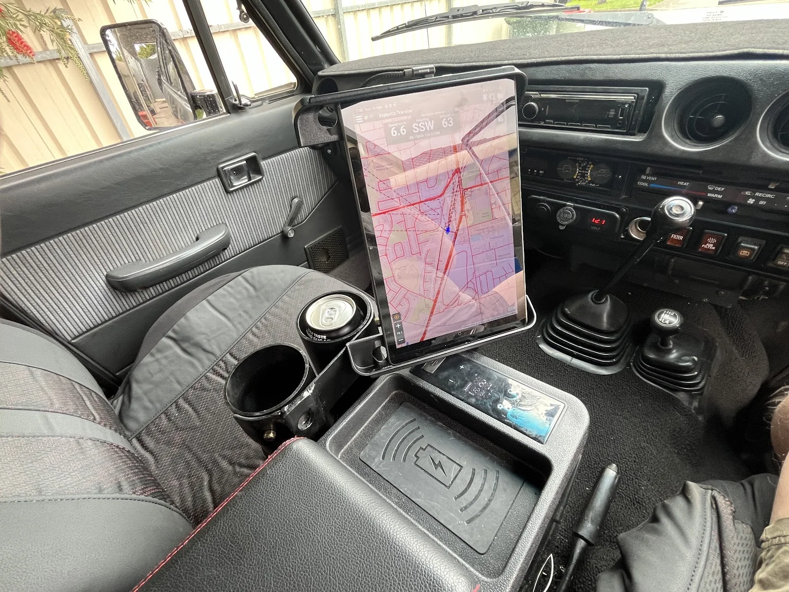

I fly solo.. so my navigation tablet is front and centre. On the rare occasions a passenger has the misfortune to accompany me they are still quite comfortable unfortunately..
