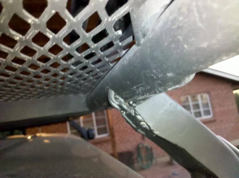

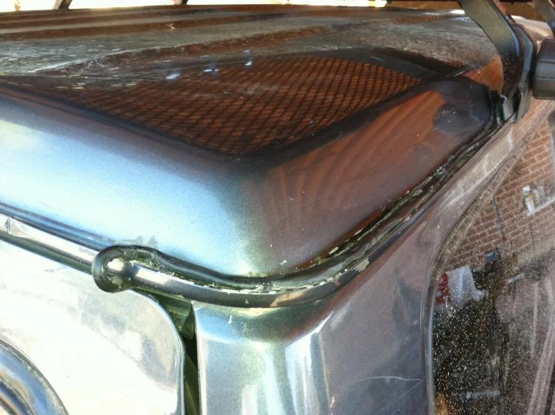

I ran my wires out of the back corners of the hood, and then up the side gutters on what i think is called the a frame. there is a nice crack you can slip your wire into between the hood corner and gutter. If you take a look you will see what i mean.

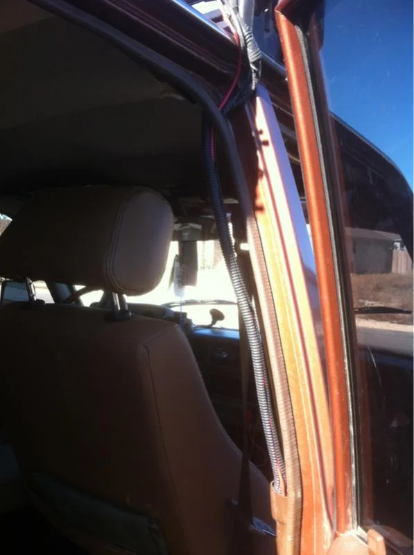

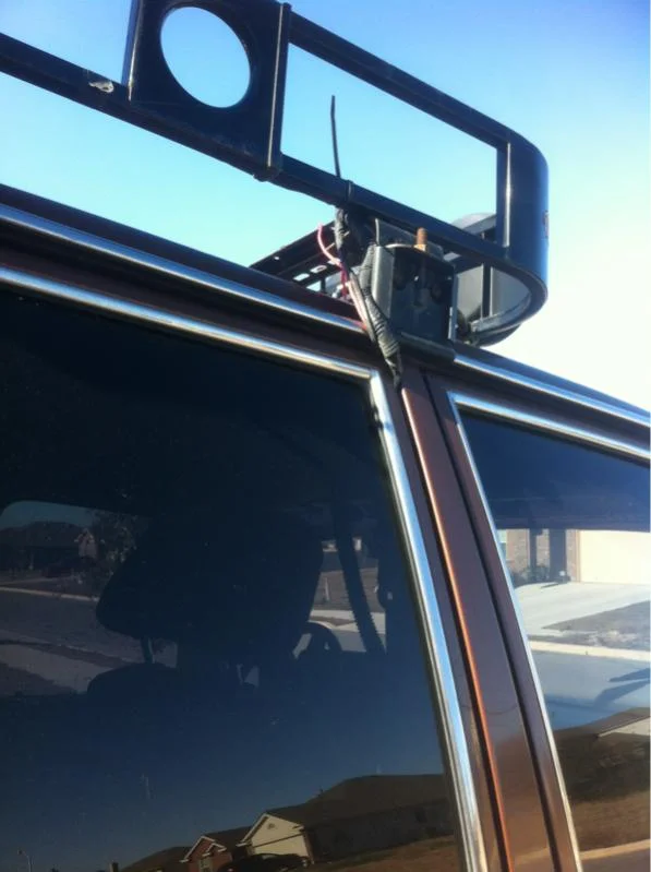

I just ran mine up the "b" piller on the passanger side and out the door looks ok...works just fine
Mines kinda ugly but has worked for years out the "B" piller and on the rackmount. My mount being there realy helped my placement. Also found every power wire needs its own ground for 100 watt lights, so every pair has one power and one growing wire.

Looks nice, how do you keep the wire from popping out of the gutter?
