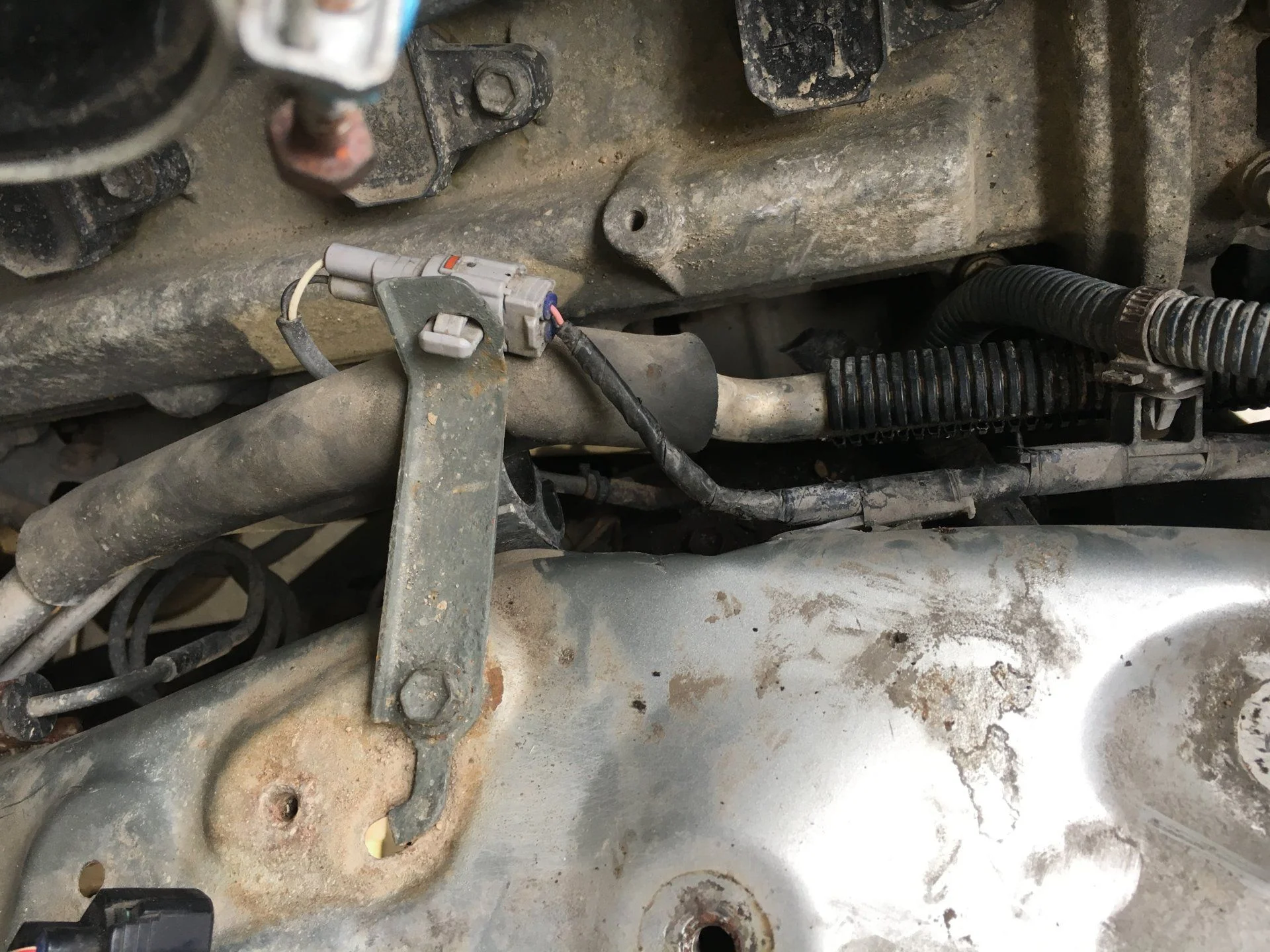

In my 2004 GX470 I accidentally pulled the two wires, the pink and blue? from their connector, ( I pushed them back into the connector but don’t trust that) passenger side under the air box, while installing new front coil overs. My question is, can I simply remove the quick disconnects and solder them to their corresponding pair? And does anyone know what they are connected too? Thanks

Is that your speed sensor wire? You can but if you pulled that hard watch for the Christmas tree on the dash. Might have stretched the wire internally.
When you pulled them out of the connector, did the terminal ends come with the wires or did they separate from the terminal ends? The terminals have a spring loaded catch that holds them in the plastic connector and are designed so that they can be removed using a small flat screw driver if needed.
