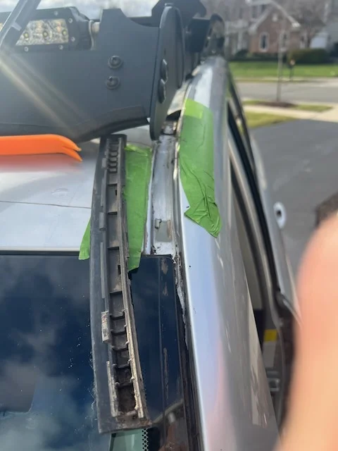

Knowing this, I figured it would be good to take apart and evaluate my routing options on my 2018 LC. Learned you need to remove the side moulding in engine bay and then remove wipers and the cowl. Did that, wasn't too bad. Getting the windshield moulding off without breaking clips took some effort and patience.
Good thread below by @2001LC which helped me avoid breaking any of the plastic clips.

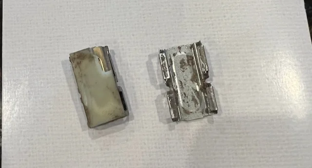

Started at the top with the 2 metal clips that are glued to the roof channel. The first metal clip came off. Managed to get it detached from the second metal clip but it later came separated from the roof - epoxy gave out.
Some observations:
Didn't realize there is a plastic section that sits in the roof channel that connects to the two metal clips that are glued to roof (mine came off). The rubber molding is on top and connects to this plastic section.

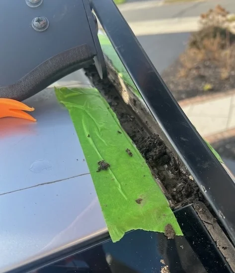

Could not believe how much gunk and mud were lodged in there. FWIW - I wash my truck often.

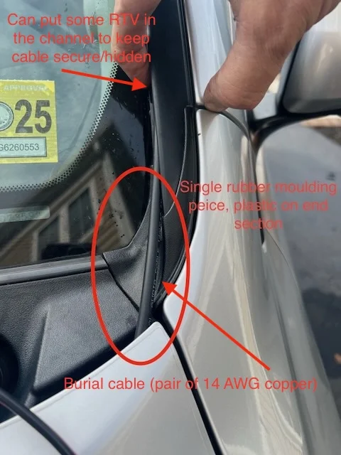

The long rubber moulding piece has plastic bonded to the lower portion to help funnel water to the drain in the cowl. I thought this was a separate part from the cowl and the windshield moulding but it's not. See below.
If I run wiring under this section, it will create a gap between cowl, molding and the windshield. I didn't get a picture with the moulding off showing the plastic clips, but there doesn't appear to be enough space/clearance to get the wiring under the rubber like others have done on earlier 200's. However, there is plenty of space in the channel to run up.
Trying to make this a cleaner install but not sure if that's possible. Same goes for the top section of the rubber moulding. No way to make a clean transition of the cable in the channel and underneath the top moulding section on roof. Will probably do like @grinchy and zip tie to the roof portion of the moulding strip. Curious how @Cruisin911 @CharlieS did theirs awhile back.
Rain was forecasted within the hour or two so bailed, put everything back together - minus the two metal clips that were glued to the roof. Looks like I can reuse them after cleaning up and removing epoxy / resin.

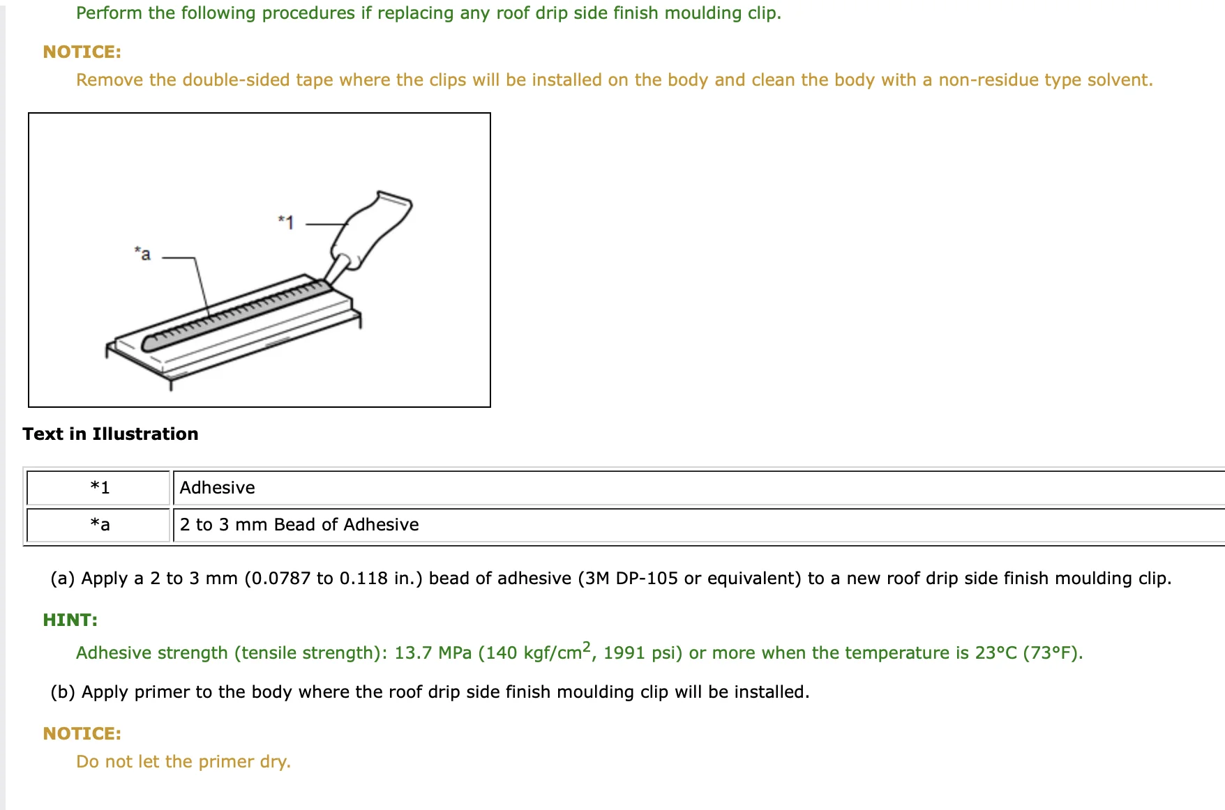

What's Toyota using to glue these down to the roof channel?
I used a general purpose adhesive called E6000 to glue down the upper clips that were inadvertently removed during disassembly.

I found it easy to run a two conductor (14 ga?) tinned marine wire up under the windshield side trim, but mine was a 2013. I haven't tried it on the 2016. This made for an easy roof mounted light bar.
Fwiw that lead is still up there and doing fine. It’s been a few years at this point. Moulding still down and zip ties still ok.
Edit - Found the adhesive part for these in FSM.

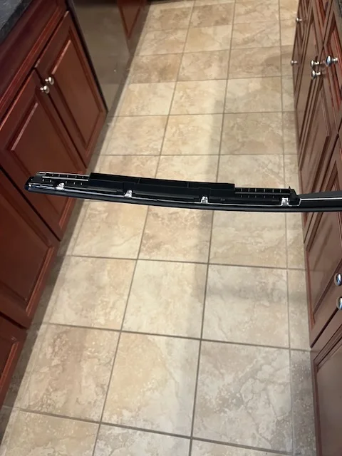

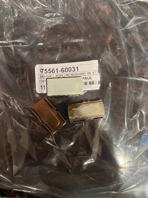

For those planning to remove or replace the windshield moulding, I'll pass on some additional info that I could not find online.
The top portion of the moulding has a hard plastic section that attaches to the rubber moulding with 4 metal tabs. This plastic section is what connects to the two metal clips that are glued to the roof. When I removed mine, this piece separated from the moulding (along with the 2 metal clips). I could not find any pics or reference to this. Online parts pics also don't quite show that level of detail. The bottom section is fused to another piece of softer rubber that meets upon against the cowl.
I went ahead and picked up a new moulding from the dealer today along with some metal clips. Now that I know how these pieces fit together, I'll repair the existing moulding top section. Waiting on the 3M epoxy to arrive (and probably warmer weather). Using duct tape for now on that top section to hold it down.
Pics of the parts:
Bottom section that meets up and connects with the cowl.
Top section below. Those 4 metal tabs hold the hard plastic section, it is what snaps in to the metal clips. Mine separated but will reattach by bending the tabs back on to it. This was a mystery part prior to getting a new one to look at.
Lastly, the plastic section snaps into these two clips below. They do come with some type of plastic on the back side. (It's not foam). You glue that side down to the roof with epoxy. Pic includes one that came off and missing some of the plastic/epoxy on back side. Part number also shown in photo.
