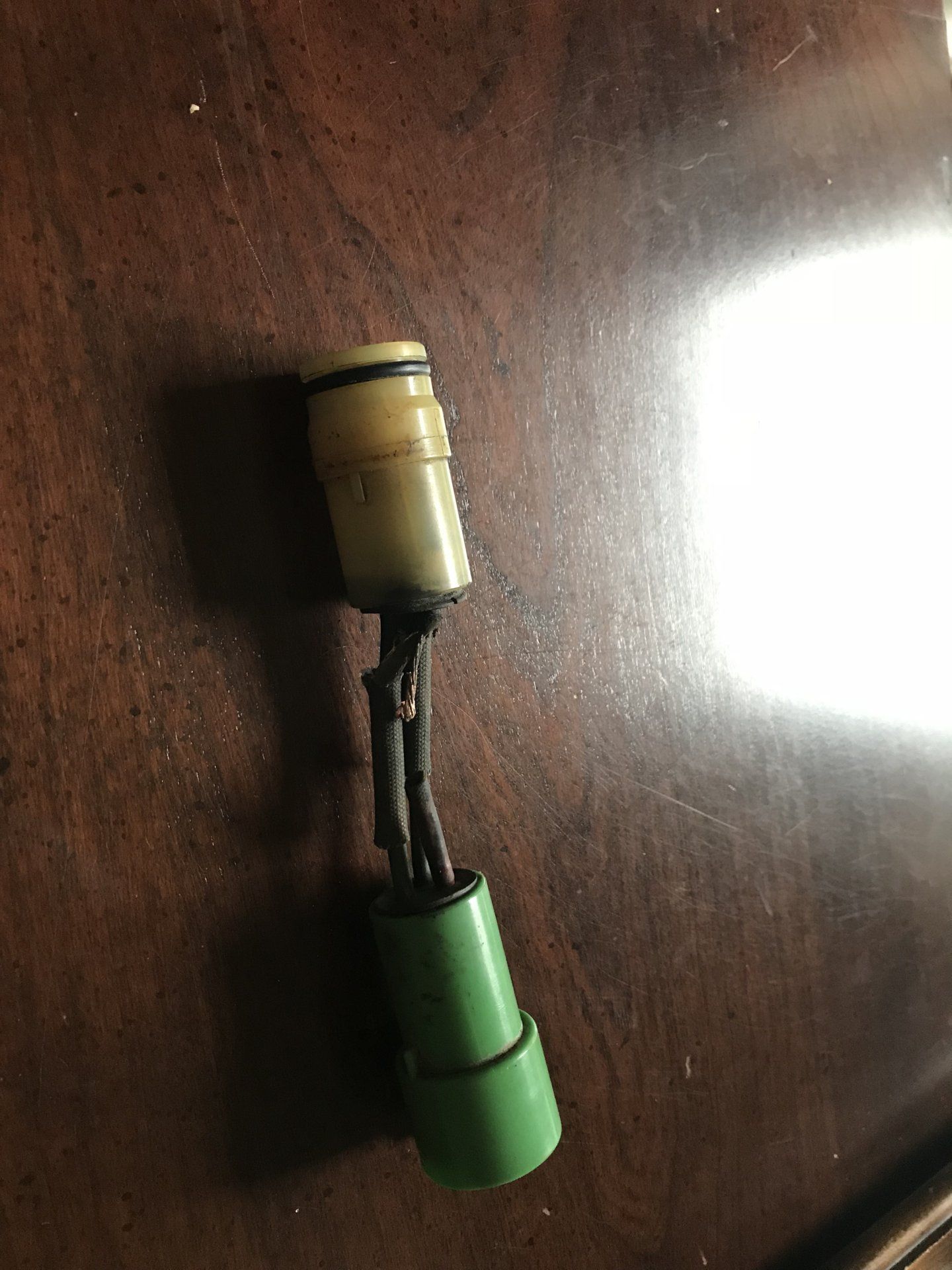

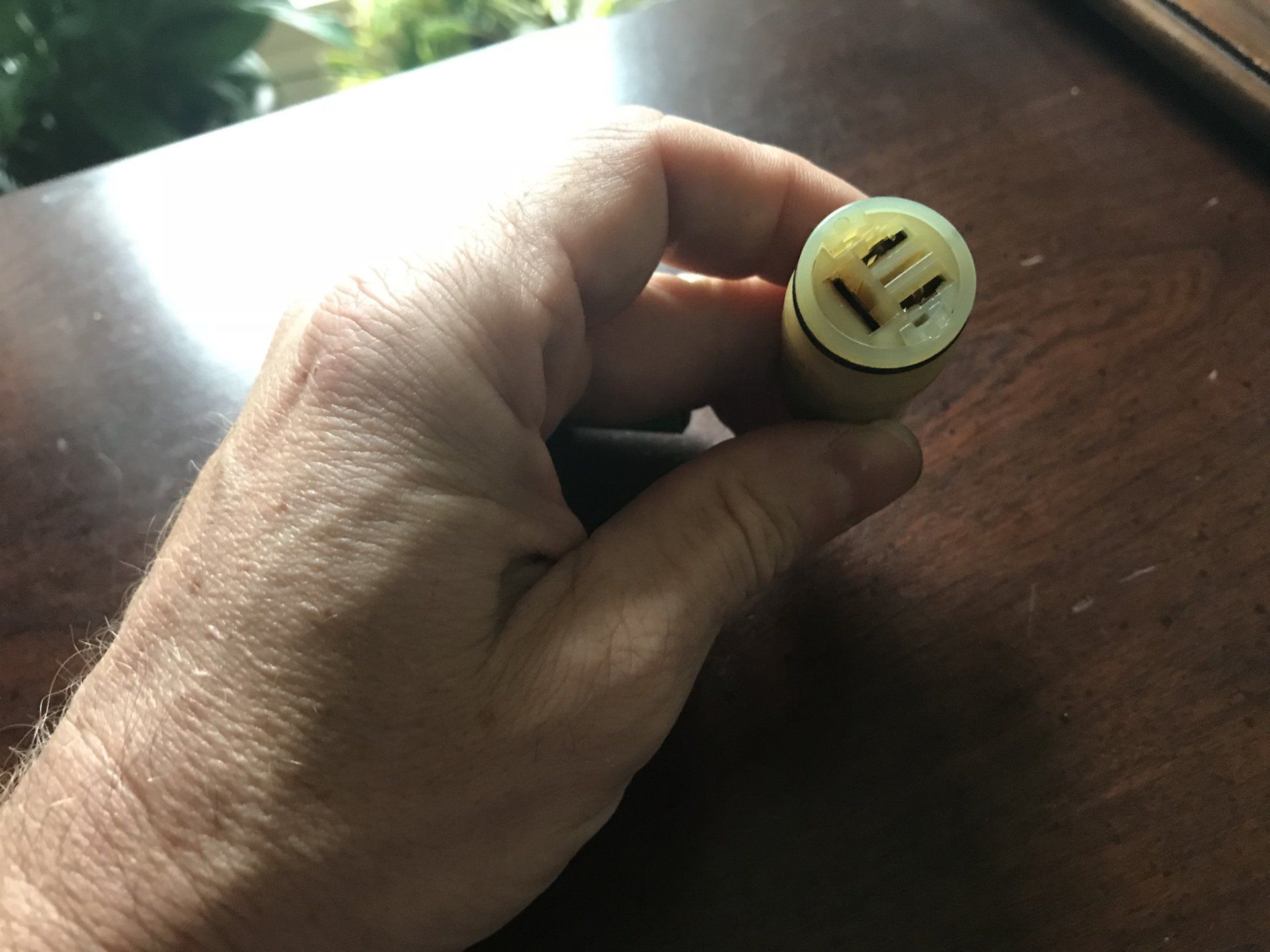

Has anybody seen one of these? It was between my Battery and alternator. Is it some sort of fancy fusible link? You can see it receives a 3 prong that is coming from a single 10 gauge wire out of the batter. It then splits into three wires (one if which is now blow) and then connects with the same 3 prong outlet to the three wires in the hose going to the alternator.

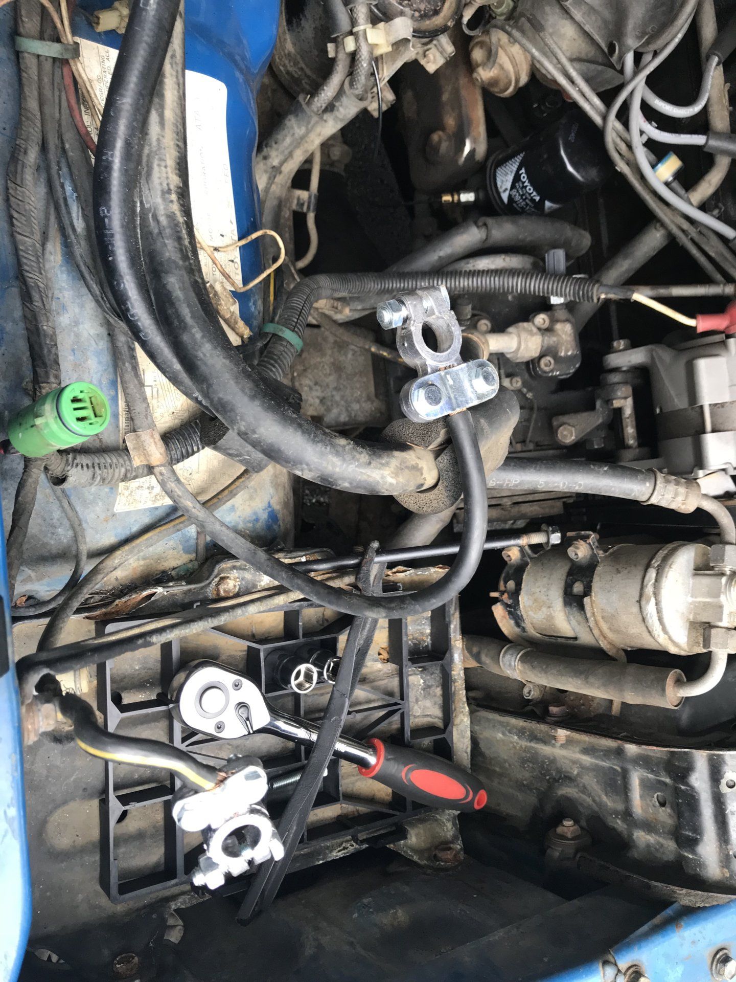

I blew it on a misplaced jumper cable. Dumb, I know. Now I need to rewire. I can't find this part, so I'm thinking just add a fusible link and connect the original three prong to the receiver on the other end that splits into the three wires going towards the alternator.
Thanks for any help identifying and/or advice moving forward.
Yes. Fusible Link. A weekly question here in the 60 section. Lots of info with a search. Here's one from the FAQ section:

You can buy small pieces of the CORRECT GAUGE FL wire on ebay and amazon, though it's hard to find it in matching OE color.

contact @Coolerman he make new ones and has them for sale
Oh, yeah, forgot about Coolerman --- (since these are NLA from Toyota)
Under the 'Fusible Link' section: Cruiser Wiring
