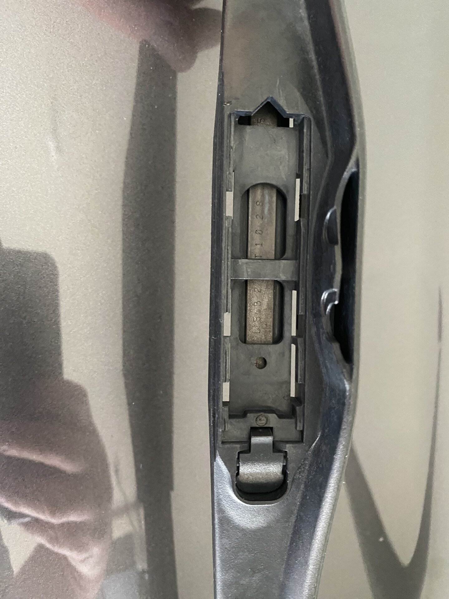

I guess I’m dummer than a windshield wiper. I’ve searched high and low but short of breaking adapter I have no idea how to remove this adapter from J hook nor do I know brand of wiper. I can easily remove blade from adapter but not the adapter from j hook. Attached are some photos. Any suggestions greatly appreciated!
Your fourth picture is a bit too dark to tell for sure, but usually there is a tab there to pull back and it’ll slip off.
The other common method is to have tabs that catch the outside of the curved section of the arm, and when the wiper is in-line as it sits on the windshield, those tabs cannot move outward. Rotate the wiper 90 degrees and they are uncovered and can bend outward to clear the curve. I don’t see that on this model though.

Did you get it off? On the last photo, you can see the little tabs sticking up just above the top of the j hook. At 90 degrees, those should be accessible to move to release the bottom of those tabs holding the inside of the j hook. Or so I think.
Thank you, I’ll report back the results.

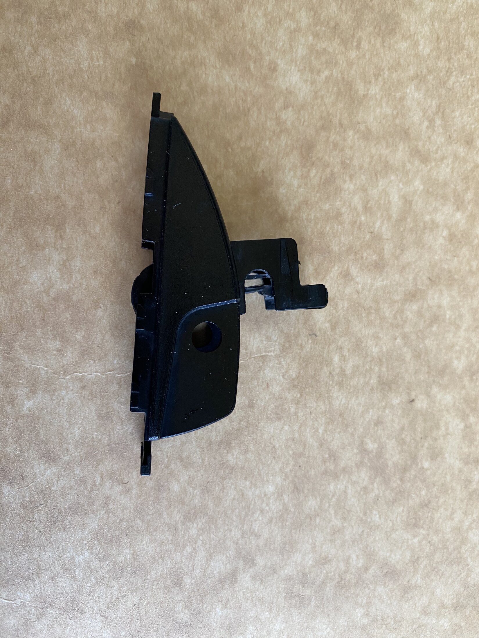

I finally got back to this "project". Fortunately, the old ones got me through a couple of storms. Anyway attached is the little booger that had me hung up. Not sure what I did except push and lift every tab-like piece on the adapter. Wish I would've know better about the Sightlines but I went off dealer parts shop recommendation. I run them for now and switch back to OEM. Thanks!
