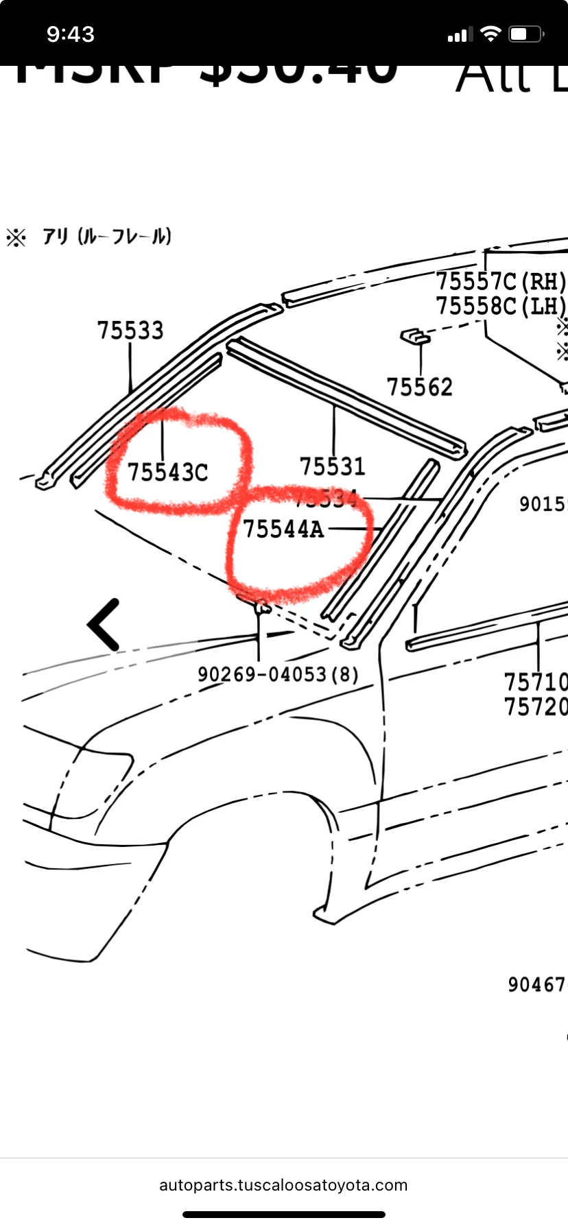

What’s the function of the left and right side rubber molding that fit where the windshield meets the A-pillar? I’m talking about these:
They seem to cover the windshield surround rivets, but is that it? Cosmetic only? Or do they serve some functional purpose?
My passenger side one is missing and the driver side is mangled. Trying to figure out if it’s worth $60 for a new pair.
