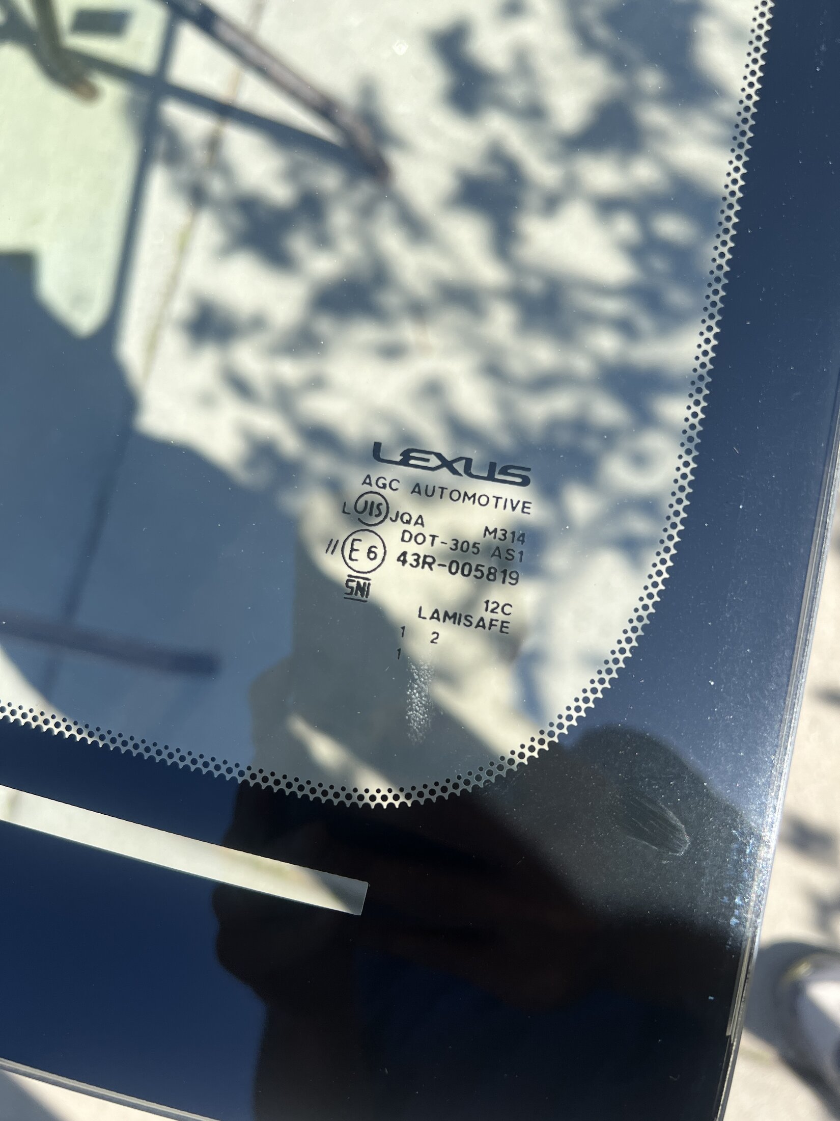

I use Travelers for insurance. So if you do and you need a windshield, it’s worth asking! Even the Lexus glass is made in Indonesia now, but it’s AGC and matches the rest of the truck again.
Strange. I had mine replaced last year. This was my windshield . Made in japan. Did your have the bronze tint?

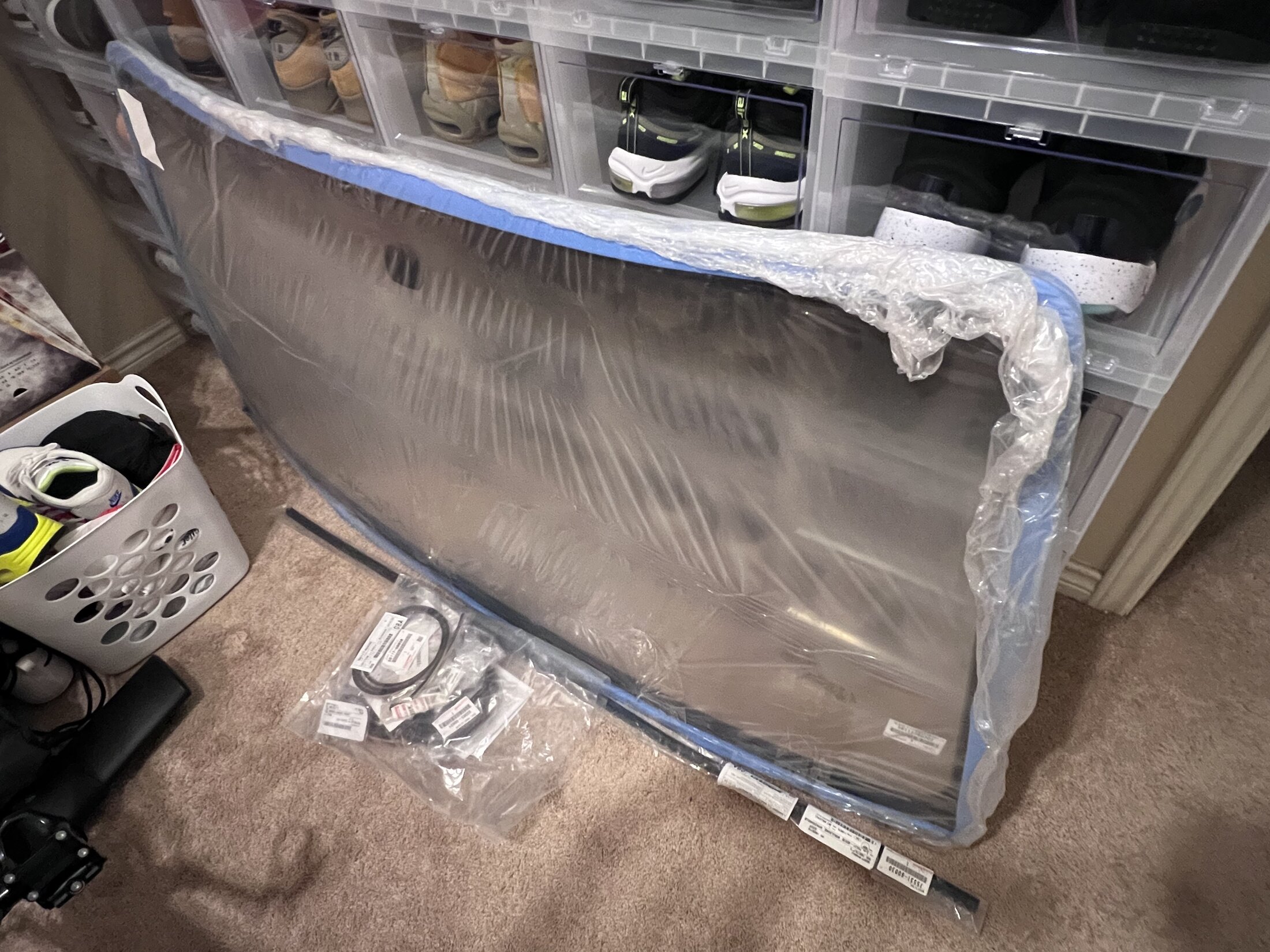

Just picked up my glass (bronze tint) and all the rubber pieces, clips, and rivets. Got everything from Park Place Lexus for $970 after tax. Only thing I didn’t get were the outer trim pieces that go from the bottom of the windshield to the roof. Couldn’t bring myself to pay $200 each. Mine are still in really good shape anyway. Found a local shop that’ll come to my house and install for $280. They do a lot of the Toyota dealerships around here and are familiar with the install. Cannot wait to get this done!

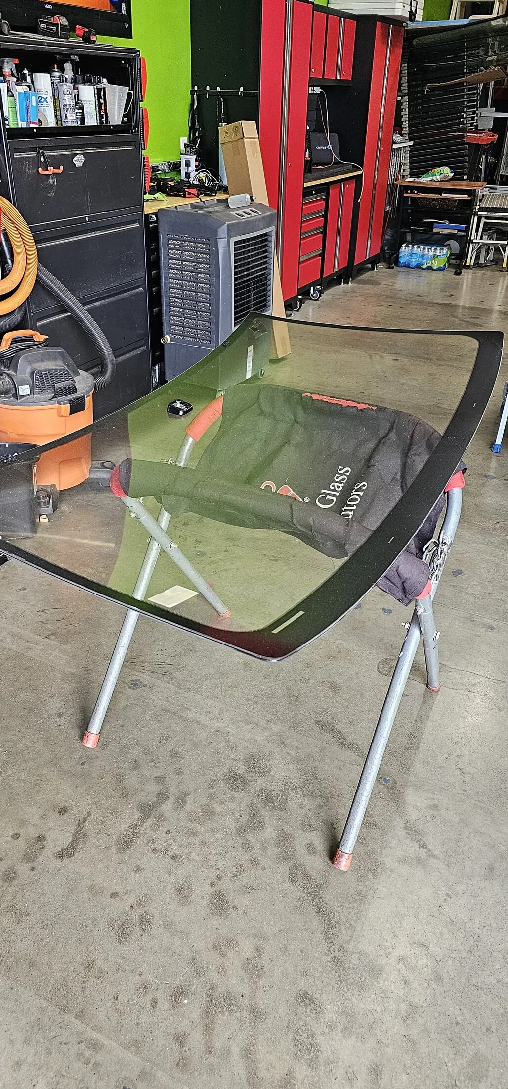

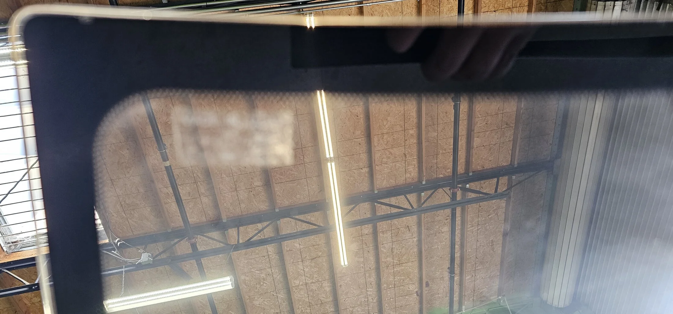

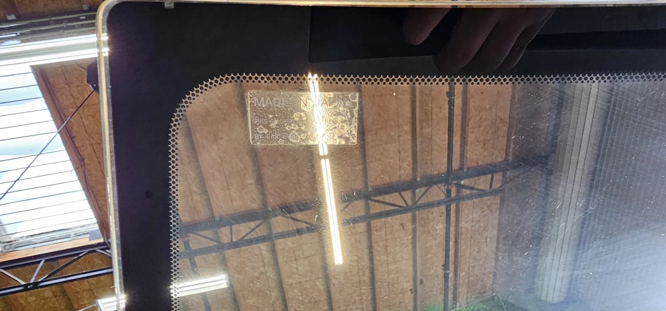

Had this done past year by the shop in the first video. They did a great job. One thing however. He found the oem rivets to be too small and had to much play. Luckily he had extras and those for give and snug to hold the side trim.View attachment 3693897View attachment 3693898View attachment 3693899 give and snug to hold the side trim.
