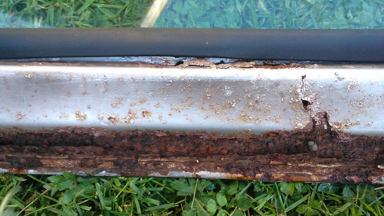

rust along the bottom of the fold down windshield frame is caused by sweating. they rust from the inside out.

Wayne's right about the condensation but I learned from experience that it slows way down once your airconditioning stops working. I was wondering why my BJ74 frame is still fairly solid when other, better treated BJ74s are rusty. My ac compressor belt was missing when the rig arrived in Vancouver in 2005 and hasn't been replaced.

Some more pictures of the old frame. The top-most 4/5 of the frame was completely rust-free, both inside and outside. The bottom was another story altogether. Picture 1143 shows the rust that was even accumulating under and near the window frame gasket. It was physically pushing the gasket up and it was visible from the driver's position.
