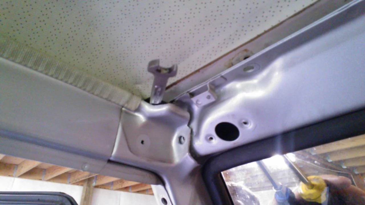

AHA! Many thanks I was able to get those out with the roof in place....I used a 10mm gear wrench....Was able to coax enough room to remove each bolt (1 per upper corner coming down from the top) without removing the roof.....

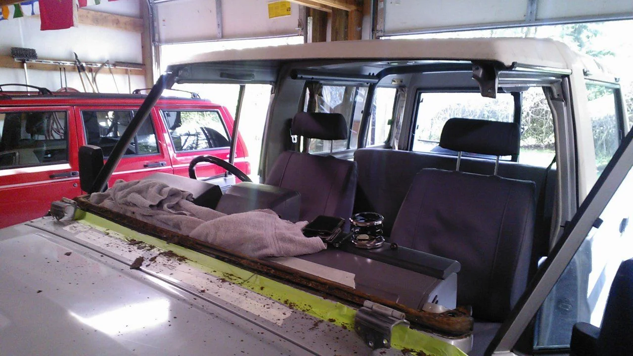

removed (to clean up) the seal/weather strip below the windshield frame....A wee bit of rust under that seal as well....Maybe I'll remove the old windshield from the frame and see what's hiding below the seal??? and see what's hiding under the seal....Photo of cowel?/bulkhead?/body? rust near windshield frame hinge (similar on each side in the same area.....

Naturally, minutes after I removed the windshield frame, a 5 minute deluge rain shower came through and I had to scramble to push (no Batts - another story) the rig into the garage.....

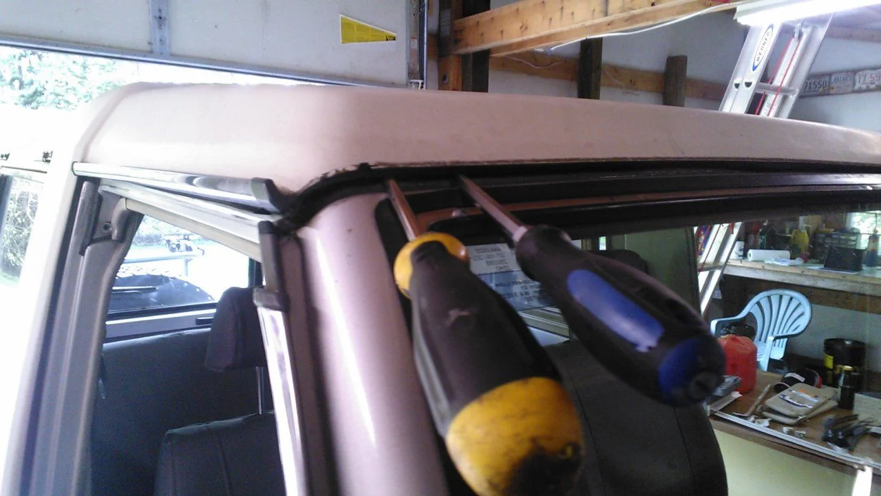

Recently took off my window frame from my 1985 BJ73 and thought I'd add to this thread while it was fresh in my mind.

9. Now the tricky part. Finally, there are two hidden 10 mm bolts on each side of the window frame. They're accessible from the inside, but someone is going to have to help you by applying upward pressure to the FRP top from the outside. We used two large screwdrivers. Since I had cut away the seal the screwdrivers easily lifted the top about 1" to 1.5" inches, which is all you need to get to the bolts. You might want to use a flat bar instead, which will create less direct pressure to the fibreglass than the screwdrivers did. No matter what you use, be careful not to lift the top too much. Only as much as you need to to get to the bolt heads. A ratcheting 10 mm wrench is helpful here.

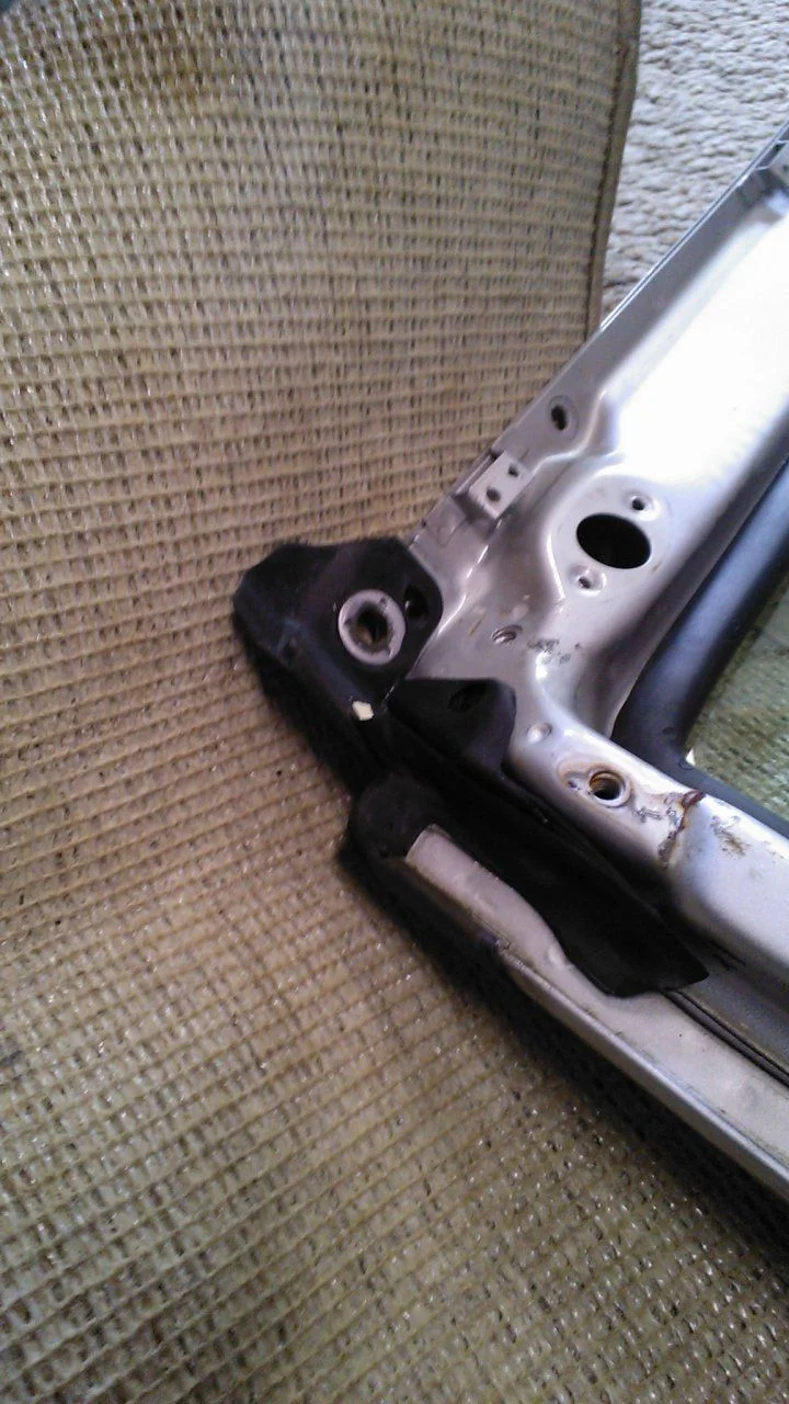

11. Once the window is out, look at the condition of the top seals on the old window frame. They may be reusable. If not, Cruiserparts.net sells them and calls them "roof side rail seals". Don't forget the three (x2) black plastic rivets.

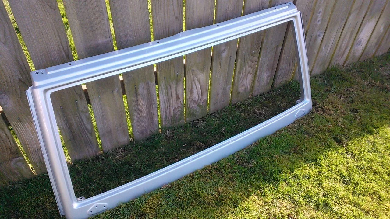

15. Previously I struggled to think of where water was leaking into the frame but looking at the new frame I can see where it could weep inside from the outside. I sealed up the (~2 feet) top-to-bottom rain gutter which is comprised of ~10 spot welds (x2) but which has open slits between the welds. At the time of this writing I haven't received the window back from the glass shop but when I do I'm going to continue inspecting it for areas in which water could get inside and seal it up before putting it back into the truck in the reverse order of wheat was listed here.

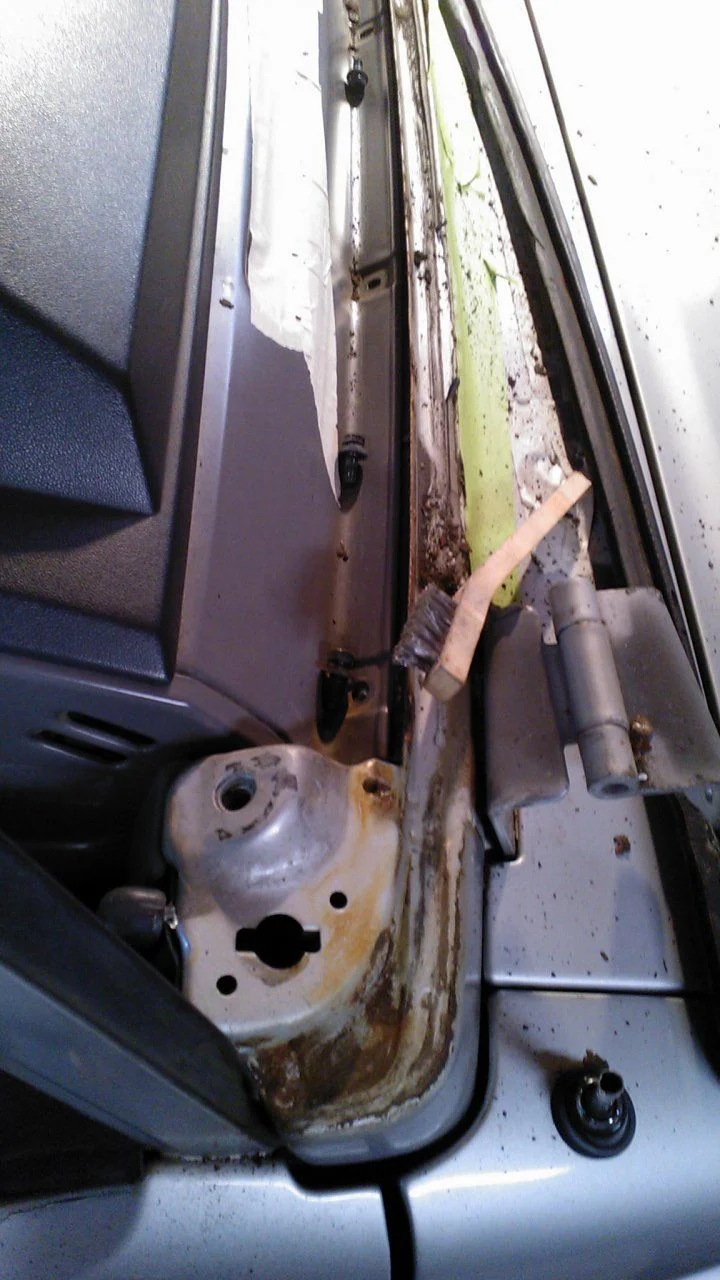

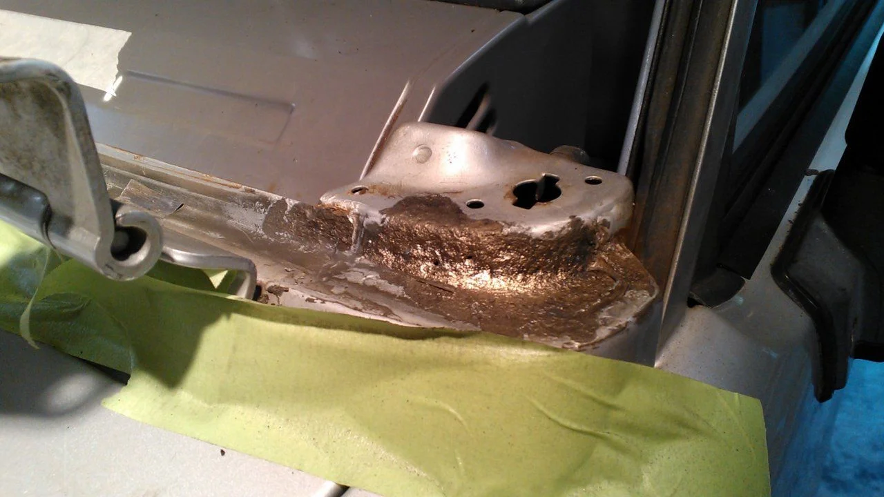

I am going to keep the "main" bottom seal though - it's in good condition. I completely removed it to have a better look at the condition of the truck itself. Rust was starting to gather under each corner at the pillar-posts, or whatever those areas are called. I think things are ok but I'd like to know what others think. I included a photo of each corner after I chipped away all the rust (that I could see and get to) and lightly wire-wheeled the area a bit. The passenger side was clean. The driver's had the most rust.

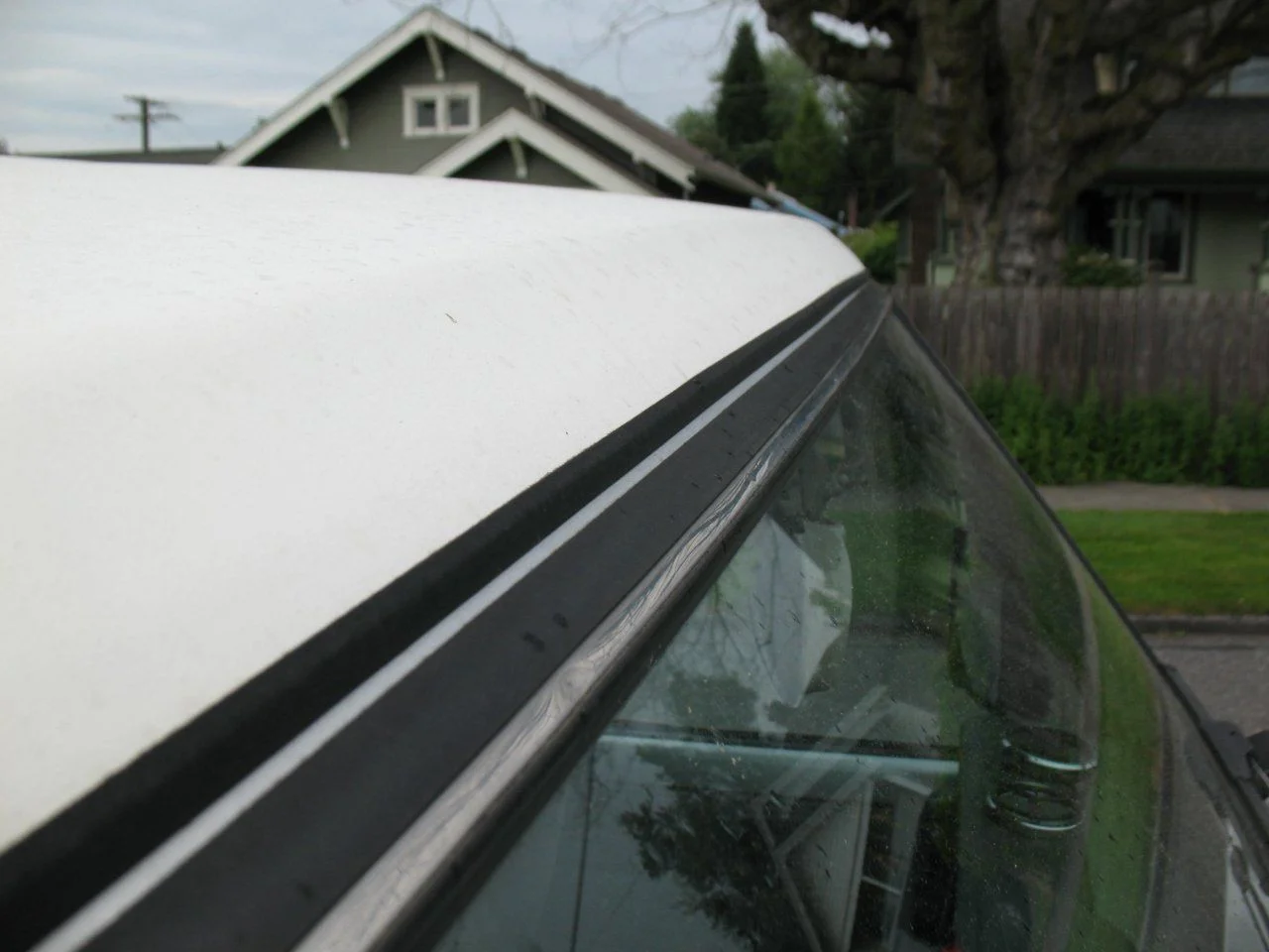

I peeled off the top weatherstrip. The old weatherstrip (picture 2742) was actually pinched quite tightly between the FRP roof and the frame. To me, it's more than a weatherstrip, it's a gasket that "creates" a weatherstrip when pinched in tightly/correctly. Getting it back into that condition is critical to keeping things dry. The new weatherstrip is spongy, but it arrives as a diamond shape in cross-section with adhesive on one of the four sides. The old gasket/weatherstrip was more of a T-shaped gasket. I want to get it right because the old frame had no evidence of water/rust in the top half of the frame at all. I think when the time comes I'll go all CSI and cut the old frame apart and look inside.
