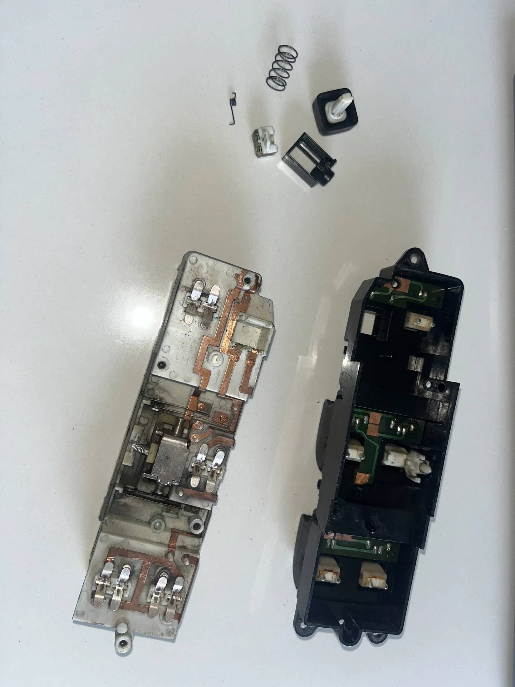

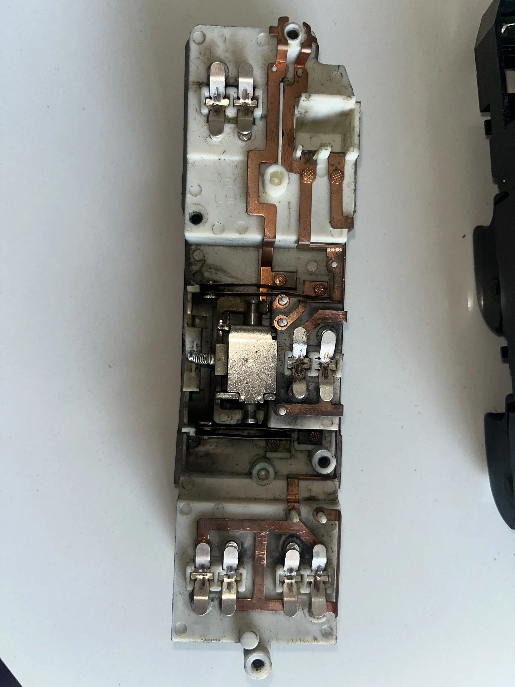

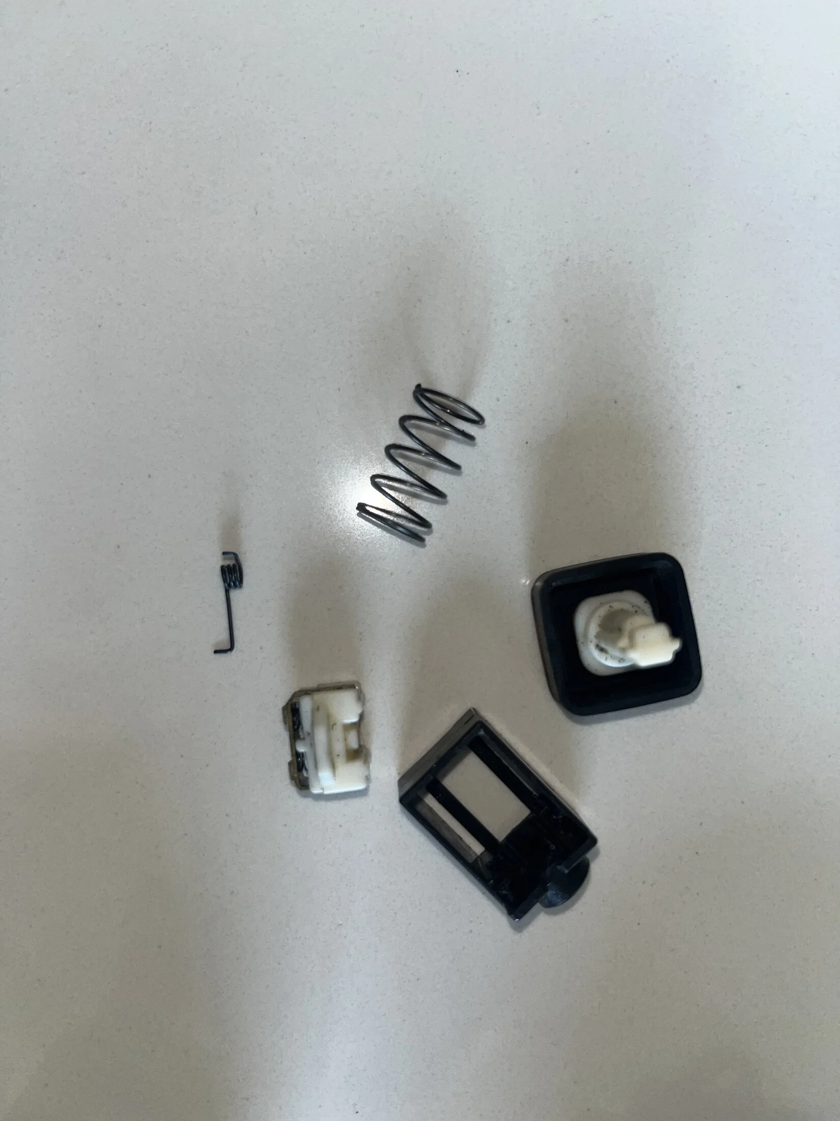

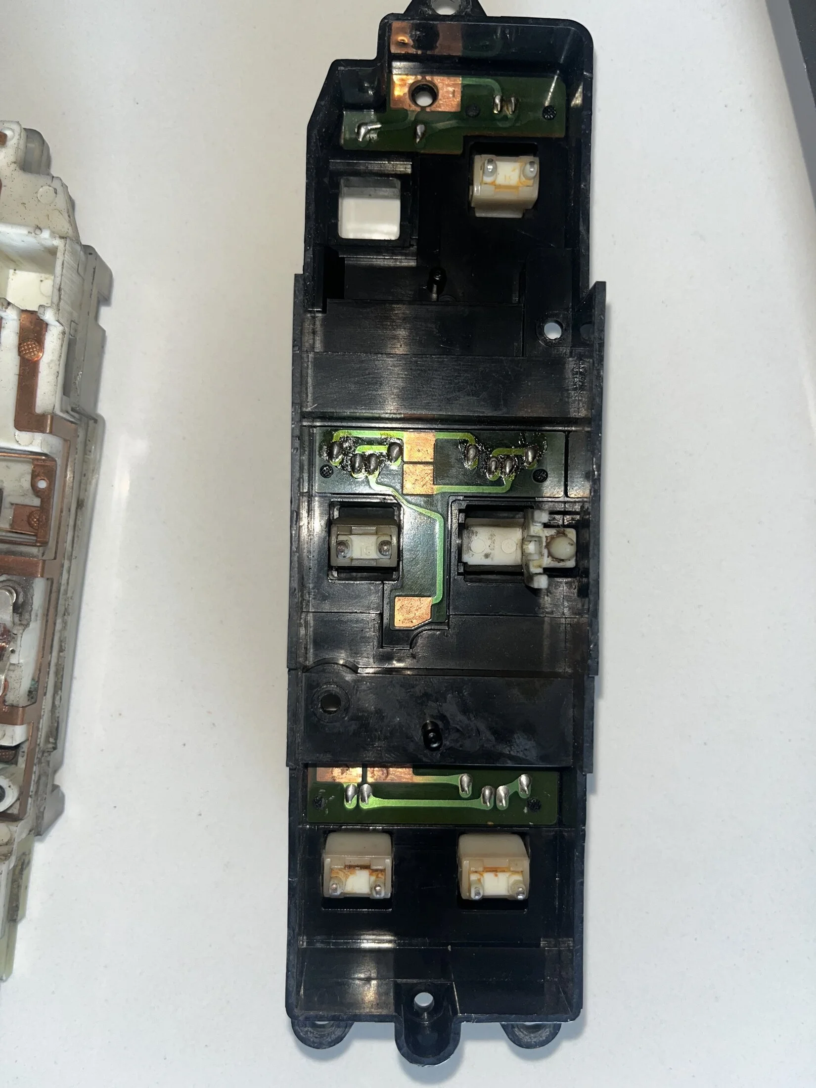

Hello, my window control panel stopped working properly, specifically the driver-side window, I took it apart to try and see why the switch wasn't working, when all the other were, in the process of doing so I didn't notice that the window lock button came apart, and I haven't been able to put it back together since I didn't take a good look at it before it got disassembled accidentally, however, that is not my main issue, the thing is I put It apart, and don't know if anything is wrong with it, when I put it back together without the window lock switch none of the other window switches worked and when I clicked the lock door button it locked and unlocked immediately.
I appreciate any help.
The window circuits all run through the driver's door circuit; lose that one and you lose them all.
Search this forum (use Google) for window up mod. There will be photos in there.
I orderd a new one im just waiting for it to arrive, thanks!
