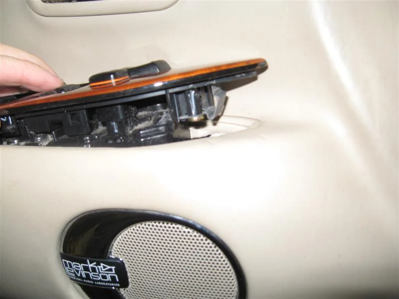

My 2006 has a trim piece that won't behave - left alone, it's going to make a break for it. Every time I get out of the truck, I pop it back down.
So in addition to the panel seeming flimsy and cheap, now it won't stay put. What are my options here? Is this panel available without the buttons? Or is it one of those "Hey, this'll save our techs 20 min. and we can pass the cost to the customer" parts?

Id pull the door panel or try and lift out the part to see whats pushing it up or see why its not staying down. If the clip is broken you may be able to fix it so it stays down.
Have you pulled the switch and tried to see if anything is bent? It looks like the clip on the front is not catching the lip.

Haven't pulled the door panel. My logic is this - I currently have one possible broken clip (pictured). To inspect this, I'll have to remove several clips (door panel) and will likely break one of those. So, I want to better understand what I'll ultimately be replacing when I start replacing clips. I'm still not convinced that door panels were ever intended to be removable ;)
You don't have to remove the panel. Just lever the trim piece up from the front end. I have done that, and you will see the two clips. There is quite a space under it, so nothing should be pushing it up.

The window switch has a fixed plastic claw on the back end that seats under the arm rest. It has a metal spring clip on the front of the switch that holds the panel in place on the front end. Looks like that clip has either been bent rearward too far or is broken. A temp fix would be a little interior trim adhesive under the front of the switch; the permanent fix would be a new switch.:mad:

This I can help with - as others have said, the issue is the front side clip of the trim piece - probably. The other possibility is that the inner door panel (maybe not the correct term but the huge interior door piece) has separated from the metal ring that supports that window switch assembly. So if you take off the door panel - 15 minutes max even if you're a rookie like me - you'll know in like 2 seconds if this ring is still attached. Mine was separately and I used JB weld to reattach - problem solved.
