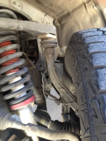

ok....complete forum newb...accidently posted pic in 200 series photo album. trying to move it to this post.
I found a set of near new Falken wildpeak 305/65 tires on Craigslist. wasn't the exact size i was looking for, but a deal i couldnt pass up.
I had installed the lift (on a tundra) and it looked silly with the stockers under it. I went with 3/1 levelling kit and SPC upper control arms, again from craigslist, off a guy that went to 6" lift. The tire shop couldnt get the wheels on the spindles with the tires mounted, so i had to roll stockers until i could get spacers off ebay. The ones I found were 32mm. I dont plan on off-roading my truck ( I have a Scout for that) so I wasnt as concerned about running the spacers. With 380 hp. on tap, I do drive it like a sports car and haven't seen any adverse affects of using the spacers. hope the info helps...now how to get that photo were it needs to be..... 068.webp
On the Tundra, with the spacer and stock wheels. the tire well clears the UCA, and only rubs in reverse full lock to the side.
