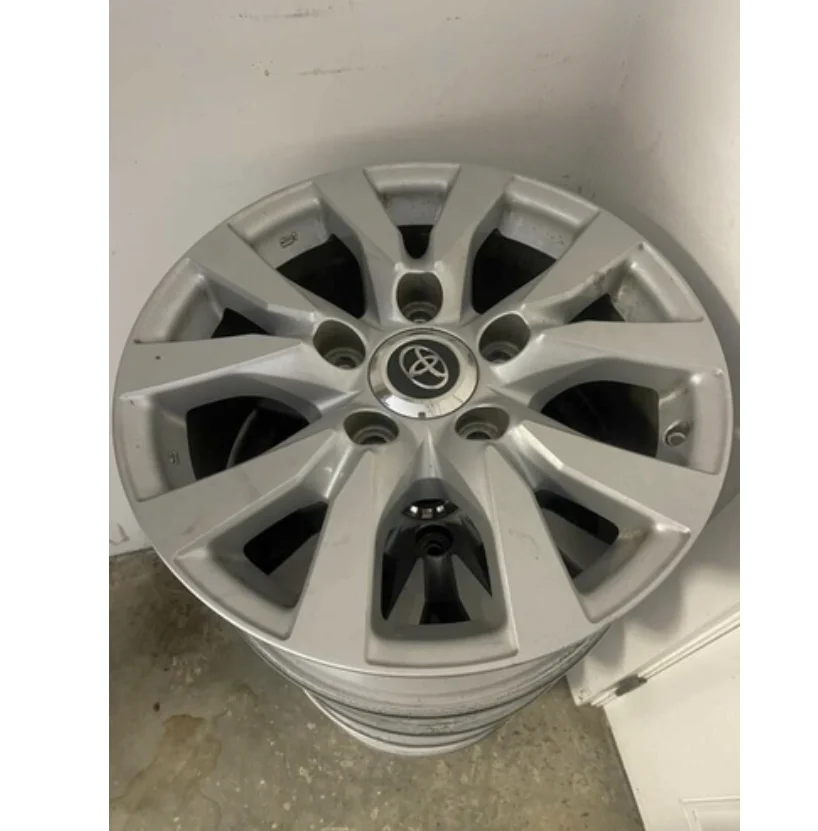

Looking to put dedicated snow tires/wheels on my 100. I found OEM 2019 200 series slightly used wheels for a low price. Will they fit on my 100 (OME lift)?
Those wheels will fit without the front wheel center cover as you saw from the 200 series/Tundra thread.
A 1.25” spacers will allow the fronts to clear and use center cover.
Although they both have the same bolt pattern 5x150, the 200 series wheels are not 100% compatible with a Land Cruiser 100 - it’s because the front hub of the 100 series has a bigger center bore requirement (due to the flange design). So like what @OliveTheLX said, you must use a wheel spacer to successfully fit a wheel off of a 200 series to the front of a 100 series. The rear is plug and play, 100 = 200 series.
