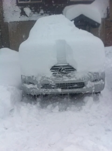

Planning to get dedicated snow tires, got more than 5 feet of snow
over the weekend. The LX handled great, but I didn't like the fact
the skid control came on a few times.
