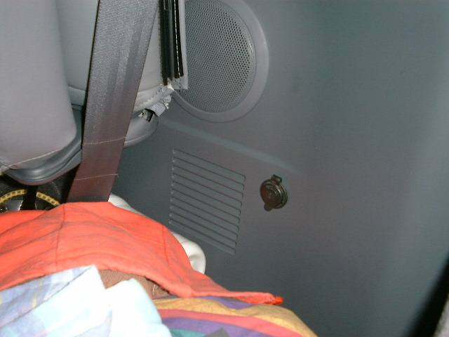

Old install picture:
I installed an extra outlet in the rear (I had 1 already and had intelligently run 2 8 gauge wires at the time...). I also installed 3 of them in the bottom rear of the center console, rear facing, for all those 'toys' we need to power. They are all fused in the engine bay and run from the aux battery. I should have taken pics when doing the install, turned out very neat & tidy.
Anyhow, the digikey part number is AS212-ND $2.70 each in quantity 10... They also have the 'plug' as well. Get your order over $25 and there's no $5 handling fee (just shipping) and for most it will be tax free.
george.
