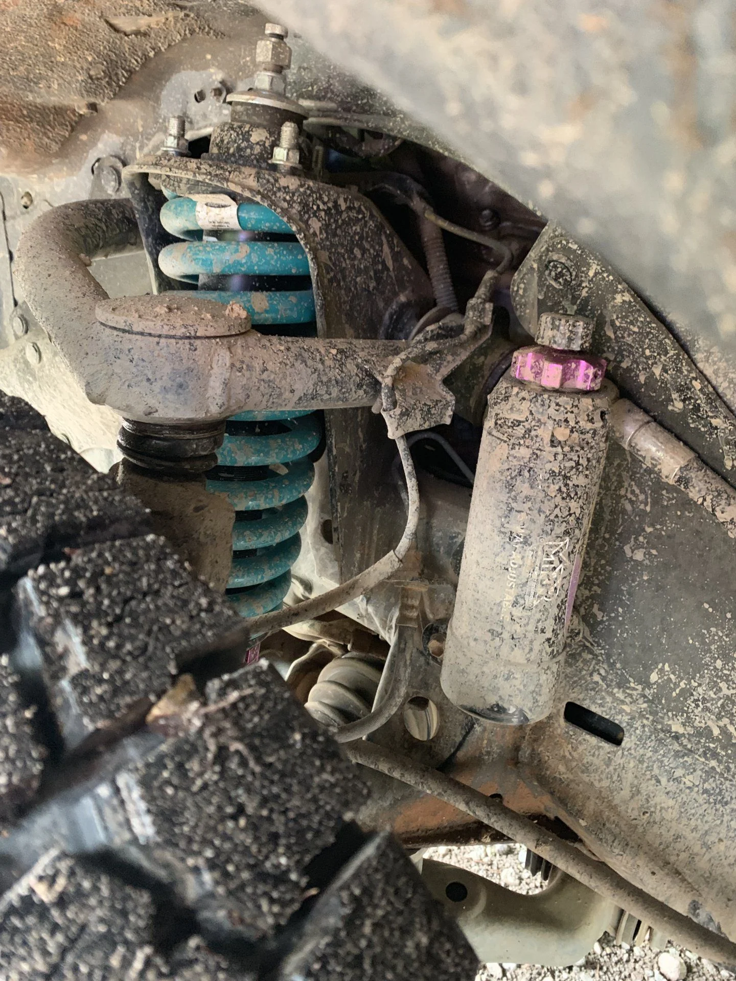

Talk to Kyle Fogle at Treaty Oak Offroad. Dobinsons has 3-way adjustable shocks for the GX that have just hit the market. MRAs.
That being said, the OME BP-51s also have 2-way adjustment (rebound and damper). But they will be more expensive than the Dobinsons, and you won't get the same level of customer service that Kyle will give you.

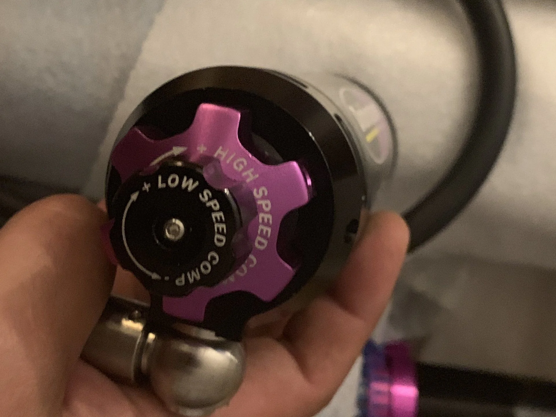

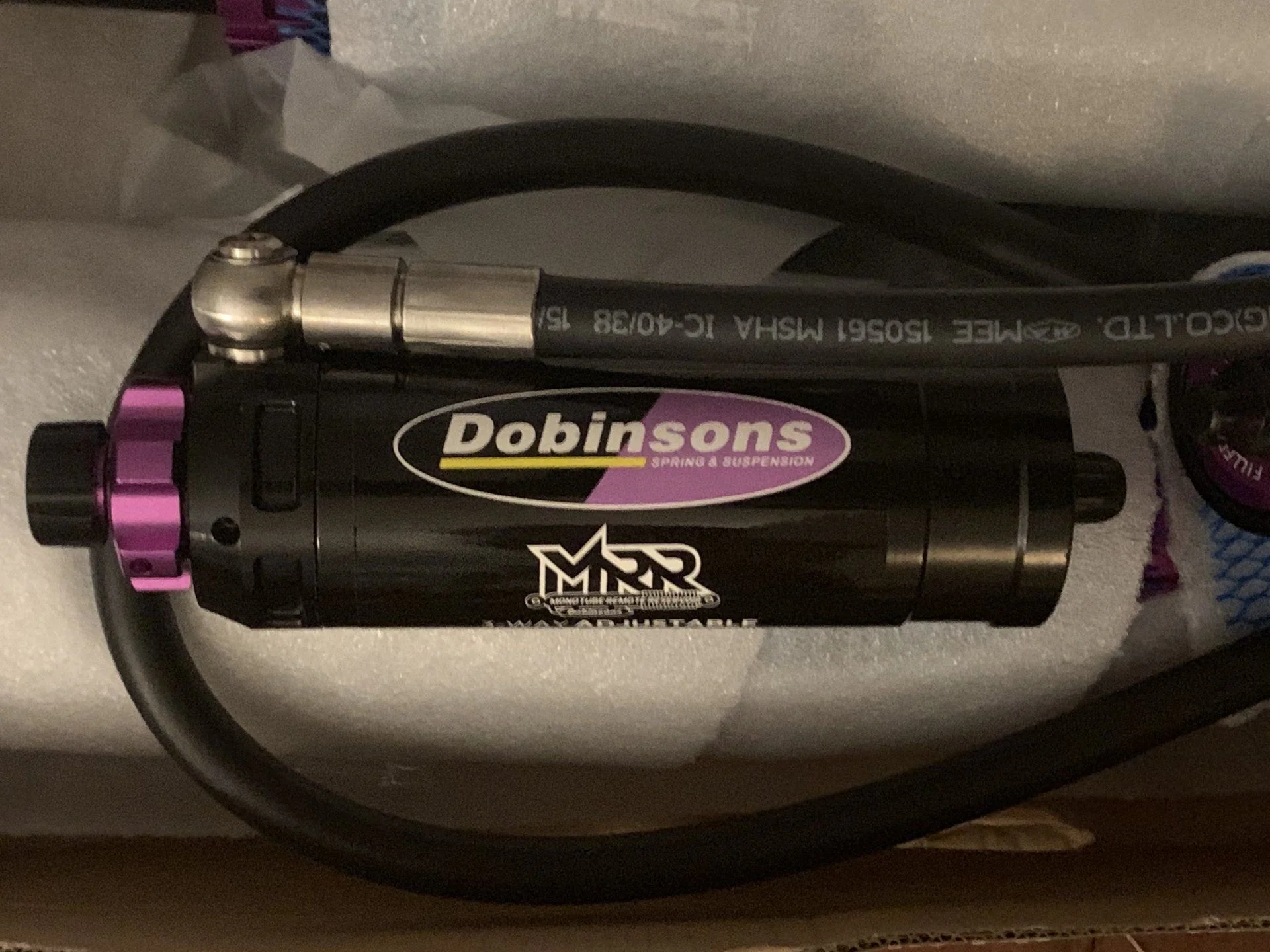

Sooooooo the MRA is coming, hoping for a fall release. These bad boys have 3 way adjusters! High speed and low speed compression, and rebound adjustment.
I have a preproduction set installed on my GX470, had them for a little over a month...and theyyyy are pretty damn impressive.
They’ll be in the $2400 range. Keep an eye on my website and social media, I’ll be VERY loud when they’re ready to preorder.

steel shock body, aluminum reservoir
chrome shaft
56mm diameter body for 120/150
66mm diameter body for 80/100/200
aluminum piston
all natural rubber bushes
vehicle specific brackets are in the works
chrome shaft
aluminum piston
