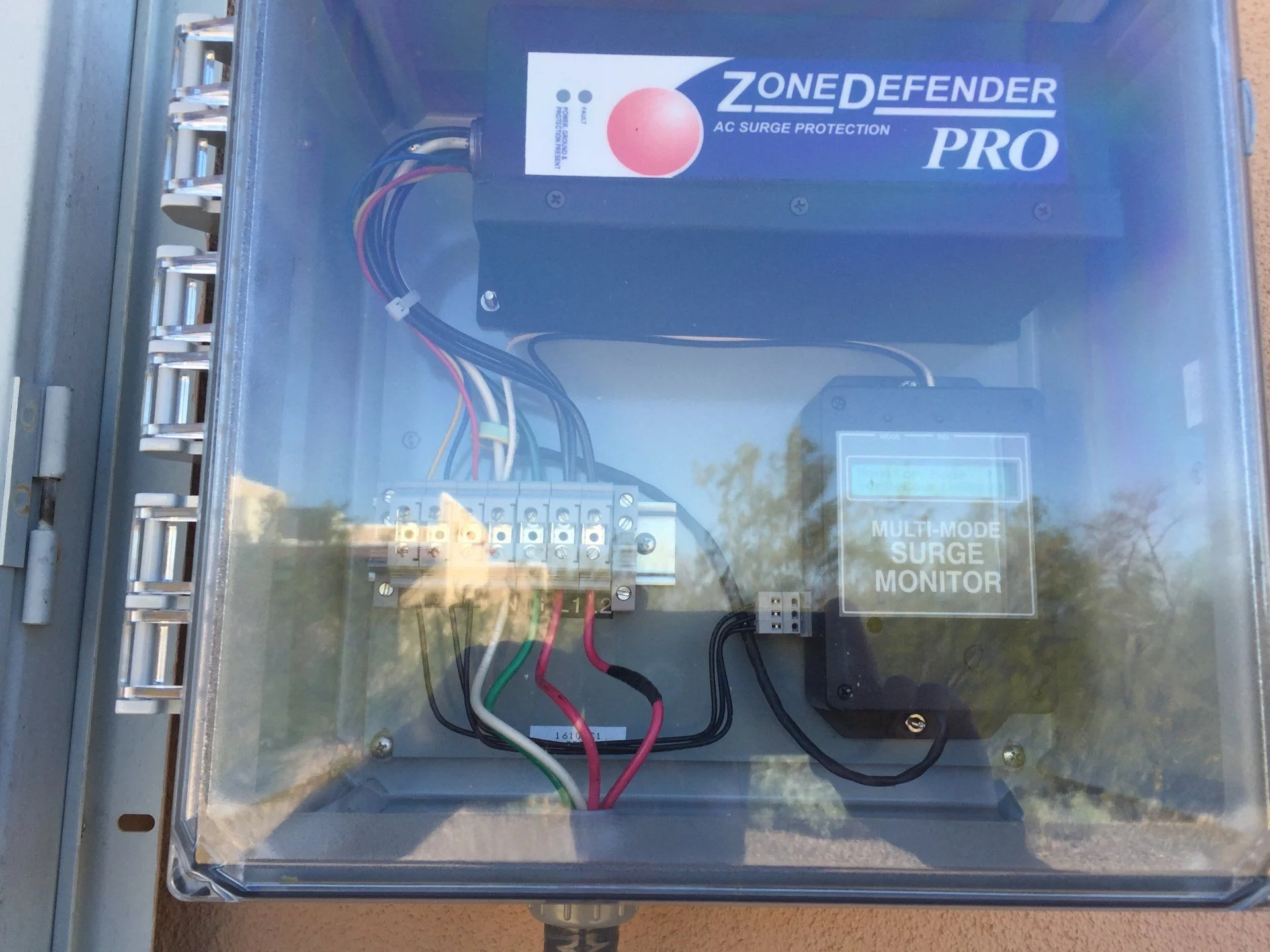

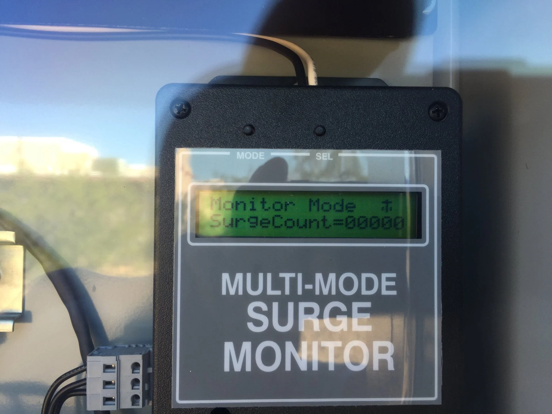

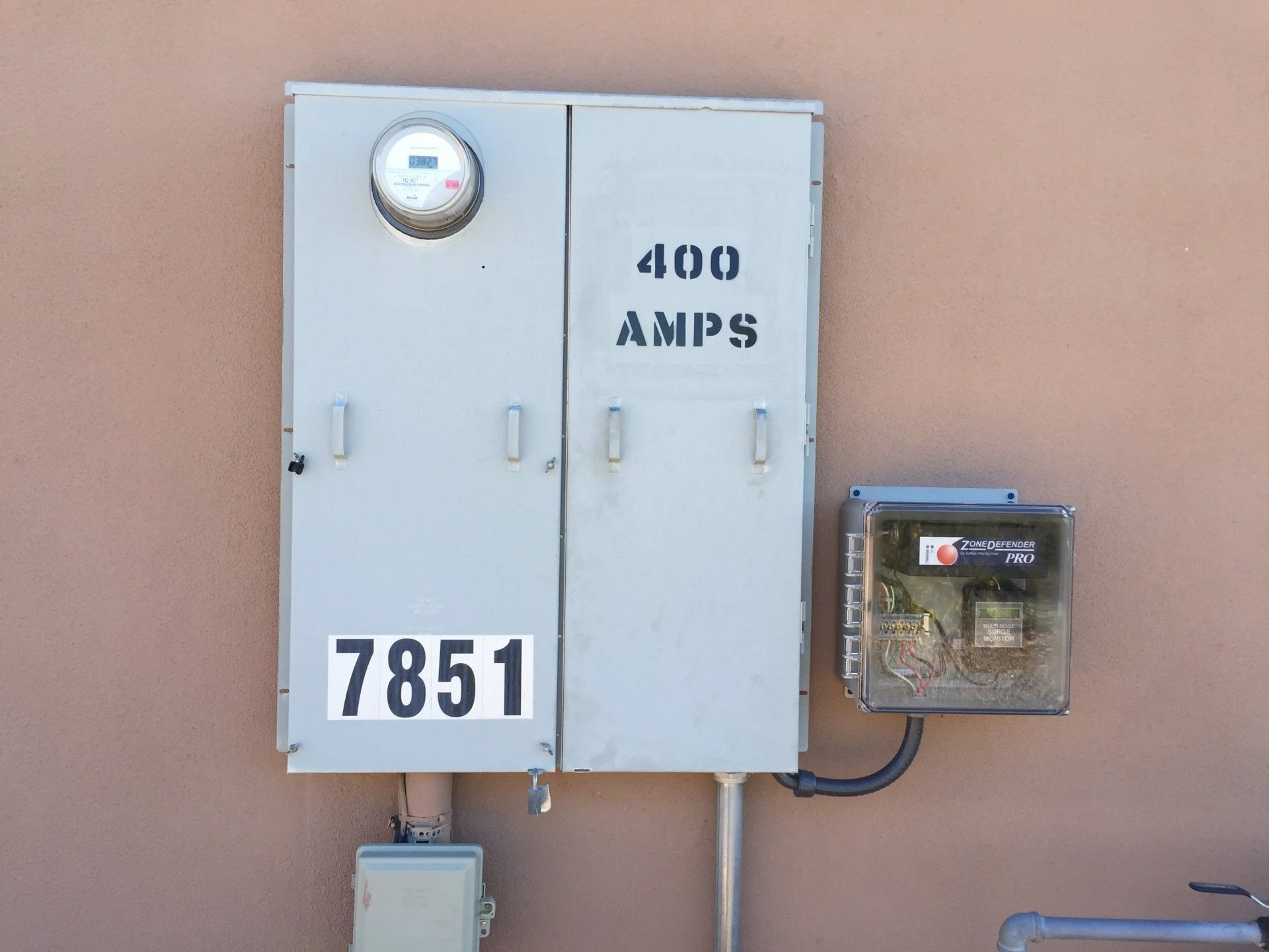

I used a Zone Defender with strike counter. These are use more in commercial settings but works well for house and shop. I paid $250 for the setup including enclosure.
Simple installation.
