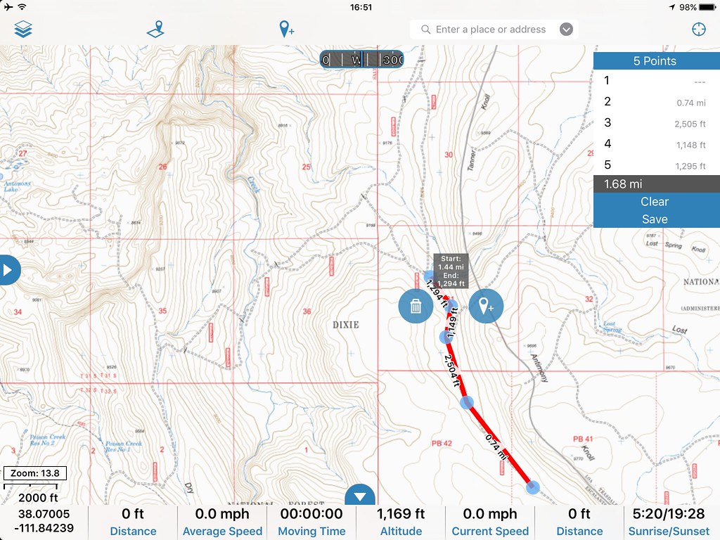

Here's an example where I was drawing a route. I could easily zoom down to 200ft. USFS Raster

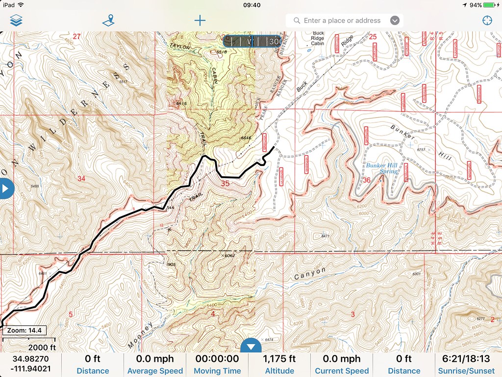

I just think they are the cleanest and easiest to read. I can easily write down all of the FR names/#'s for reference and there is good POI information in them. If I can get the MVUM stuff to work, and I have been pretty successful with AZ so far, that will be another good layer. The problem with some of the MVUM maps is they are really old and not Georeferenced. So when you try to create a map in Gaia the program I am using for the conversion has no idea where the map data actually is. You can manually create reference points but then the maps tend to be a bit off.
Note the level of detail of the forest road names. Of course it is better to look at the actual maps online at GaiaGPS.com or in your app. Castner Mountain Trail and Track.

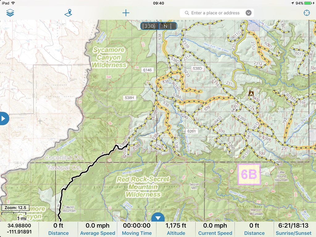

Same view with the MVUM layer on top (My custom map not available without help)

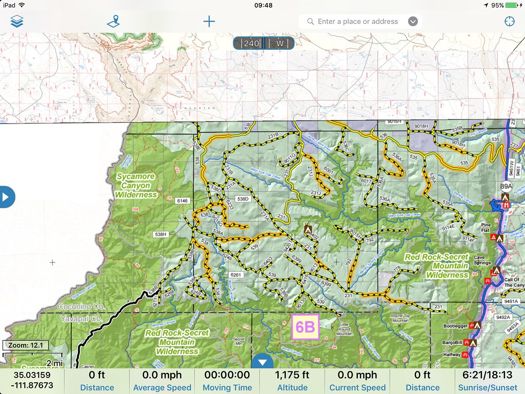

Same view zoomed out with the MVUM layer added on top. You can see where Coconino South MVUM ends on the west side of the map. You can always change the percentage of the layer so I could make the MVUM 100% if I wanted to.

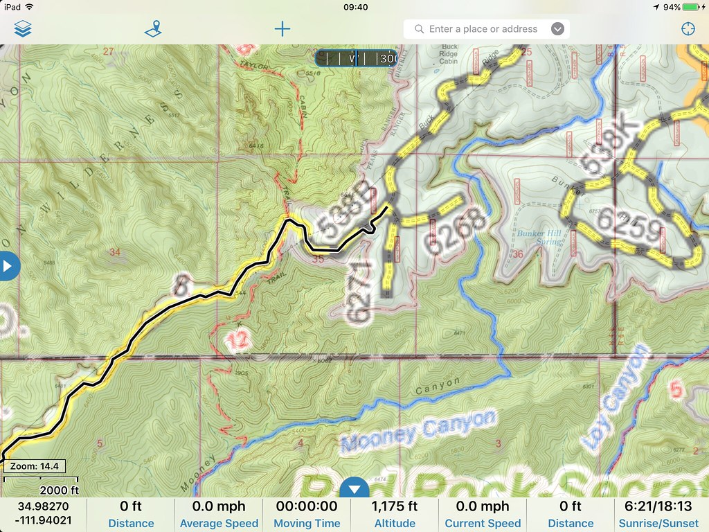

MVUM at 95%. You can see where the whitespace of the MVUM covers up the Raster info on the left. This view just gives you a better idea on the resolution of the MVUM color maps. Most are black and white though.
