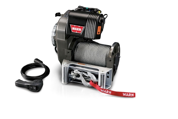

So the original 8274's were rated at 8,000 lbs and were shipped with 150' of 5/16" steel cable. Then came synthetic's and people loaded their 8274's with various lengths of 5/16" and 3/8" rope. Now Warn makes their latest version with an upgraded motor and possibly other items but it is now rated at 10,000 lbs and comes with 125' of 3/8" steel cable to handle the 10,000 lbs. and apparently one with 150' of 3/8" synthetic rope.
Just like our FJ-40's you now need to know the year/model of your 8274. :)
The 9.5XP motor makes the 8274 a real powerhouse; almost double the hp of the original motor. I have pulled some absurdly heavy stuff with mine; it will pull almost anything if the 40 is anchored.

Yes, there is a newer version (S) of something like that...that IS rated at 10K and has upgraded line.
But the original 8274-50 still came with 150' of 5/16" cable.

I can see 150' of 3/8" cable being stuffed on the drum, but from the factory it has always come with 5/16", even the 8274-50.
Somewhere along the line....your's was changed, which is fine. But I'd wager you have 120' feet on it. That's all I could put on mine (3/8").
I stand corrected, I could have sworn it had 3/8" line on it. Its a 8274-50. I use steel cable for the same reasons you do. It gets abused. Rarely do i hook to another vehicle or pull the my 40 out of something.
No matter. 'Now' with some of the latest 8274's there IS a 3/8" cable on them, so the model and year of production dictates what came on them from the factory, but 'most' left wearing 150' of 5/16" cable.
