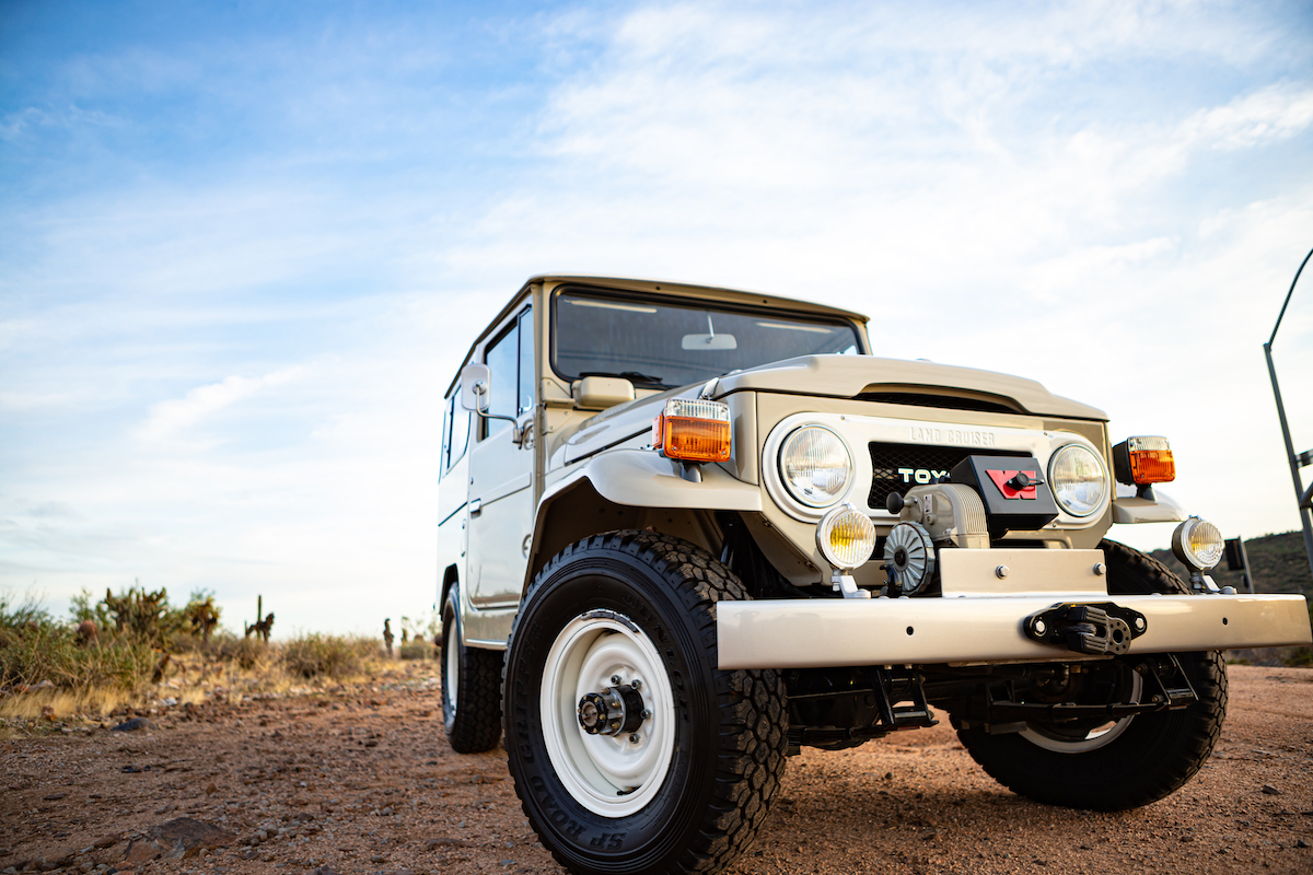

Who has a Warn 8274 Winch on their FJ40?
The FJ40 is made for the 8274, which needs room for its tall (and extremely strong) spur-drive gear case, which is also more efficient than planetary winch gears. They're easy to rebuild and all parts are available, so don't hesitate to buy used. It will last forever.
That picture should be in a magazine. Looks good!
Somehow I feel like buying an old one and restoring it is the best way for our old trucks... I followed the model outlined here by gents like @flintknapper.
$300 off Craigslist... needed some help. Dis-assembled, bead-blasted, powder coated drum, paint matched housing, Crawlorado solenoid cover, Albright solenoid upgrade. Fits the truck.

There are reason it's offset to the right? Saginaw power steering?
Originally It had sag p/s out frt, it now has scout steering on it. I also over compensated the room I needed, so it's a little more to the right than a normal setup. I use the winch a lot for pulling over and dragging out trees. Being offset more, helps when I need to butt up against a standing tree to make a hard pull. It originally was a miscalculation, but has since worked out perfectly.
