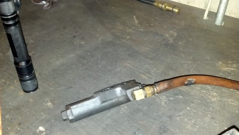

20 years ago he installed a remote oil filter kit and one of the lines was pressed up against the back side of the header.
I got the new hose made this morning and will be back to bombing it around until the next failure.

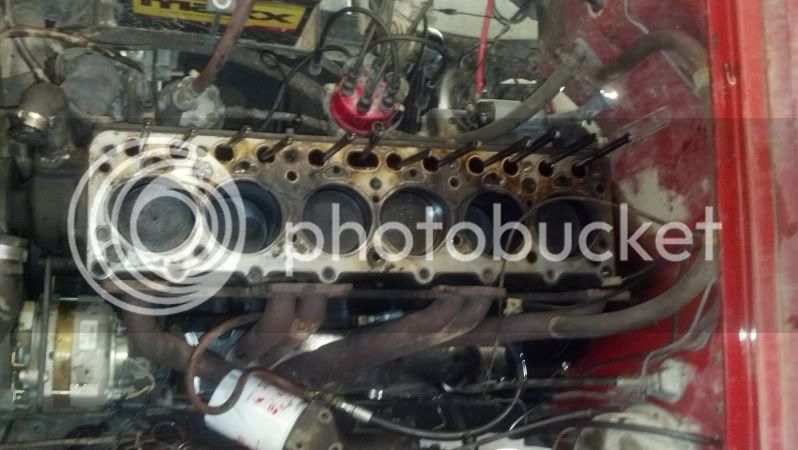

The header (I HATE headers) was reading 350-400* on 1, 4, 5, 6, and 185* on 2 & 3. A compression test revealed ~125 lbs on 1, 4, 5, 120 lbs on 6, and nothing on 2&3.
So I put on my garage flip flops last night, and popped the head off...

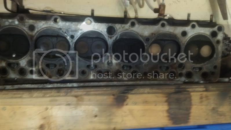

Kinda hard to see, but the HG is gone between 2 & 3.
Here is the head...
I'm not good at reading motors, or all the colors.... My thoughts were to simply replace the gasket and go on about my way. But after seeing how looks on the inside, Im wondering if I should rebuild it.... Thoughts? Im not a typical Land Cruiser guy (bored rich guy with too much time to scratch the maintenance rash caught during his land rover days...) ....in fact im not a land cruiser guy at all. Im a mini guy. I dont care to maintain s*** on this thing. If it is running i'm happy.
