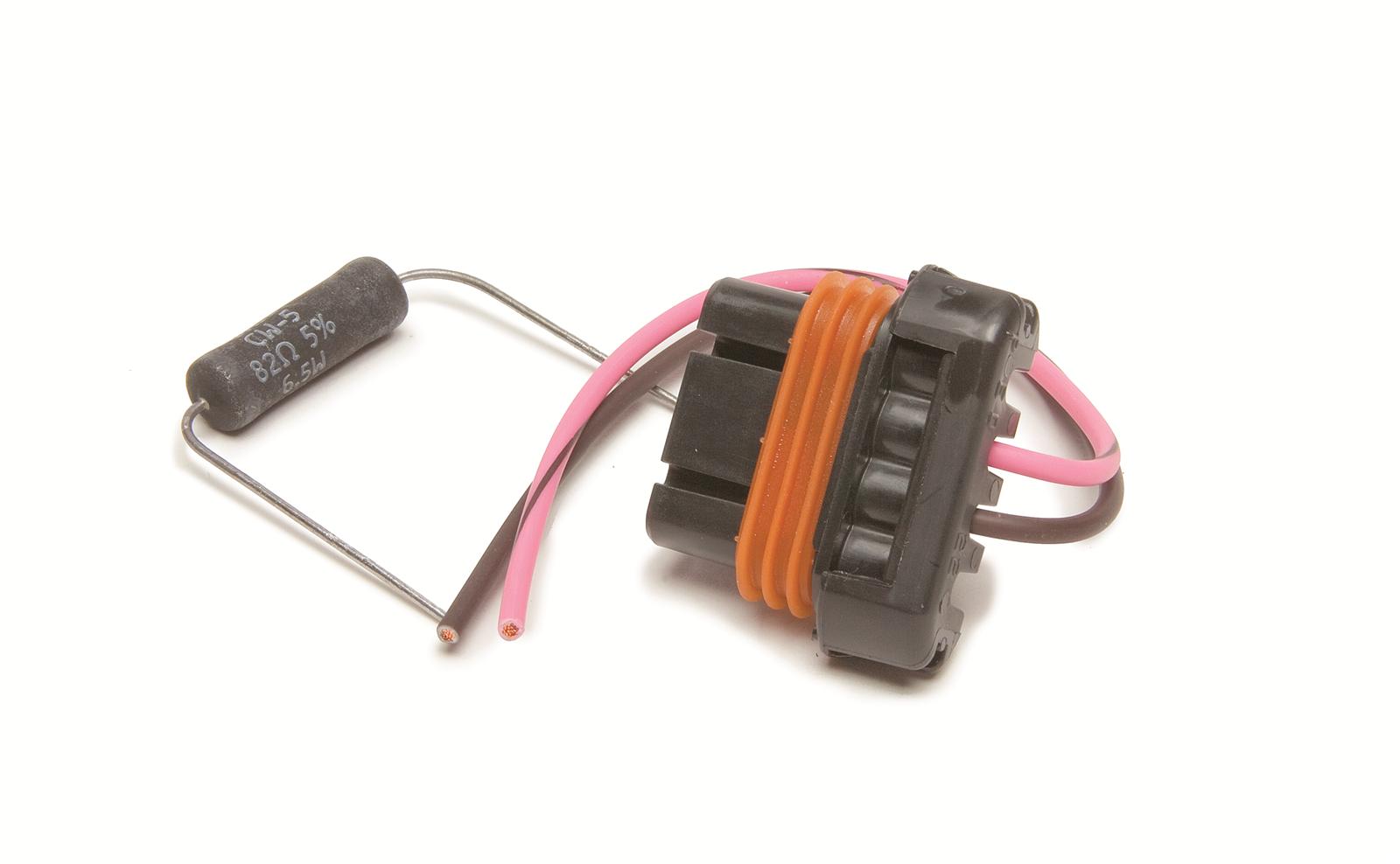

For the alternator i just use a small socket and builb in line at the exit of the alternator
^That
Or wire the resistor inline on the switched ignition source wire
^That

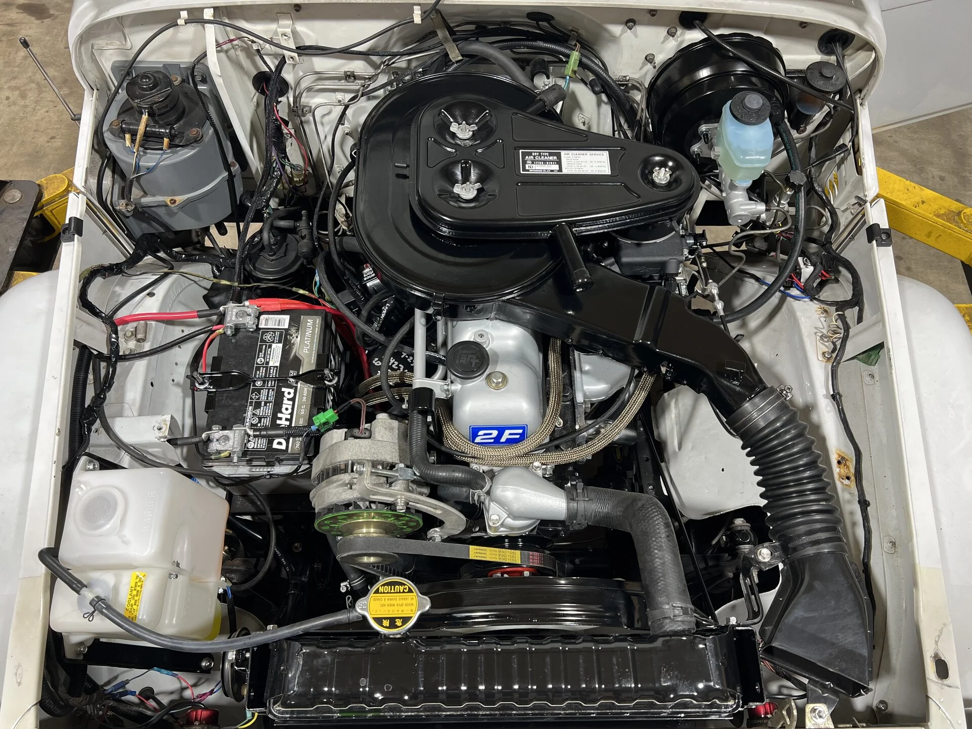

As for the alternator. I’m going to pull it out and get it tested. I have a FJ60 reman inbound I’ll install if it checks out bad. 55 amps is 100% plenty for a 40

1st i must say ive only used the earlier SI style gm alts and never wired up a cs130 style alt, and I'm no wiring wizard. If you run an alt charge wire straight to the batt like in the schematics in your post 172, then the white/Blue wire isn't used. When you run a wire from the large charging stud on the alt and go straight to the batt the ammeter won't work or register a reading. If it's a high amp alt you might consider bypassing the ammeter anyways. Imo, loosing the ammeter is a good thing. The alt needs 12 volts to one of the small terminals. The easiest location to get 12 volts is from the large stud on the alt going to the batt. The other small terminal is the excite terminal. It should act like a ground with the engine off and have 12 volts when its running. The excite wire gets an idiot light or resistor and gets its power from a hot circuit when the key is on. Most folks tie it into the ING circuit. If the wire didnt have a light or resistor the engine wouldn't turn off when you turn the key off because the alt is suppling 12volts thru the excite wire terminal feeding the ING circuit. You might try hooking up the excite wire without a light or resistor to a key ON accessory and not use the ING circuit. It might work. Those circuits turn off with the key and are separated from the ING circuit. If you dont use an excite wire you'll have to rev the engine to get the alt to start charging. Youll use the white/fusible link wire to the positive post on the batt. The batt now supplies power to the fuse box. Remember you read it on the internet.

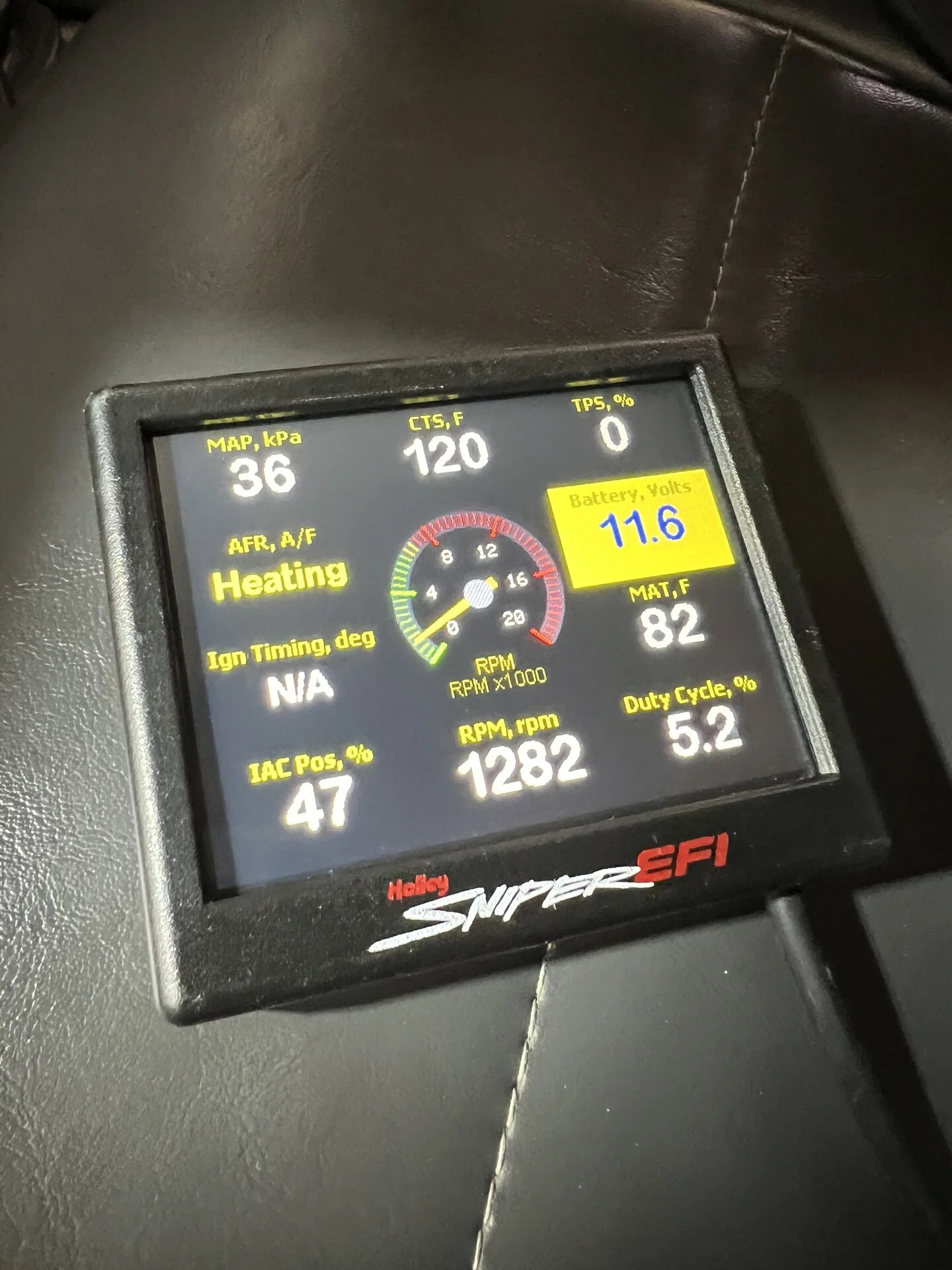

The Sniper readout has a Volt section. We drove it. Revved it and even jumped it yesterday and the thing never charged.

From searching around on info on the L terminal I think is for the excite wire which shouldn't have 12 volts. The terminal should be a ground with the engine off and have 12 volts with the alt/engine turning, which turns off the idiot light. The wire should have the idiot light or a resistor or possibly run without a resistor/light to a key ON accessory circuit that's not the ING.
