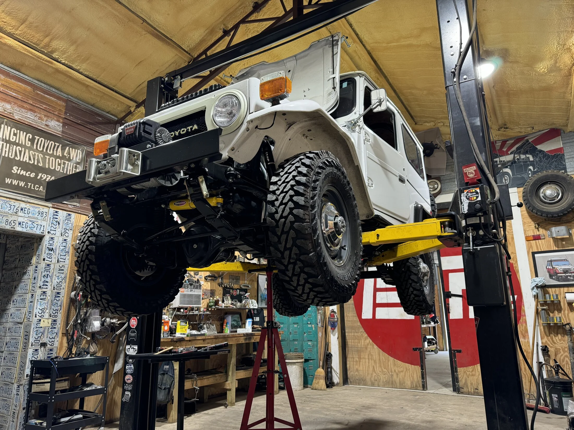

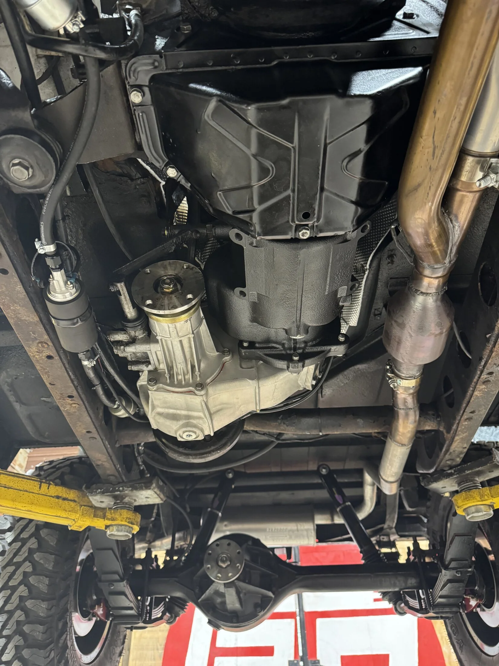

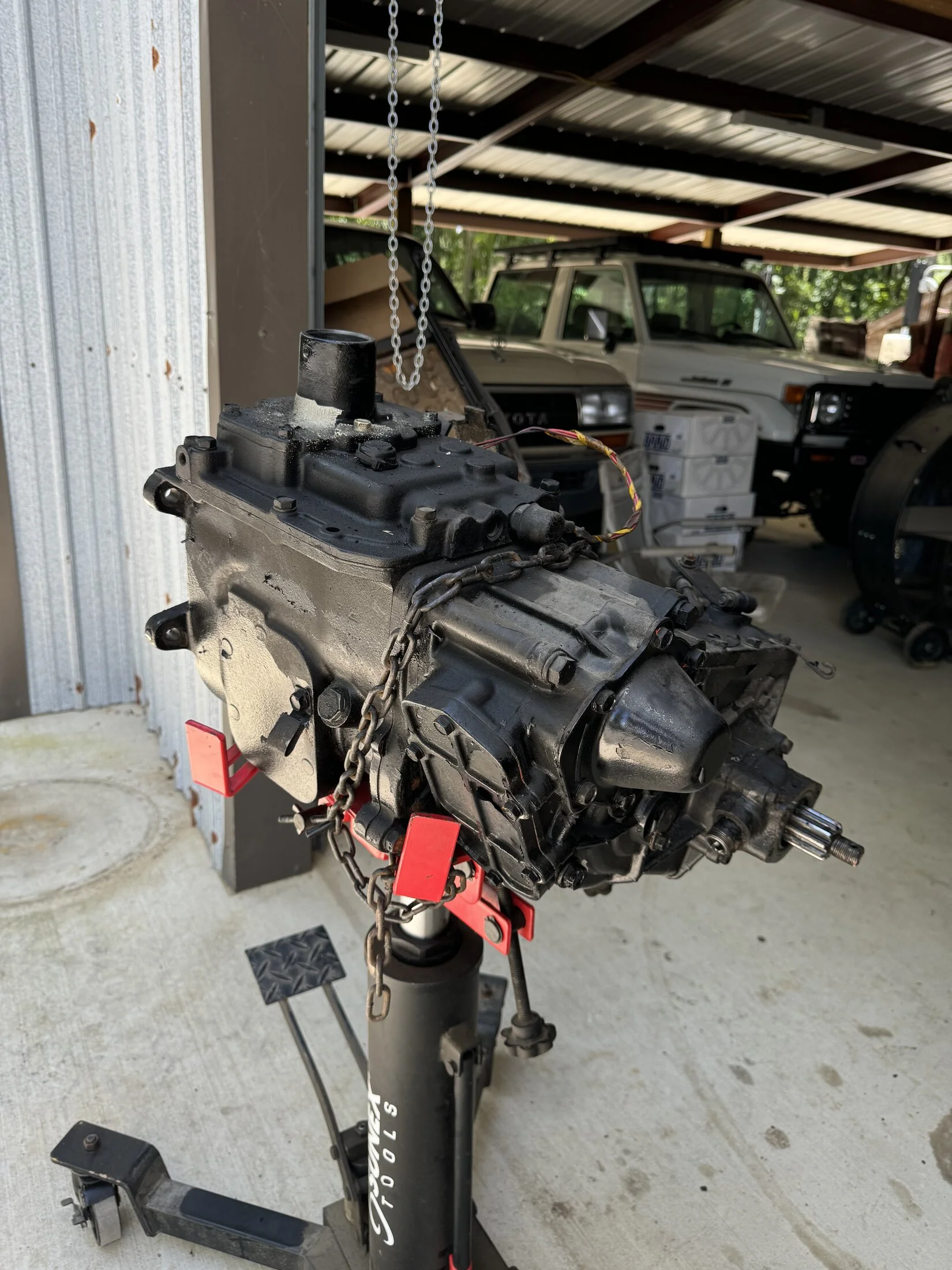

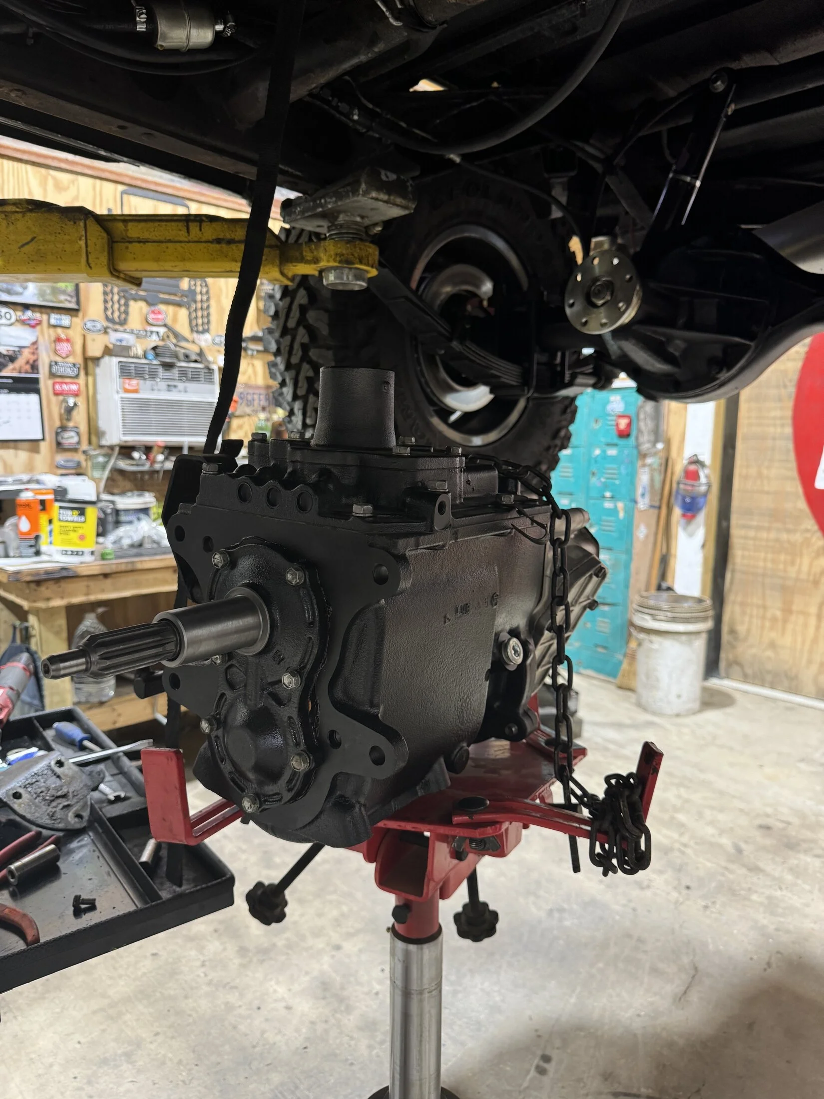

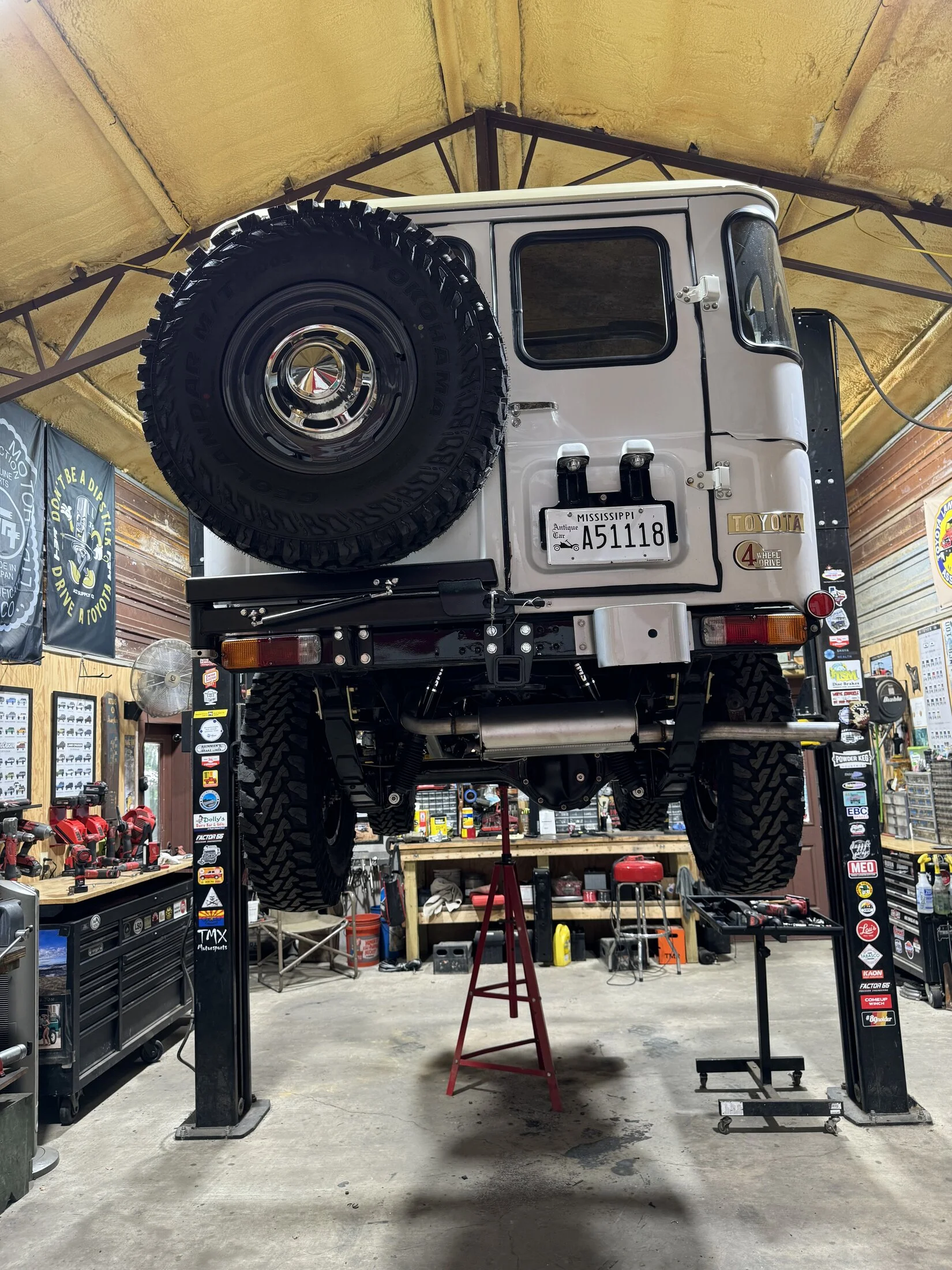

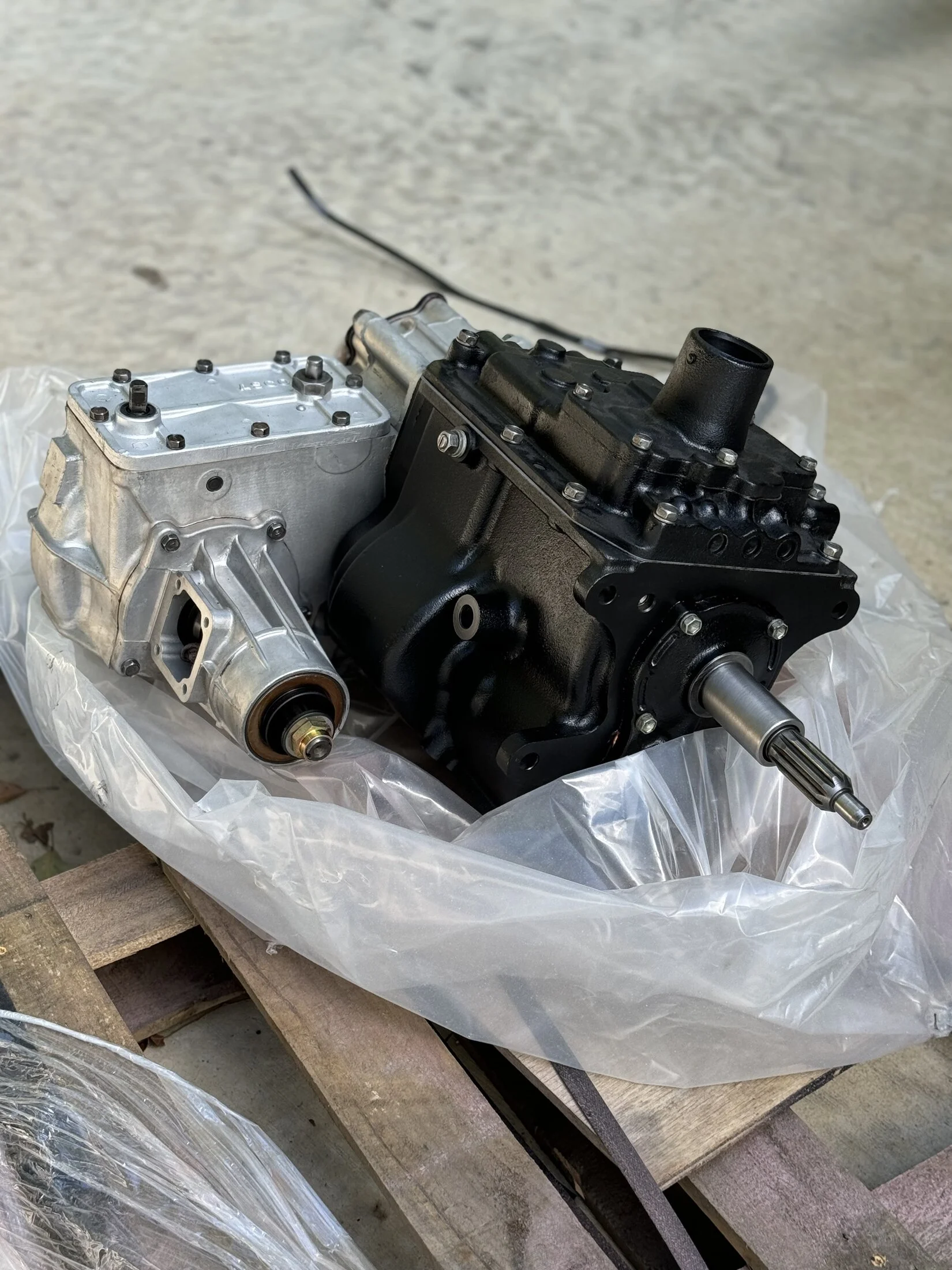

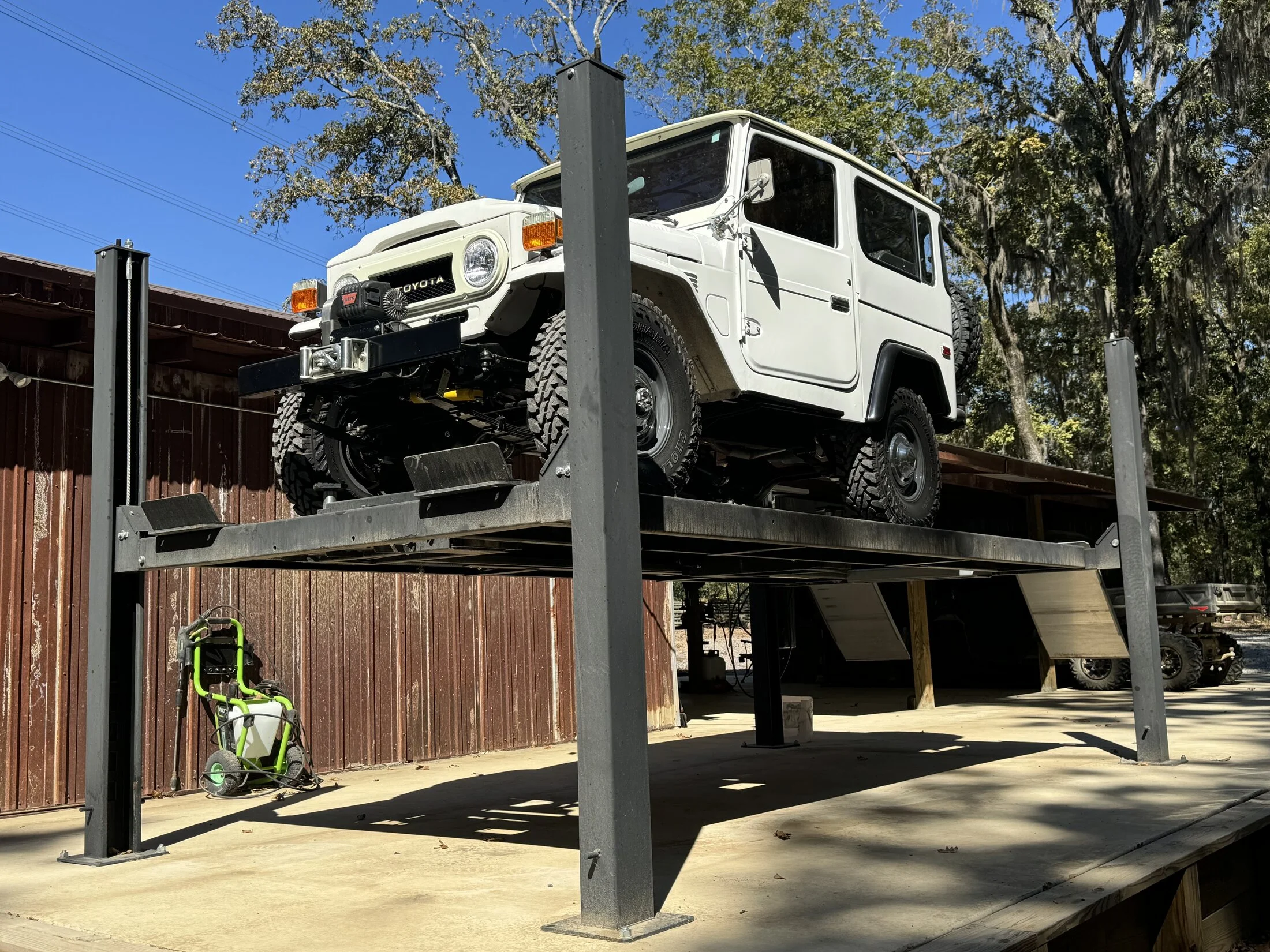

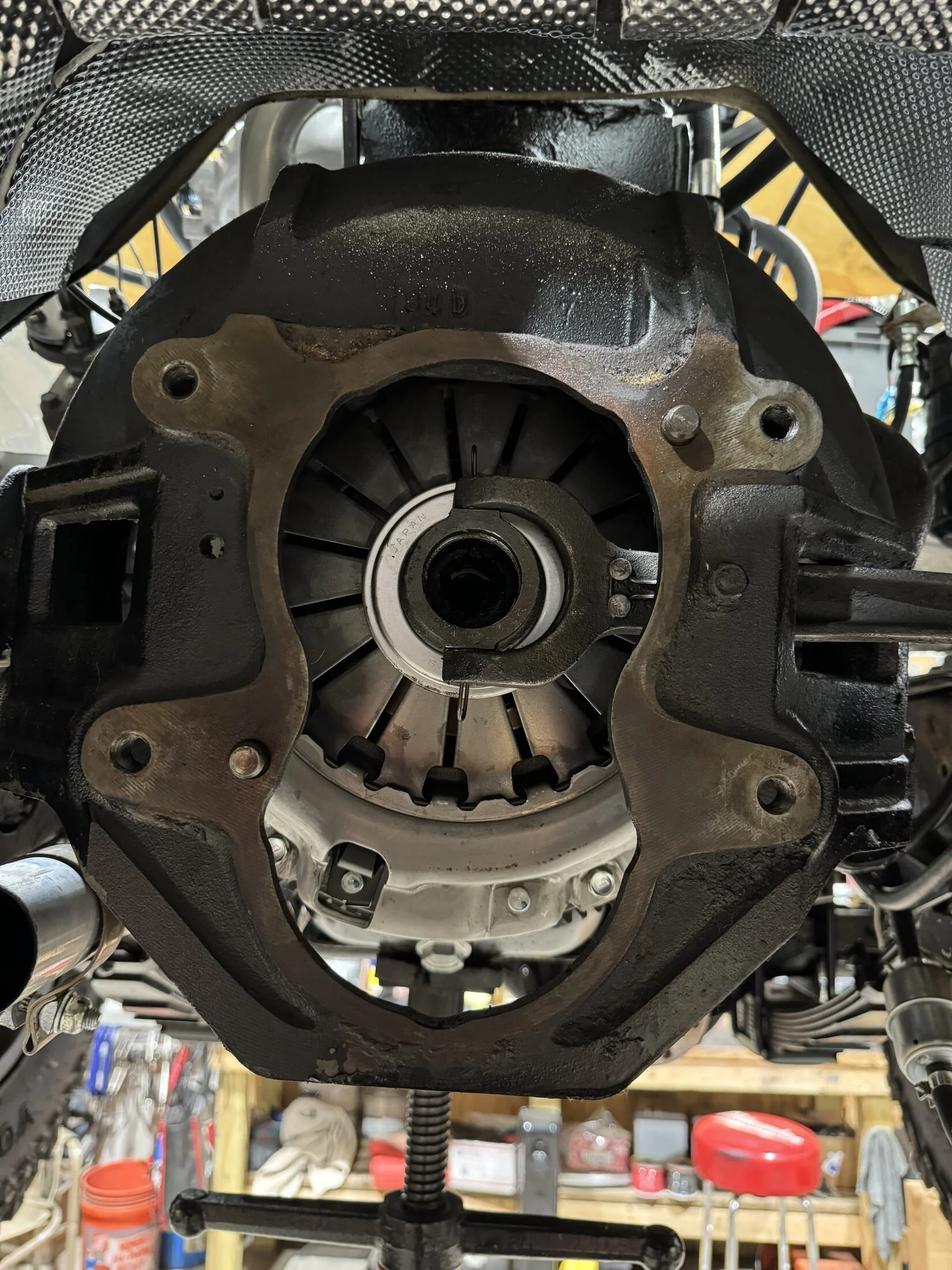

Whitey is back. The transmission was loud. @orangefj45 to the rescue.
It’s a bit more work to do this without pulling the trans hump but this one was bedlined in pretty good and that could lead to a huge headache

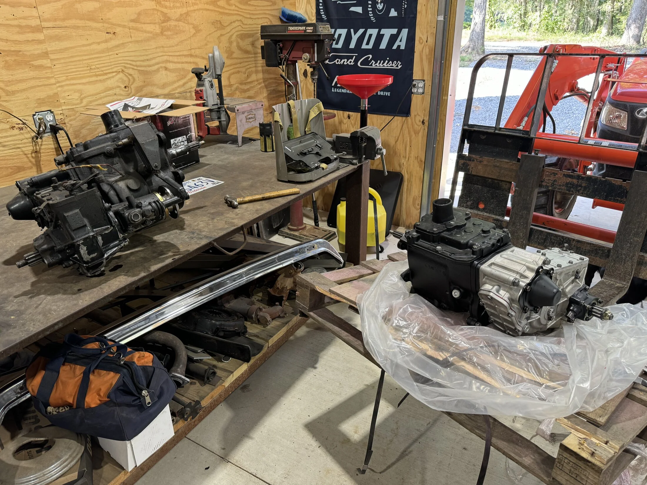

Clutch was about gone. Throwout bearing won’t turn by hand so it was close to a problem.
I have to swap over some parts from the old setup to the new and I can stuff it back.
I had to pull the exhaust out because the 2 piece header gets in the way of dropping the pressure plate.
Hassle.
It’s in. Test drive went great. The transmission is quiet as a mouse. Bravo @orangefj45

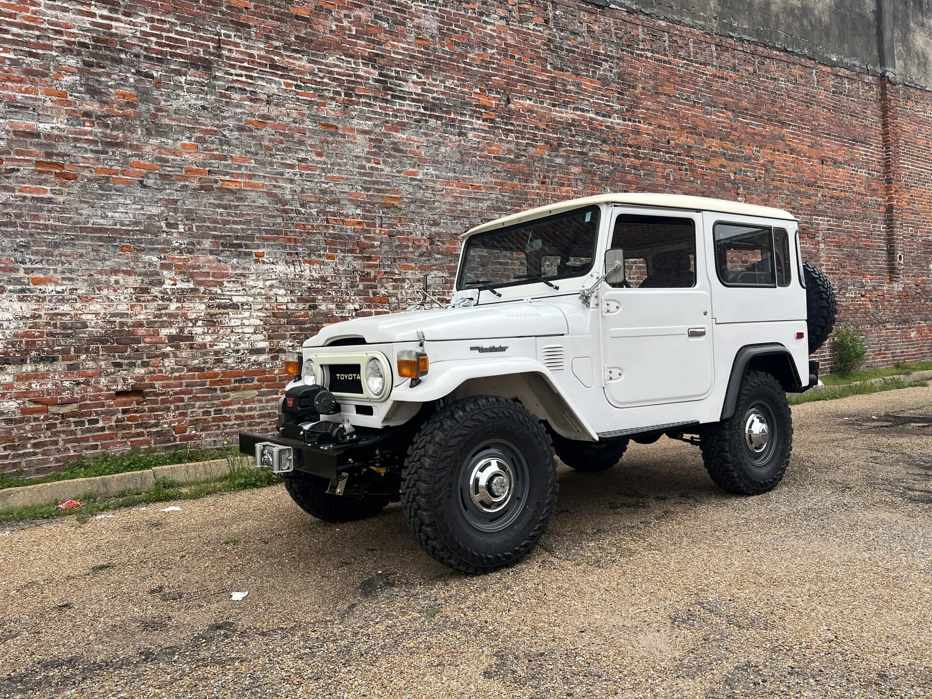

Picked up Whitey, he had burned out dash lights and the tail light fuse had popped.
Went over everything and it’s solid as a rock.
I forgot how nice this truck is.

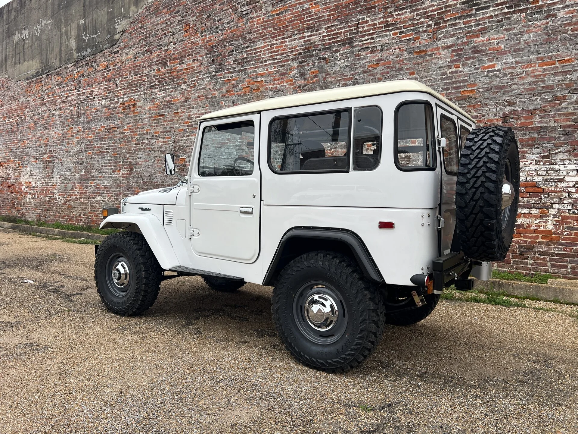

Took Whitey for a nice long drive today and she performed perfectly.

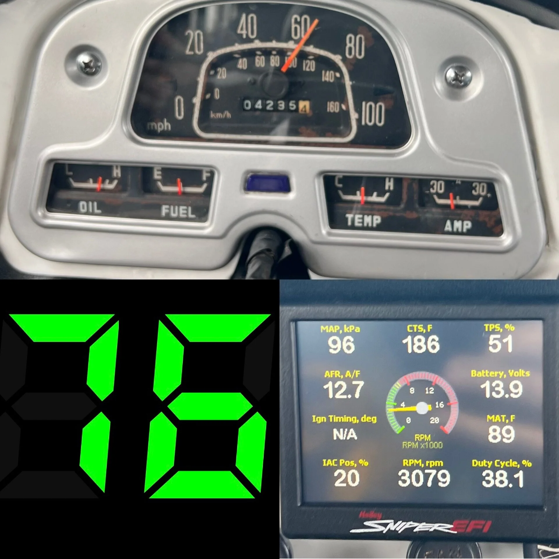

Made a little speed run at the end. Deputy Sherriff pulled toward me down the stretch before I could hit 80 but
May i ask what size alternator you are running with electric steering and the sniper set up planning same install thanks
Stock will handle it just fine. Neither pull much power.
