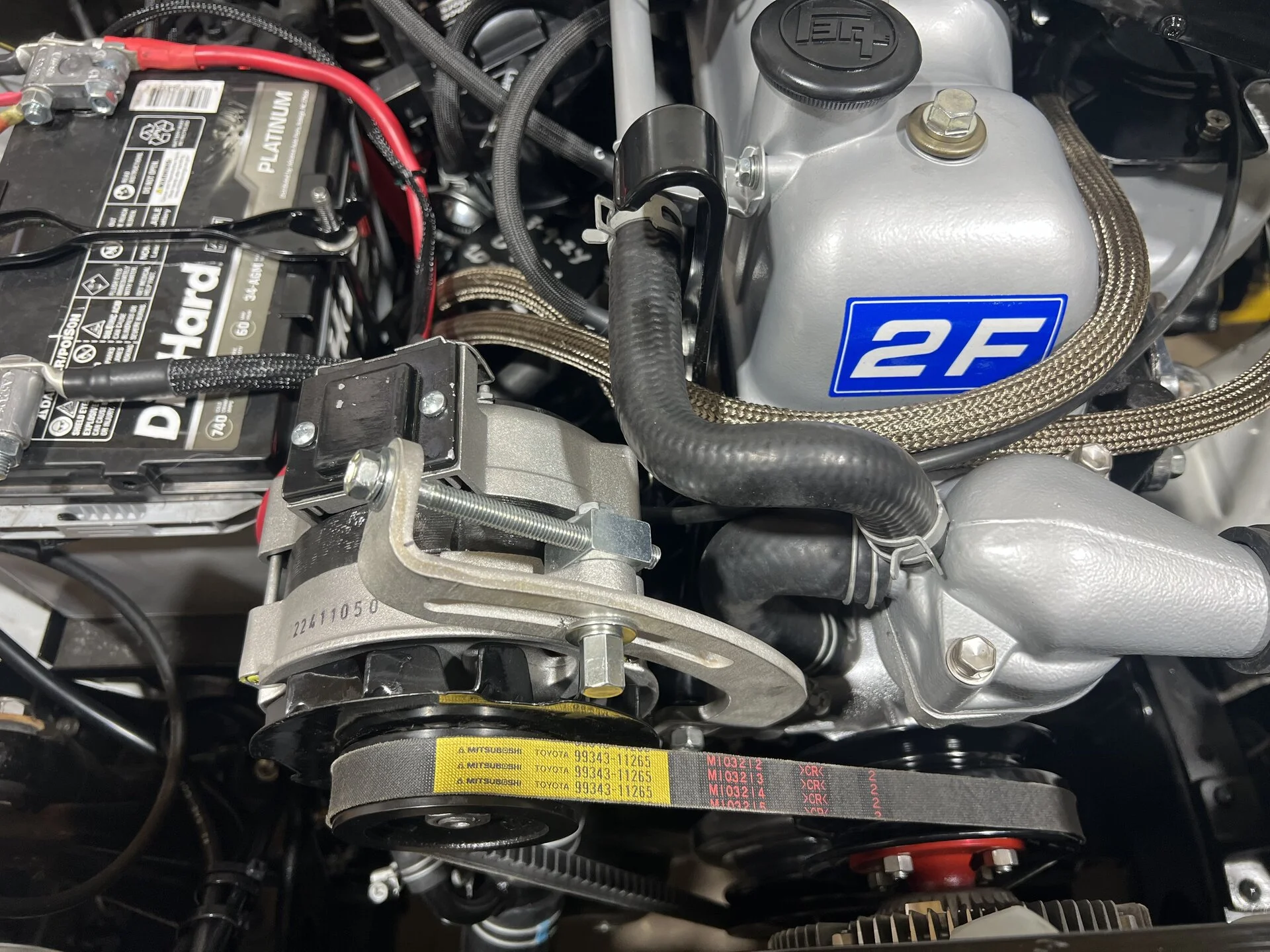

From searching around on info on the L terminal I think is for the excite wire which shouldn't have 12 volts. The terminal should be a ground with the engine off and have 12 volts with the alt/engine turning, which turns off the idiot light. The wire should have the idiot light or a resistor or possibly run without a resistor/light to a key ON accessory circuit that's not the ING.
That’s the way it’s set up. I’m banking on a bad alternator.
Remember, this all started with a wad of burned up wires. He took the truck and had it fixed at a local shop. It came here directly after the fix. Without a working ammeter there is no way to know if the alternator got toasted
Please don’t take this the wrong way: I know you know your S#!t,
I am surprised you jumped thru all of these hoops before just changing the alternator. In my feeble attempts with my own FJ40 2 years ago with a dead battery that looked new. . . Rock Auto…$39.00 A/C Delco .. perfect. Replaced it later with a ToyotaMatt $350.00 Denso but it solved my headache quickly.
I’m betting it’s a bad alternator

It’s funny. It’s the only thing I did not change on the motor. These things are kinda silly expensive. Thought I’d keep it if it worked.
I’m about to be on vacation the rest of the week. I ordered a new one.
It really has not been any trouble. Hell I just got it cranked 2 days ago.
Well, you know as well as anyone, Toyota alternators work great, till they don’t.
Placed the order, go on vacation, enjoy the company and some cold beverages, the fix will be there when you’re back!
Cheers!
I somehow overlooked the fried wires earlier in your post. That alt got fried. However, I bet a old school Alternator shop could probably bring it back to life. For what they charge for those it may be worth a try.

And the most important thing…..the FJ60 alternator arrived and boom. We have power.

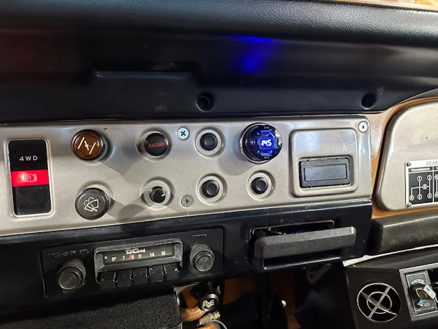

Interesting that the plug in voltage meter and the sniper read slightly different. I would think, if either would read lower, it would be the plug in one.
If I had to take a guess it’s because the charge wire for the alternator goes through the ammeter in the dash before going to the battery charge. Where the sniper voltage is directly at the battery 8’ away from alternator via wiring. And the cig lighter is off the fuse block which gets power before the battery.
At least on my 69 wiring that’s how it works.
