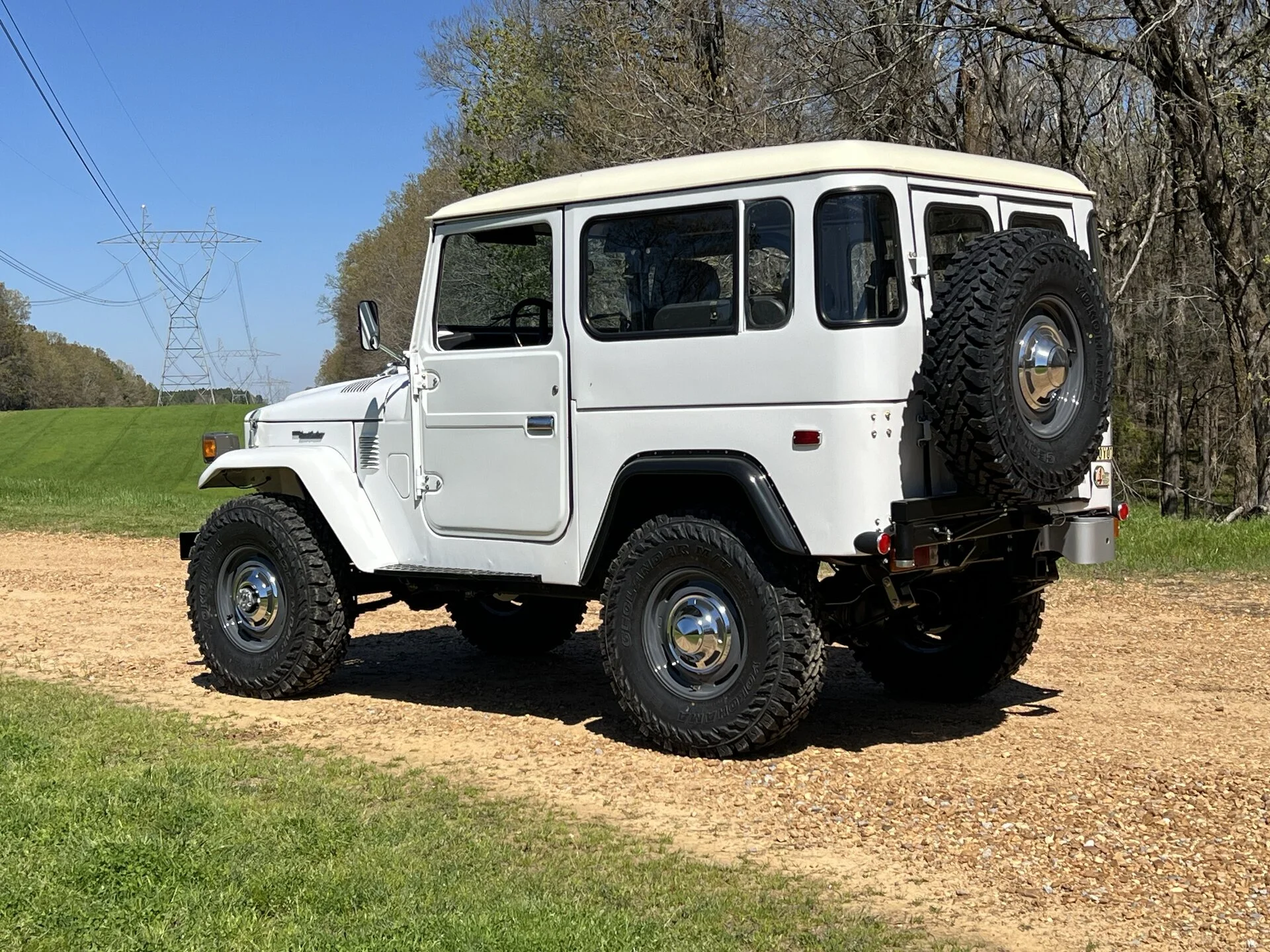

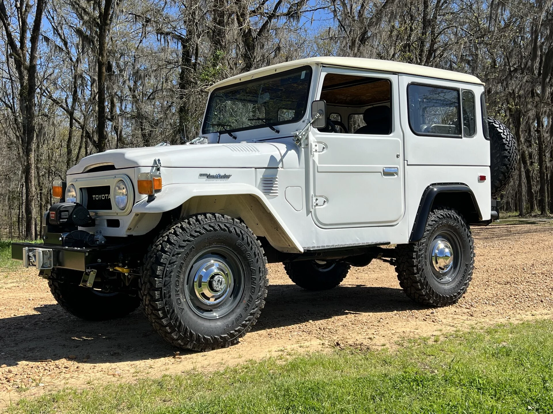

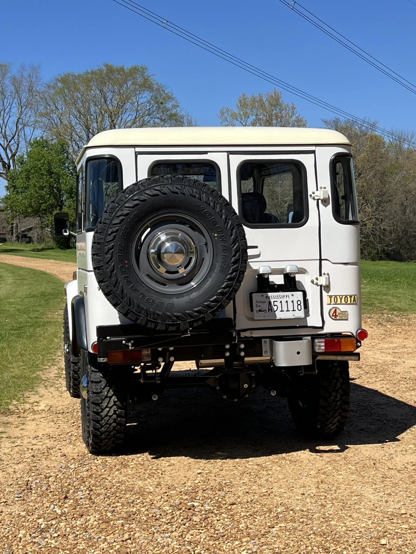

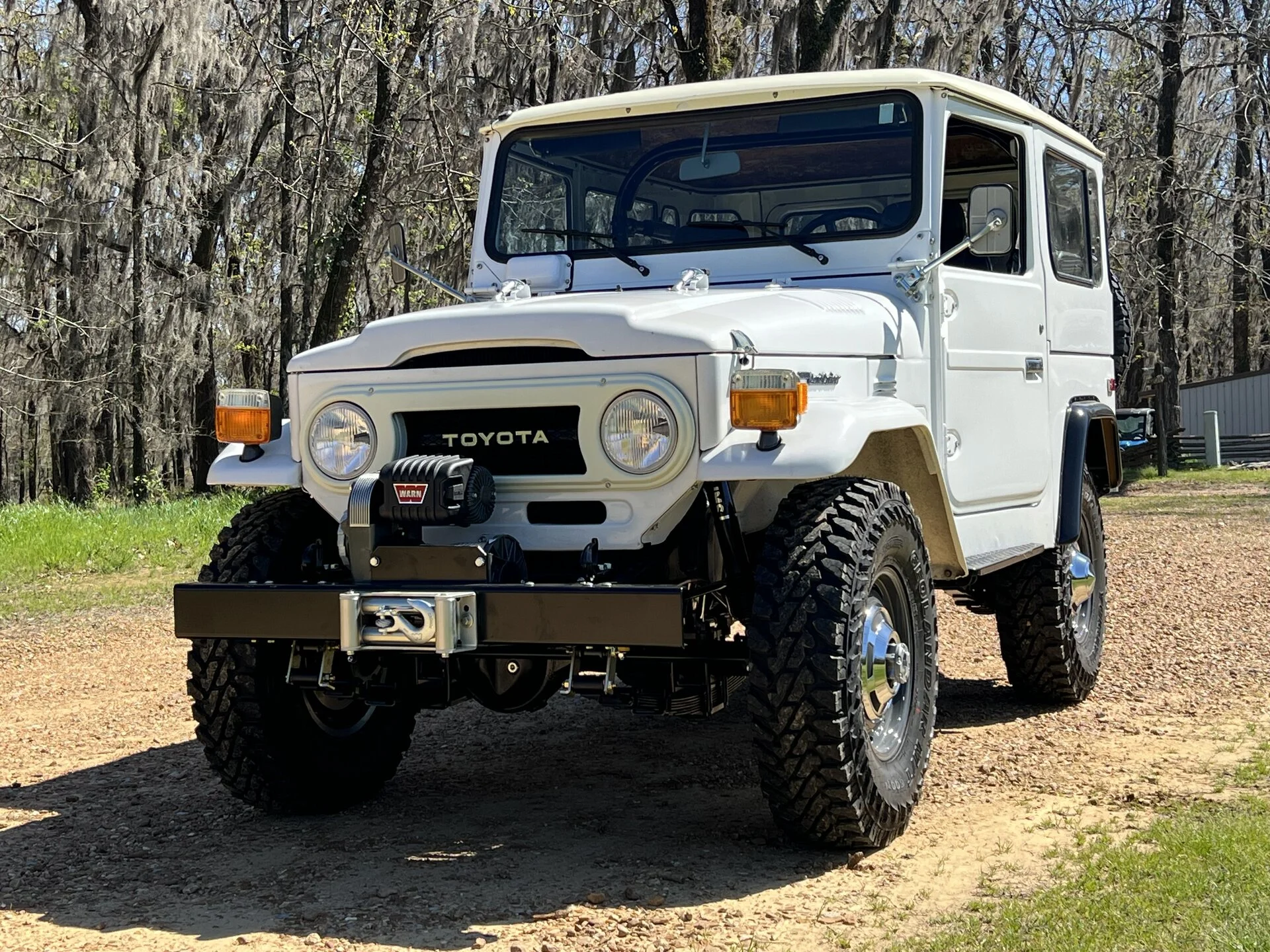

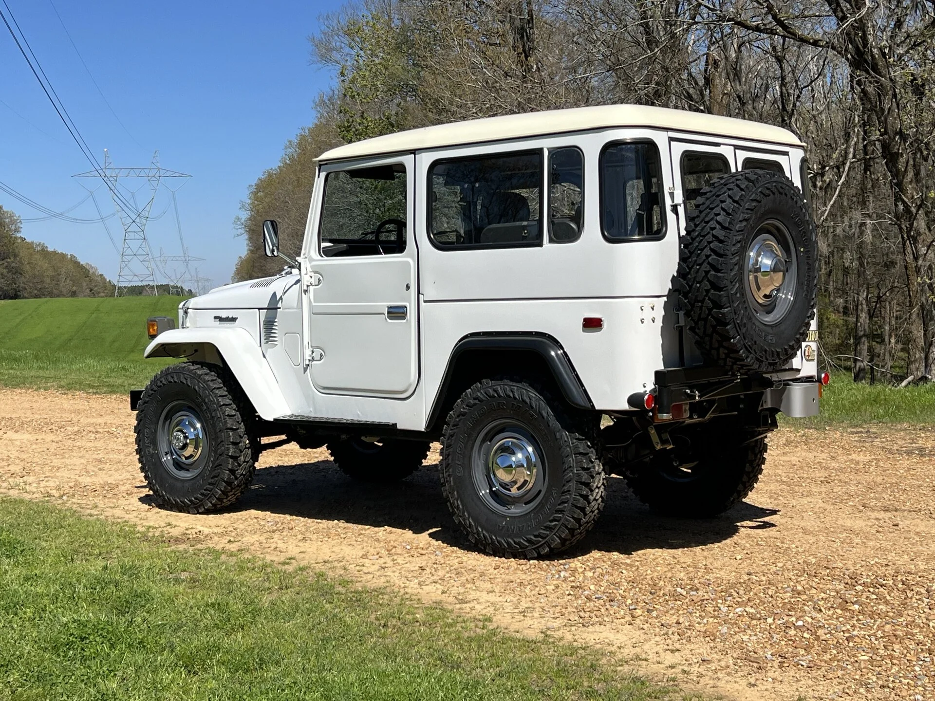

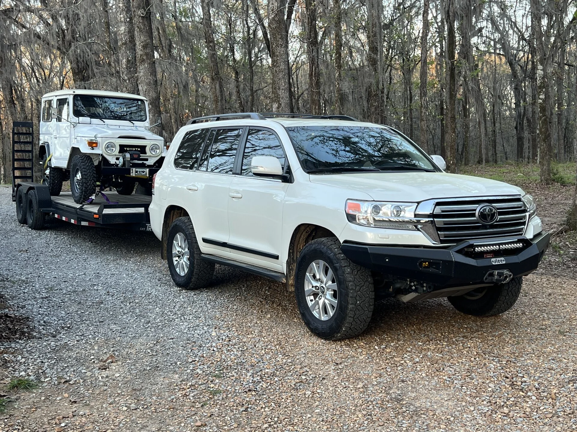

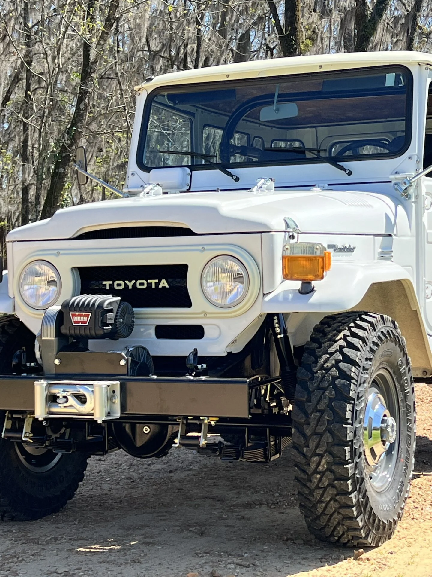

I was about to pull the trigger on the City Racer EPS swap when I thought to message the stereo guy to get an appointment for Whitey and he had a cancellation this week so it’s headed to Audio Solutions. The EPS can wait. Here are some outside glamor shots.

People love the white 40. I had it at the club this morning and had 4 people tell me how hot it is.
Just dropped it for a stereo. The one that was in there had a doozy of a setup. We are keeping the speakers. They were well done.
