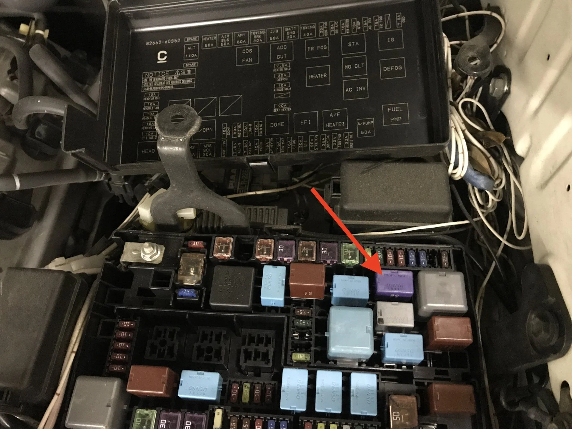

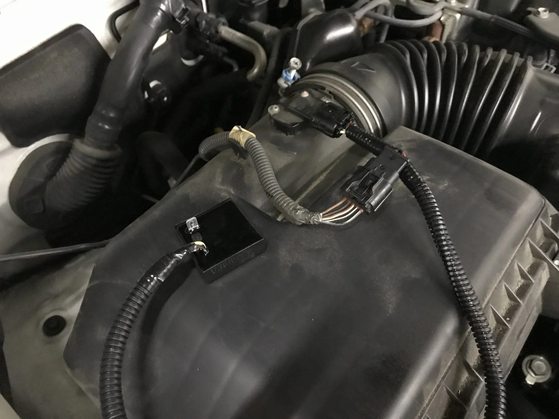

A few months after owning the truck the CEL came on. Took it to the dealer and they read code P1445 which in their words is:
P1445-SECONDARY AIR INJECTION SYSTEM SWITCHING VALVE #2 STUCK CLOSED.)

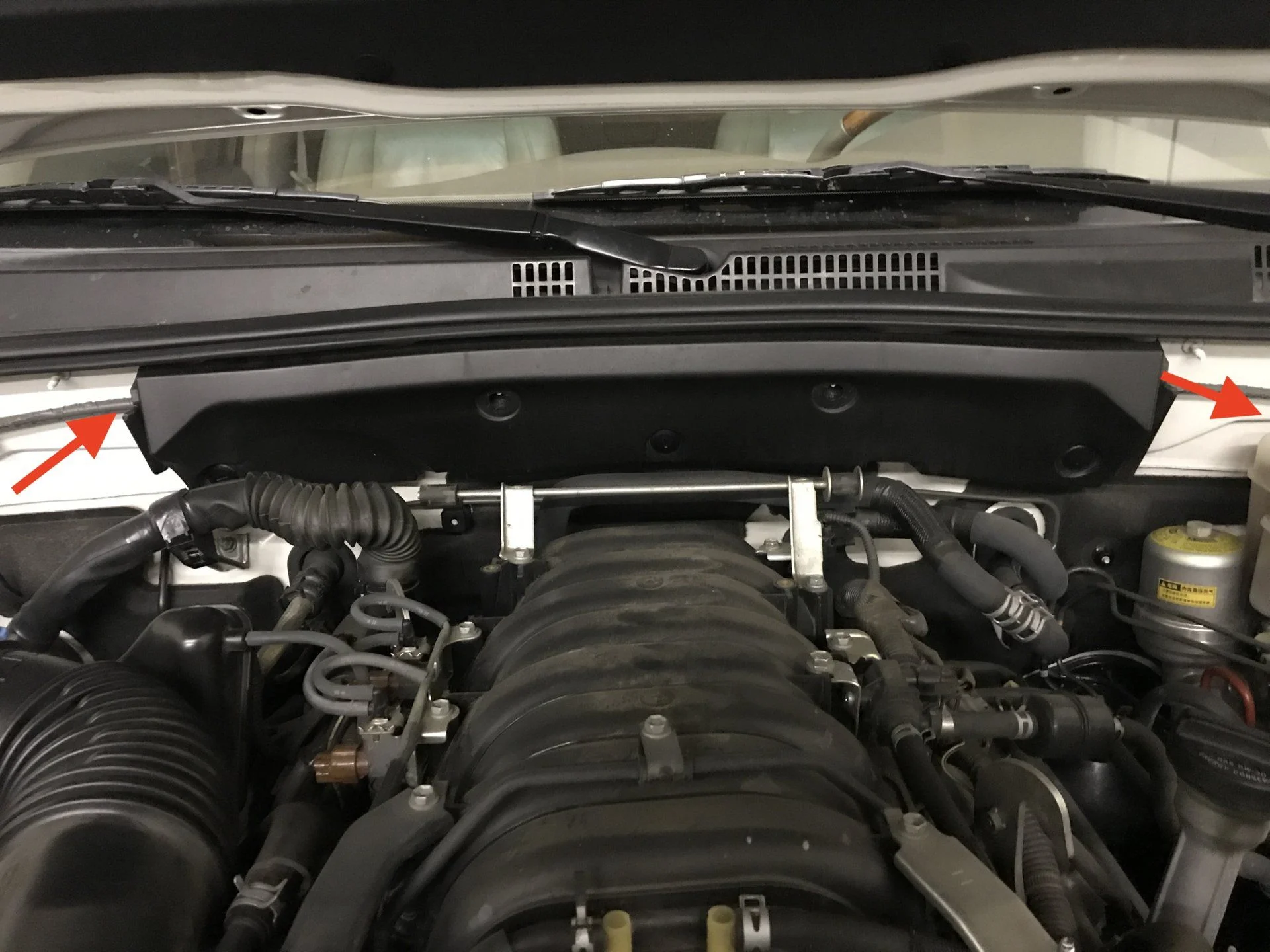

Quote to fix this was $2,350. Ouch. I began looking for other options. Found here on Mud a number of threads about the Hewitt-Tech SAIS bypass. Fortunately we were planning to move out of California and into Utah. This $260 option would work. Already moving out of CA was saving us money.

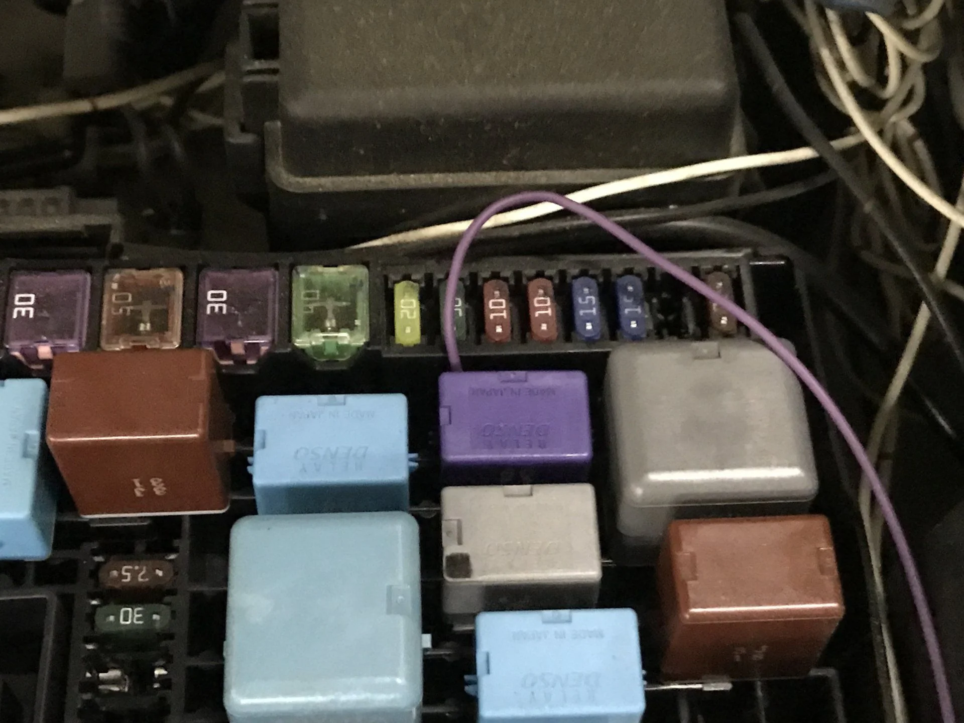

Ordered the part, followed supplied instructions and others pictures here on MUD: 2005+ Emission/Air Pump Failure?
Overall fairly easy job. Toughest part is installing the block off plates but my XXL sized hands managed.
1932706
Purple Starter Relay
1932718
Module harness plugged into MAF sensor
1932724
Wrapped it around the relay as instructions show.
1932737
Relay back in place with bypass wire attached. Picture here shows purple wire very loose. This was done as a mock up and tested. Then I pulled the relay, routed the wire by the firewall, cut to length and reinstalled on relay.
1932738
Where I routed the wire behind the plastic guard. zip tied in place.

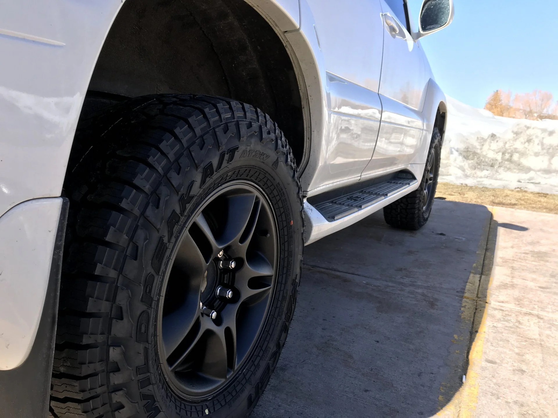

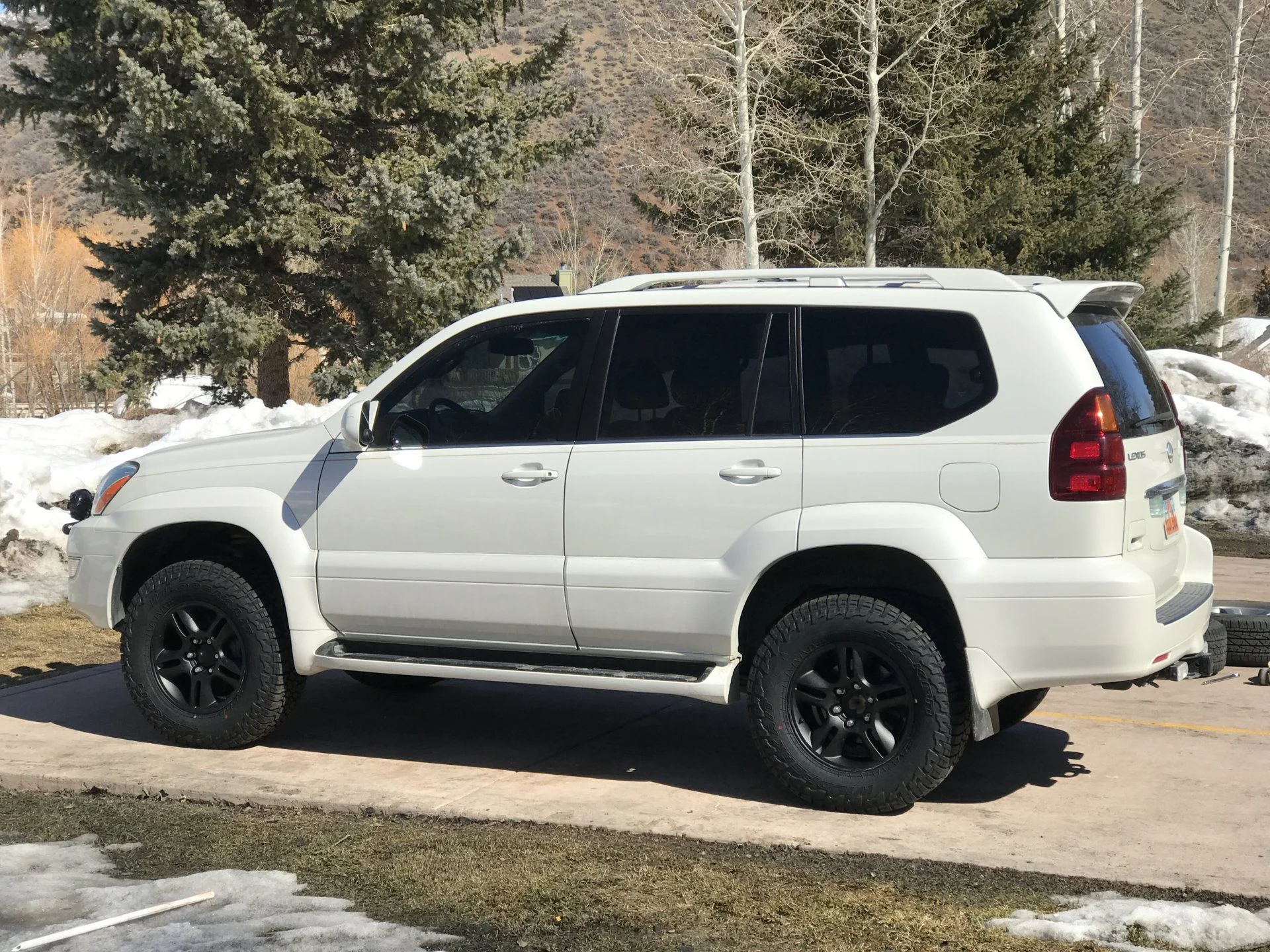

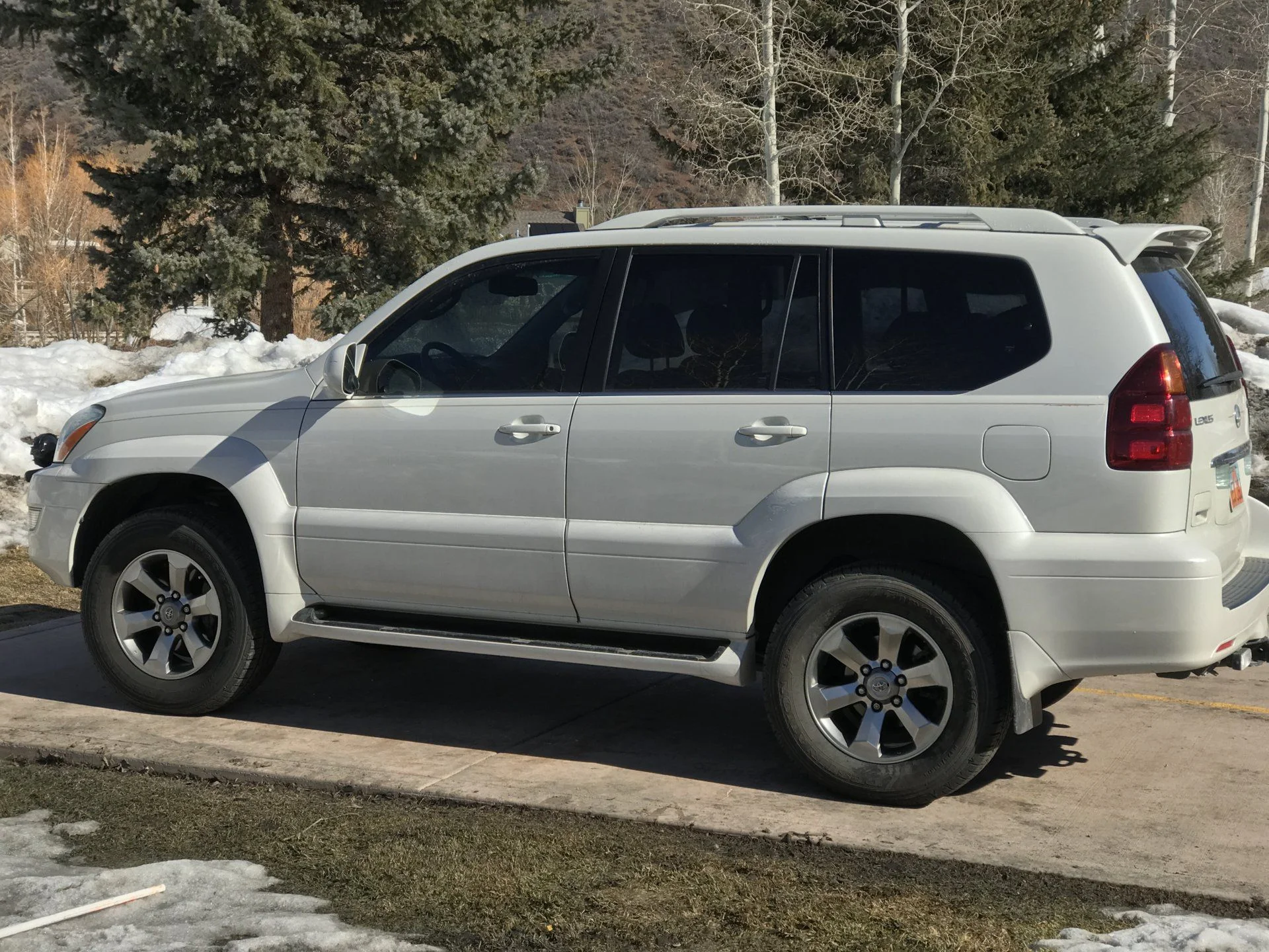

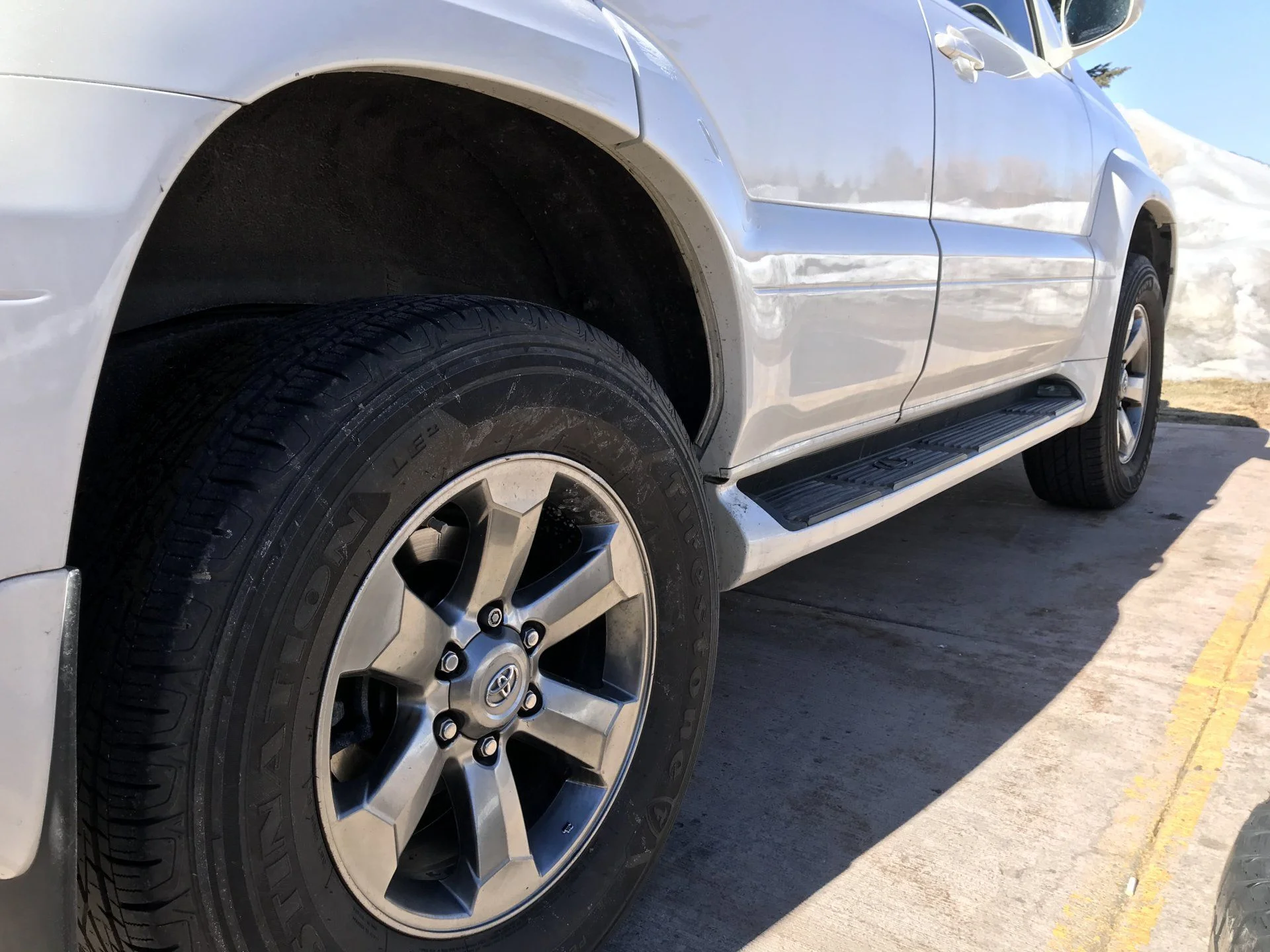

The PO of this GX bought some Toyota 18" rims shortly after purchase. He did keep the original GX 17" rims, which came with the purchase of the truck.
I took the original wheels down to Full Blown Coatings to make them black, ordered some Falken Wildpeak AT3 LT265/70/R17. I like the look of the black wheels and the true AT tires look better too.
1933217
Seen here with Toyota 18" and Firestone Destination P275/65/R18
1933228
1933229
Replaced with Falken Wildpeak AT3 LT265/70/R17. Not shown in these photos but also had the Lexus center caps powder coated in the same black.
