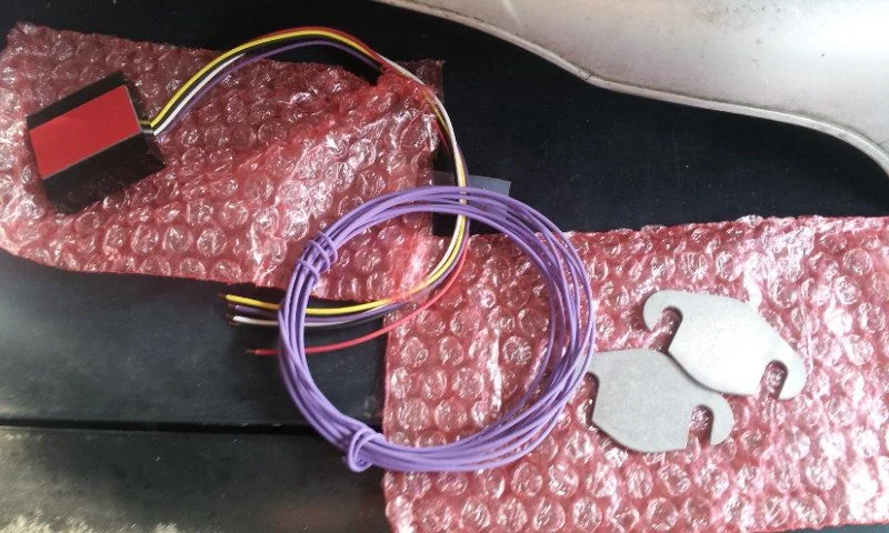

we had this issue pop up on our GX earlier this year in January but it seemed to go away when the outside temps are above 90 degrees - common in Houston. but now the CEL and a couple other dash lights are back on permanently. i decided on the bypass route. I ordered a kit from these guys Hewitt Technologies Inc. - Store

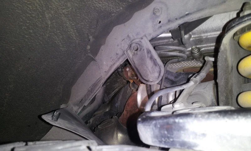

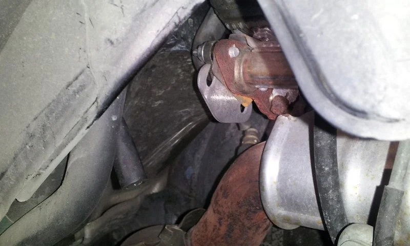

i decided to install the block off plates 1st. passenger side is a bit of a bear to get at. you can access them without taking off the tire. i used a stubby 10mm on the outermost nut and a 1/4 drive ratchet with a 10mm deep socket on the inner most nut.

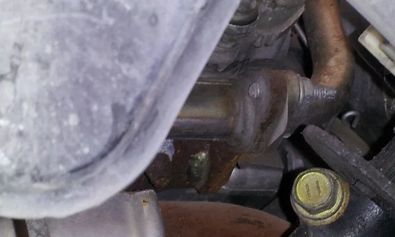

driver side tube is easier to access.
i watched a couple youtube vids to get the gist of the install. One video said to route the purple wire from the starter relay 1st so you could get a cleaner install. i temporarily installed the purple wire 1st and then decided on a location for the module. I decided to stick it on the passenger side fender well just behind the air filter box.

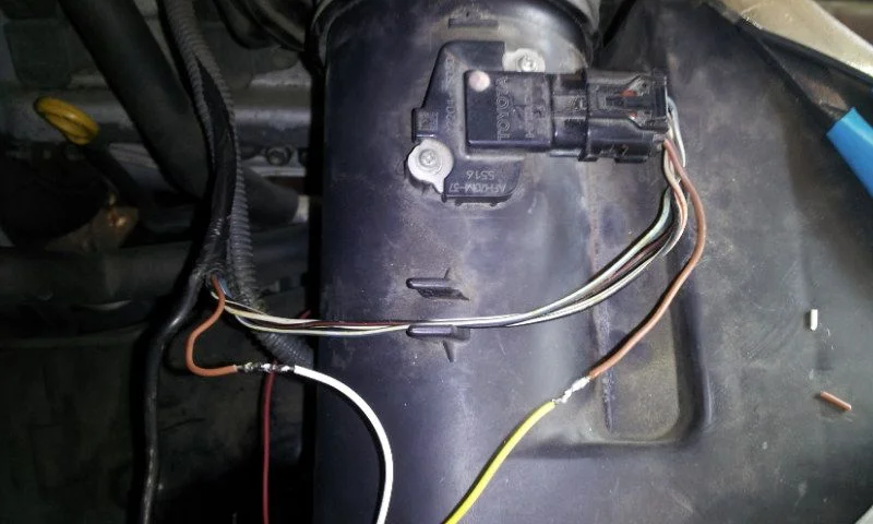

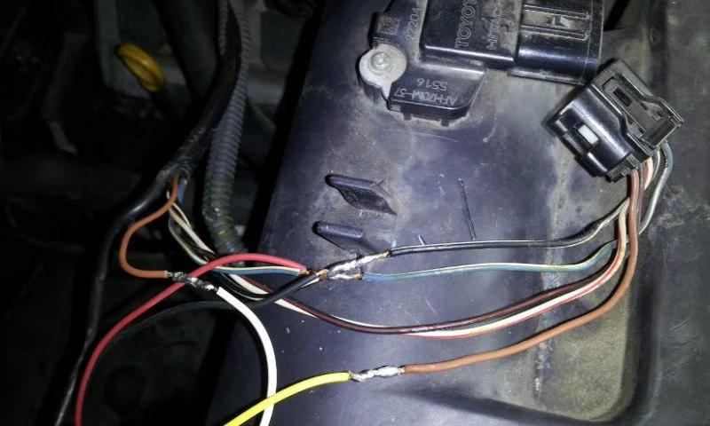

next i had to splice into a couple of wires. i'm not good with soldering so i watched a couple more youtube vids on the subject and practiced on some scrap wire to get the hang of it. below is the finished product. all i had to do was get out the electrical tape and start buttoning things back up. I still need to get some wire loom to hide the purple wire from the relay box.
the kit works as advertised. no more CEL and warning lights! of course this is "off road only"! Cheers!

Nice install of our V3xW wired kits for the 05-07 vehicles. It is also available in a plug and play kit so you don't have to wire it in, currently our V36H kit. We also have them for the 08-2012 guys but those are out V52H kits because of differences in the ECM.
