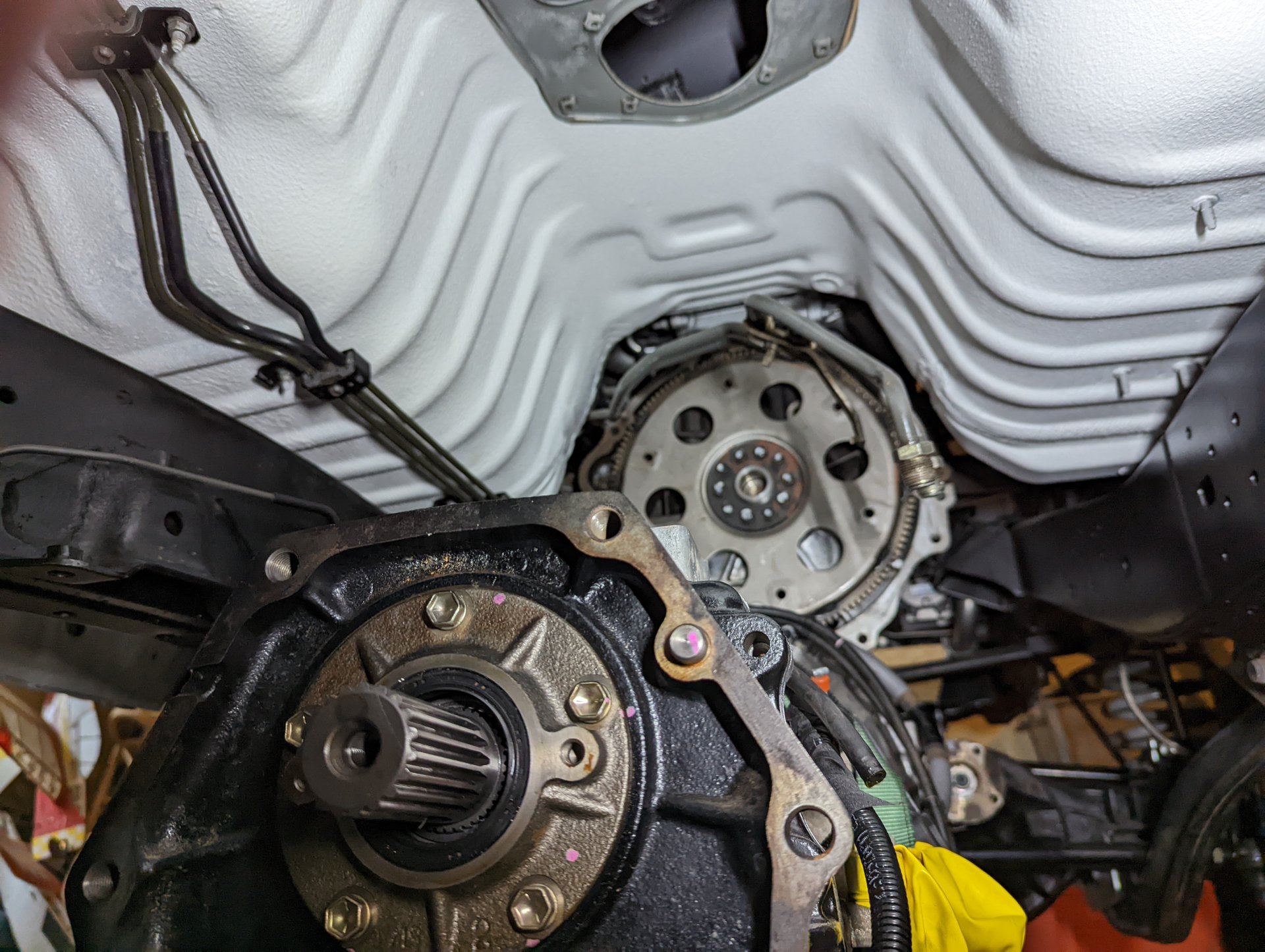

I really don't want anyone touching it, so it all worked out. To put this thread back on track, OP, you could always clean and Raptor the tranny tunnel while everything is out...
Jason
Jason
Now this is curioous, never even thought of this and I actually like the white, easy to see leaks and issues.
