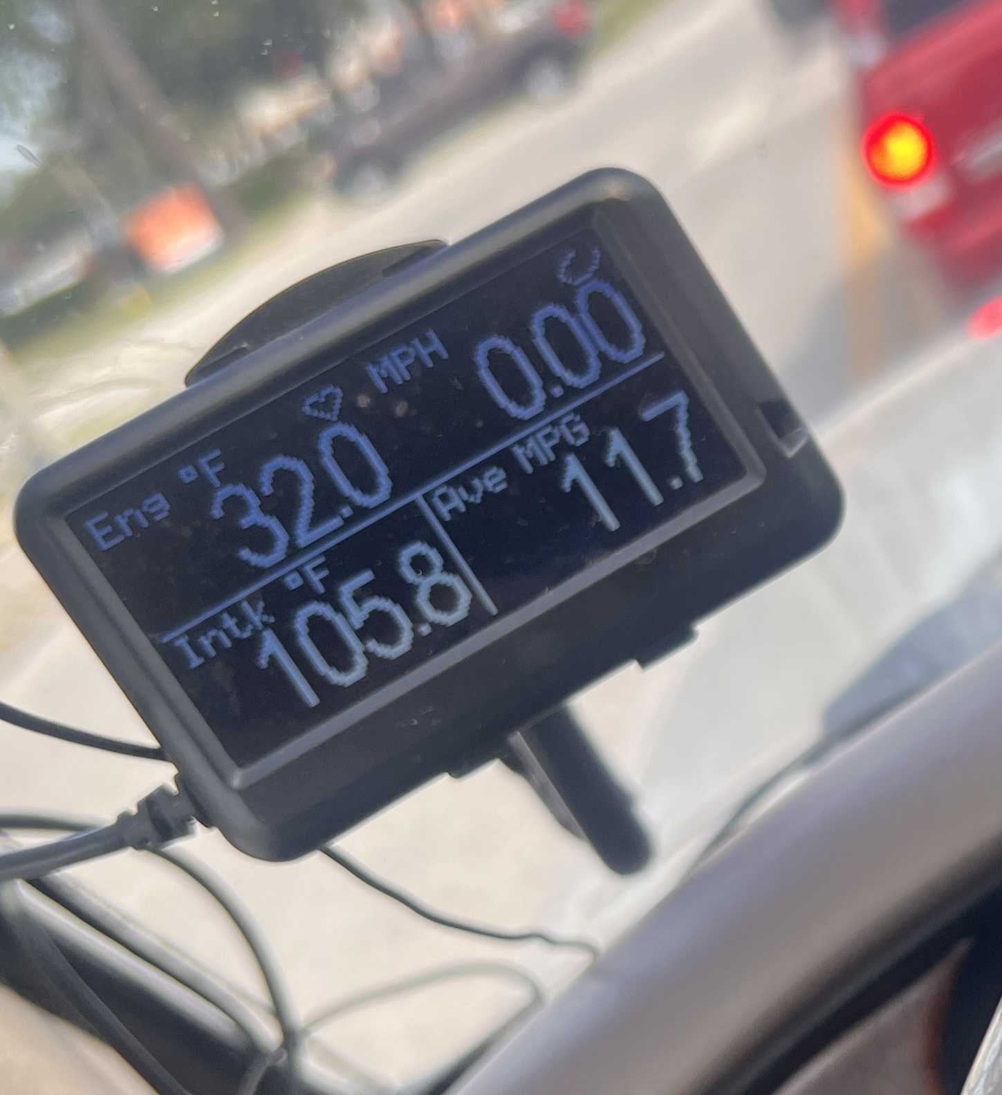

I have an ultragauge. Does anyone know which sensor it pulls its engine temperature from?
I thought it was the forward most sensor, but after replacing that sensor with a new OEM one, I have my doubts.
The engine temperature is actually about 186. It will display 186 or whatever the accurate temperature is for some period of time.
Then, out of nowhere, it reports temperatures like seen below. When it displays this low temperature, it will not start easily and seems like it's flooded.
So, I'm trying to chase down which sensor it is so that I can check the wires and possibly replace it.
So does anyone know which temperature sensor provides the engine temperature to the ultragauge?
