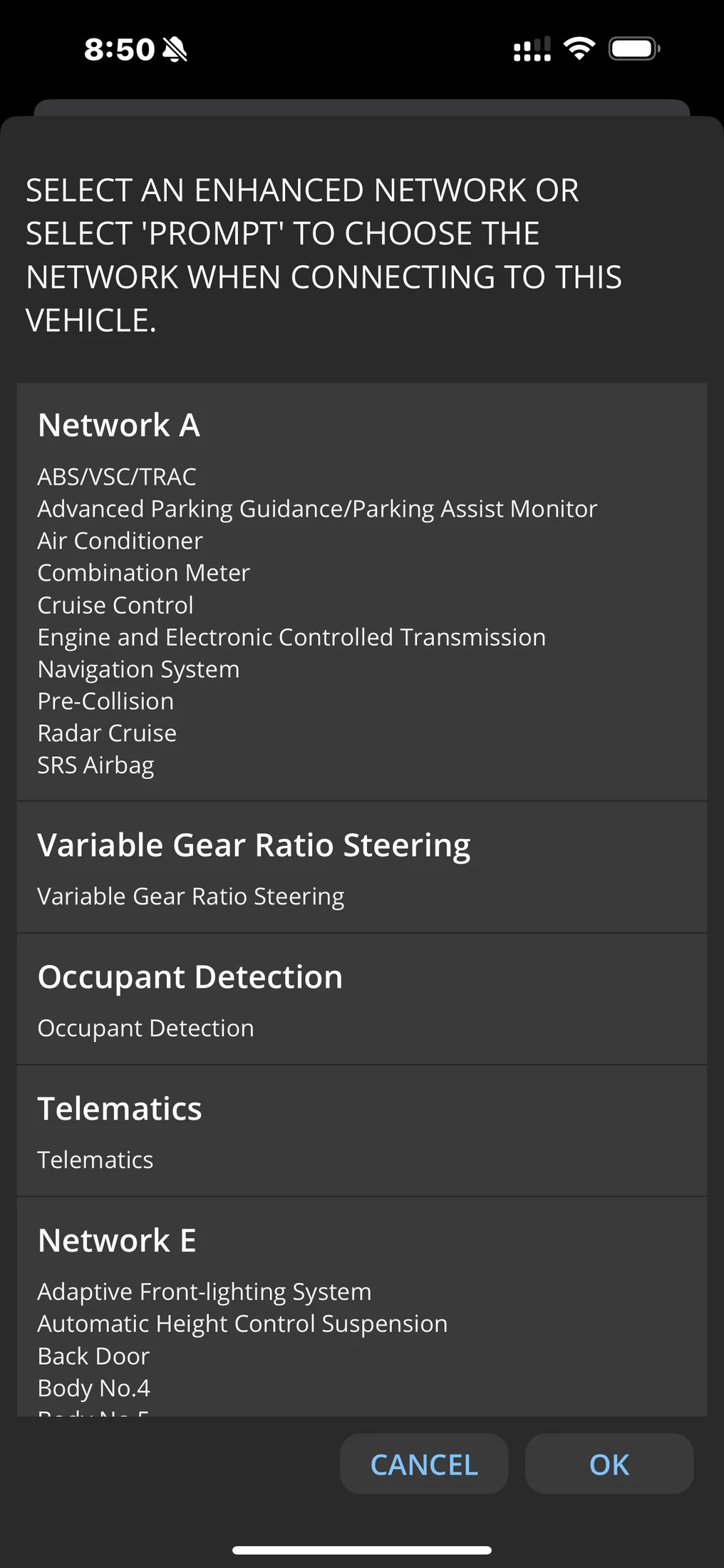

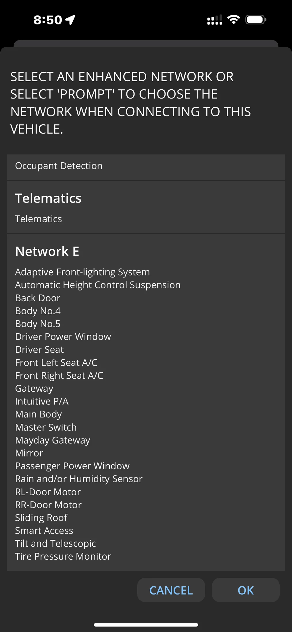

@lx200inAR what is “network E” used for? I’ll try testing that on mine.
@bloc My EVO would connect to Network A but not to Network E. You have to have the Toyota Advanced back to see Newtork E.
