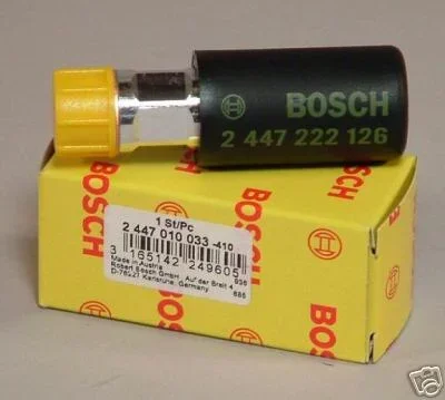

I know both the 2 447 010 033 and 2 447 222 125 Bosch primer pumps fit our Toyota B and 3B diesels. (From info I've got from MUD.)
And I am pretty sure that some Mercedes Benz diesels are being fitted with these same pumps.
Now my problem is that I'm trying to locate a replacement primer pump on the Internet and almost all the vendors are aiming their sales at Mercedes owners. So even when they are selling Bosch pumps, they simply say which Mercedes models they fit (rather than telling me the Bosch part numbers).
For instance one vendor says : "fits all Mercedes diesels 1977 to 1985 (except 190D 2.2)"
Another says "fits all MBZ diesels 1968 - 85 220D, 240D, 300D, 300CD, 300DT, 300TD, 300TDT, 300SD, 300CDT"
At the moment they seem reluctant to reply to my questions. (Or else are replying that they won't supply to NZ.)
Can anyone tell me which Mercedes models have the primer pump interchangeable with ours???? (If I know this - I can perhaps order one without having to ask them anything.)
Thanks in advance.
