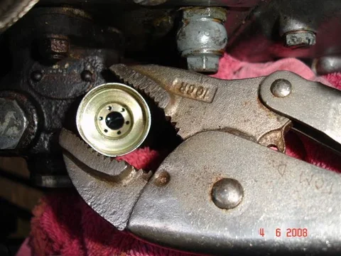

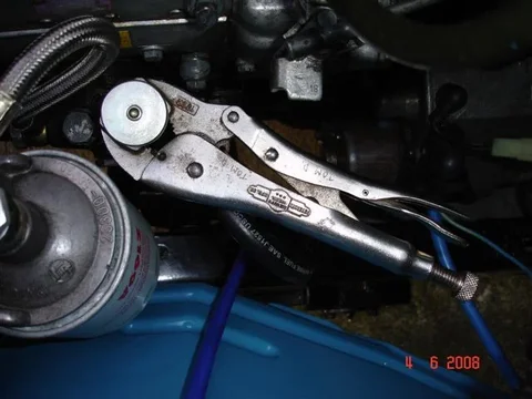

Since it is hard to get at "the hex" on this type of pump and since I have no intention of reusing/selling it, I used vicegrips (on the body) to remove it:
I was expecting some diesel to spill so I stuffed a towel in the space below - But I needn't have bothered. With the fuel tank only about 3/4 full and the vehicle parked uphill, none came out.

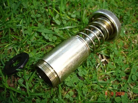

But interestingly - This pump is able to be dismantled. So all I did with my first attempt at removing it was to open it up at a threaded joint near its base:
And here is the top half:

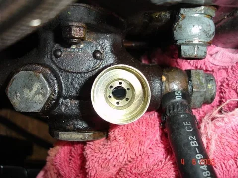

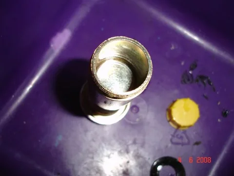

So here is me removing the bottom half. As you can see - I took pleasure in DESTROYING it:

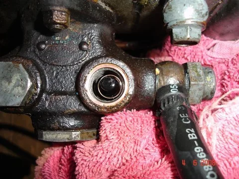

That left the old copper washer in the seat and I could see the stem of the black check valve (left in the hole) together with its return spring.
Needless to say - I was careful to ensure dirt didn't fall inside and I removed that old copper washer using the tip of my penknife:

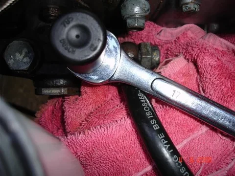

I then carefully fitted the new Bosch pump over the spring and valve stem (making sure the new copper washer was in place first - of course).
The new Bosch pump was FAR easier to install than the OEM-type because it requires only a 17mm spanner and the hex is long enough to enable you to angle the spanner upwards (to avoid obstacles) as you turn it. So there is no need for special "crow's foot"-type spanners here:

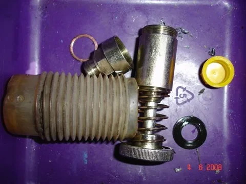

Here's the stuff I had left over.
I'll keep that "plastic-bellows cover". I don't know why really - I guess it's got something to do with the fact that I've always been proud that I've kept it when most are lost very early on in a diesel's life.
I was able to see why that old primer pump was "manufactured to leak". I can wobble the plunger around (side-to-side) readily within the body of the pump. And anyone with engineering background would know (in my opinion) that a seal can't cope with sideways movement of such magnitude.
In contrast, the top (plunger) of the Bosch pump can't be wobbled sideways at all.

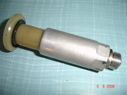

I've probably accidentally misled you in that the pump I've just removed was not OEM. It was a recently installed (7 months ago) "aftermarket" pump that has no brandname. The only identification that came with it was on the packaging box. (A toyota part number and the words "made in Taiwan".)
I'm sure you'll recognise this one. It is the one that was fitted to my vehicle by the Toyota factory in Japan:

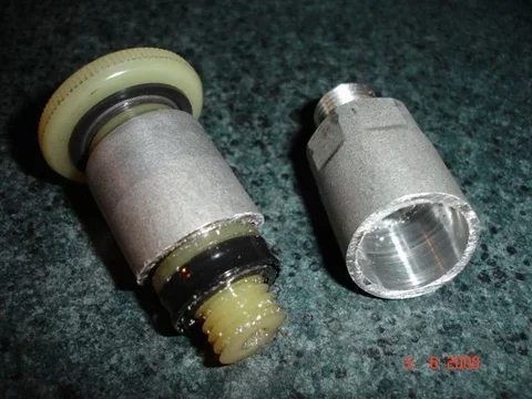

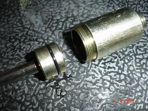

I decided to open up that primer pump (that I removed) just to check on the "engineering" in it.
Here a photo:
PS. - I was sloppy with taking this photo. The piston actually enters the cylinder when it is facing the other way from how it is shown here
As I suspected,it uses an O-ring on the plunger/piston to TRY to accomplish a seal while you're priming with it. (When "stowed" -the plunger/piston pushes that big black sealing washer against those holes in the base to seal them off. - So there's no danger of it leaking "while stowed". And I admit - some people may be happy with a primer that drips ONLY when in use.)
IMO - Using an O-ring (rather than a "lip-type seal") when the piston must slide such a long way is pushing your luck to start with. Put when the plunger/piston is such a sloppy fit in the cylinder -- it is nigh impossible. I believe ALL these "unbranded" primers will drip diesel during operation. (If not the first time you use it, then probably the second or third time you do.)
IMO - The cutaway view I posted earlier shows the sealing system in the Bosch is much more "engineeringly sound".

Bore: 20.2mm Piston: 20.0mm (Just using vernier callipers.)
So there's 0.2mm clearance Dougal. I know it doesn't sound much but when the piston is only 14mm high that amount of clearance allows it to wobble very noticeably in the bore.
But then again, perhaps I'm wrong to point the finger at "sloppy piston fit" as being responsible for the leakage?
I guess I really find it hard to believe that you could create a good seal when you're dragging an O-ring up and down a 20mm bore repeatedly over a 30mm stroke with a liquid as thin as diesel. The bore is not "highly finished" either. It has been cadmium plated just like the outside of the pump. (Well - Maybe a tad better finish - It looks like the manufacturer did spin some wet&dry in there - or did something similar. But it is NOTHING like the finish inside a new brake cylinder.)
