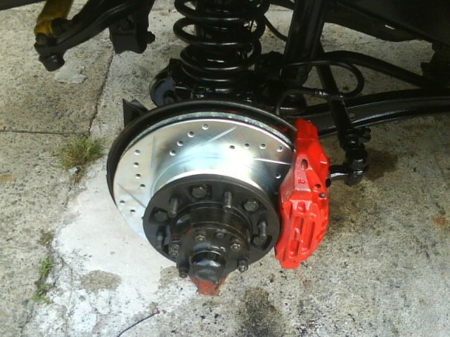

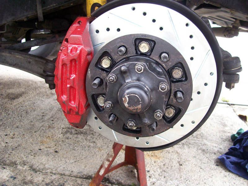

I have tried drilled and slotted super duper rotors and high end pads and now will only use Mr. T's.
