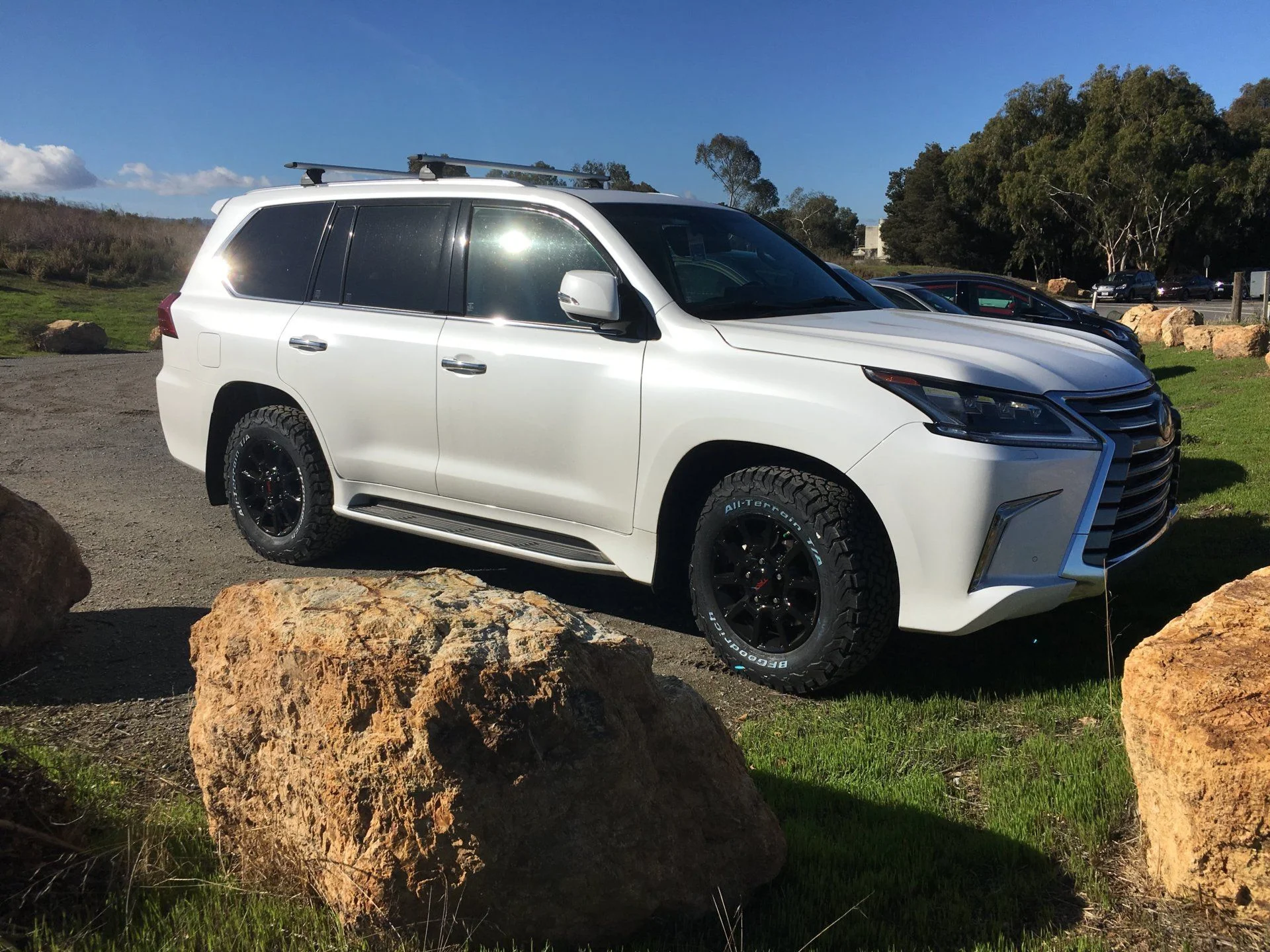

thought I'd update this thread to share some of my experience since I just replaced stock 21'' tires with new set of 18'' KO2. Originally, i was going to go with 285/60/18 with D rated KO2 per this conversation, but they were backordered on both tirerack and costco and i couldn't wait for that long as i'll hit on the snow road in Dec. so i took a leap of faith and ordered 275/65/18 E rated KO2. I had these tires for several days now and so far didn't feel much difference from stock tires in terms of ride quality. WRT noise, I could hear a little bit humming sound at low speed like 20, 30 mph, but didn't feel much difference from stock ones at highway speed, no humming could be heard maybe because it was covered up by engine sound. overall, very happy with these tires and will see how they are doing in the longer term.
share a pic with new tires/rims :)
