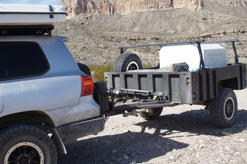

Although this solution works just fine with no issues, I have developed a need to mount something else on the backside of the drawers. I couldnt find any 200 pictures, but it is the same bracket on an ARB Rear Bumper as a 100 series so I am going to give this a try. I can always mount it across the front bumper

Allrighty then. I installed the ARB Bumper Hi-lift mount. It is the same part number for the 100 and 200 series
I took off the bottom plate of the hi-lift because it would have rattled around and it has a very easy pin holding it in place. That goes in the drawer
