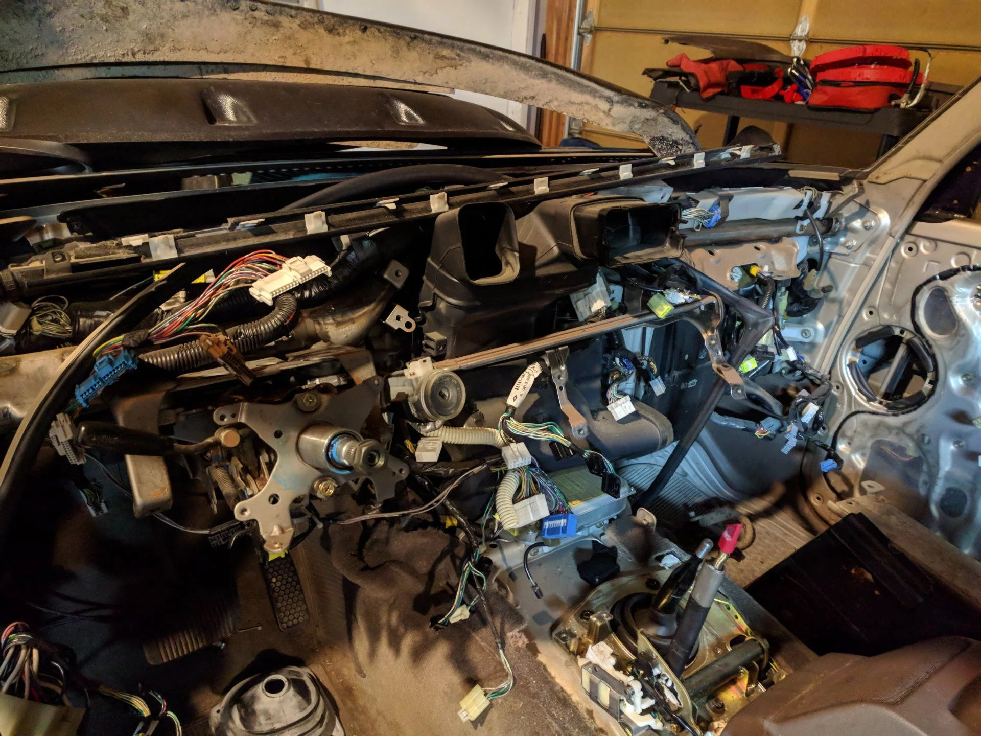

im working on it now taking the dash apart and ill try the radiator shop, i cant find an aftermarket front only the rear
