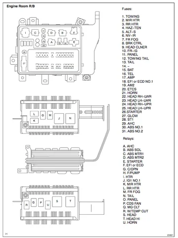

Hi,
The low headlights aren't working on both sides.
I suspect the relay (bulbes and fuses are ok) but I am not to know where it is.
The toyota diagram shows it is the S relay:
I wonder how to access to this one:
Do I need to unclip the upper box (where all fuses [and some relays] are)?
Thanks!
I own a 2005 HDJ100 (diesel 4.2).
I can see clips on the fuse box but some of them are hard to 'unclip'. So before I try to take appart the upper fuse box and look what is underneath I would like to be sure if I have a chance to find the relay in question.
Hey Tibo, did you ever get an answer for this? I’m looking for the same relay.
Whoa, that sucks it looks like they are surface mounted?
Edited: I am mistaken, my 05 100 series has the hidden SMT board for the headlights. Man what a pain if I ever need to fix that :(.
