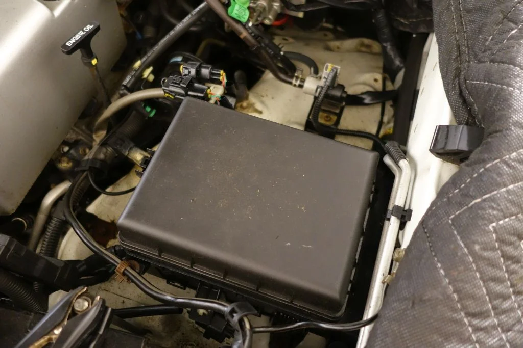

Remove the top cover:

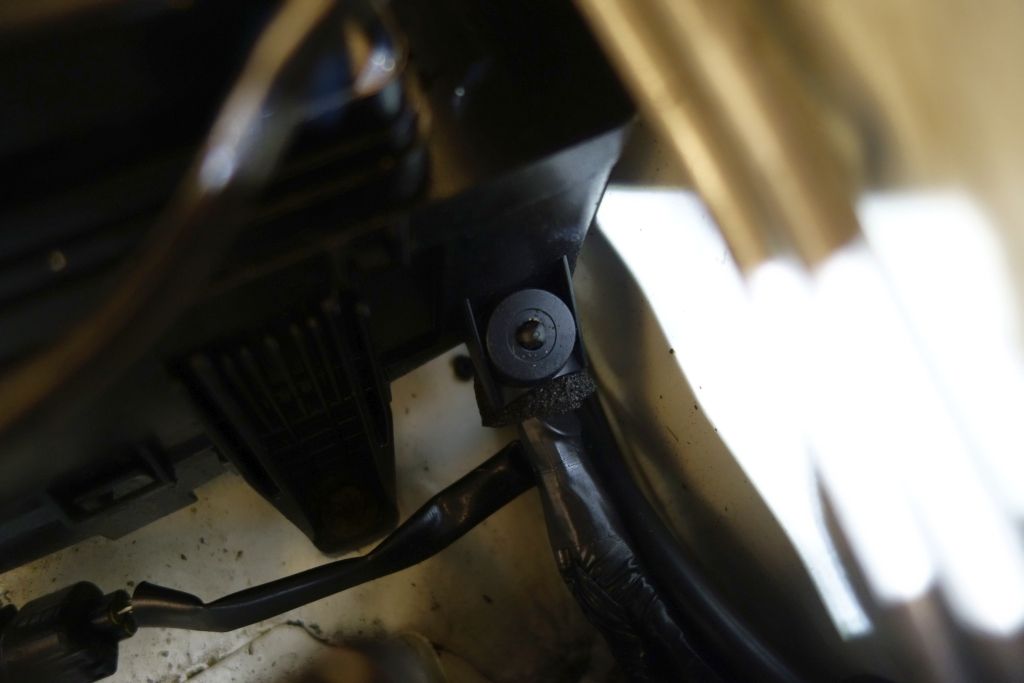

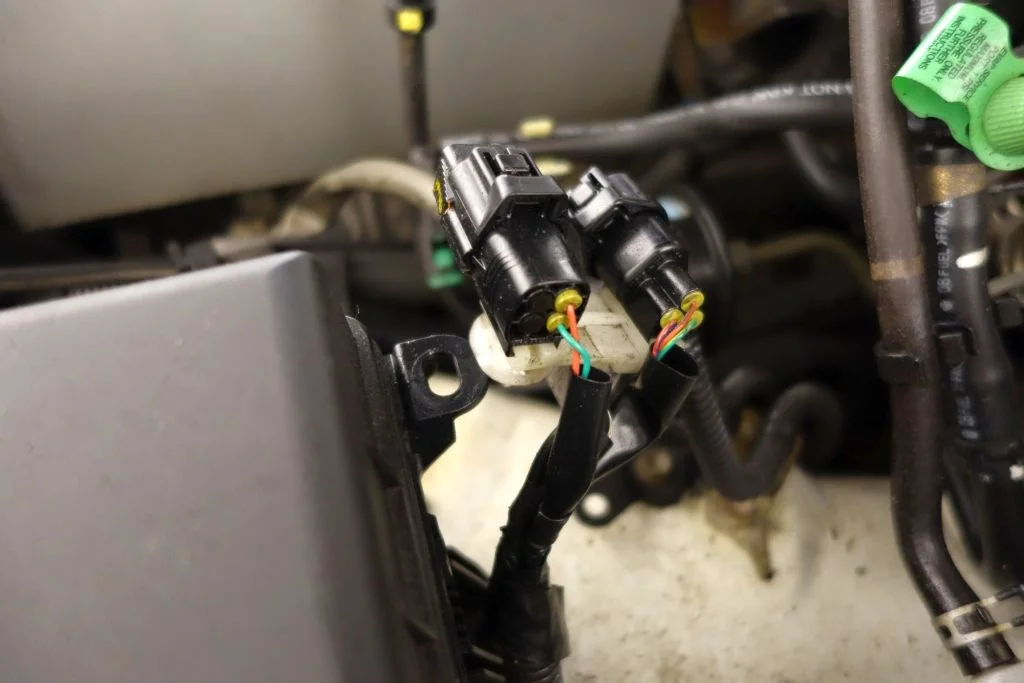

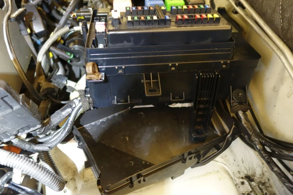

Remove the four bolts holding the assembly to the engine bay, including this one hiding beneath the AC lines:

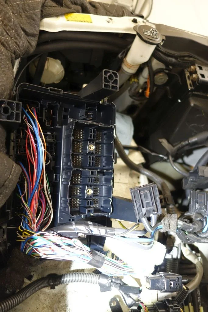

Remove the undertray by unclipping it from the main assembly and slide out:

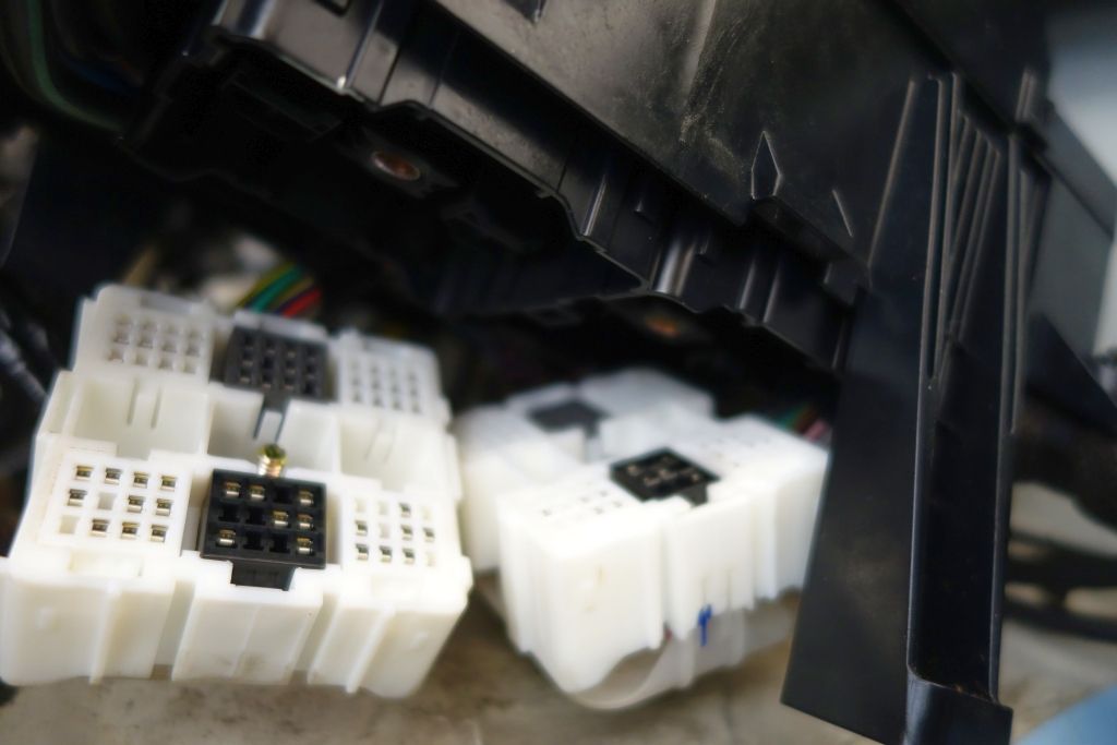

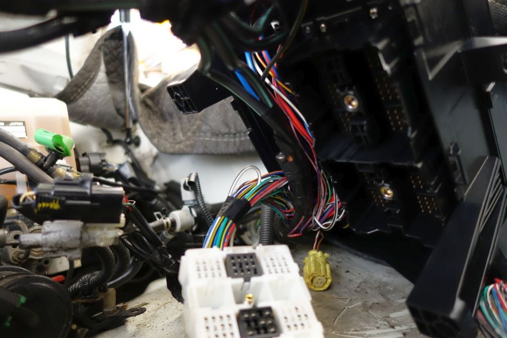

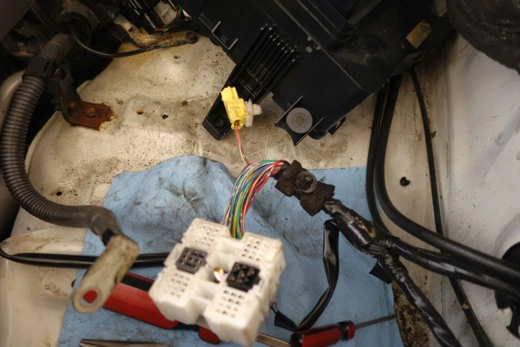

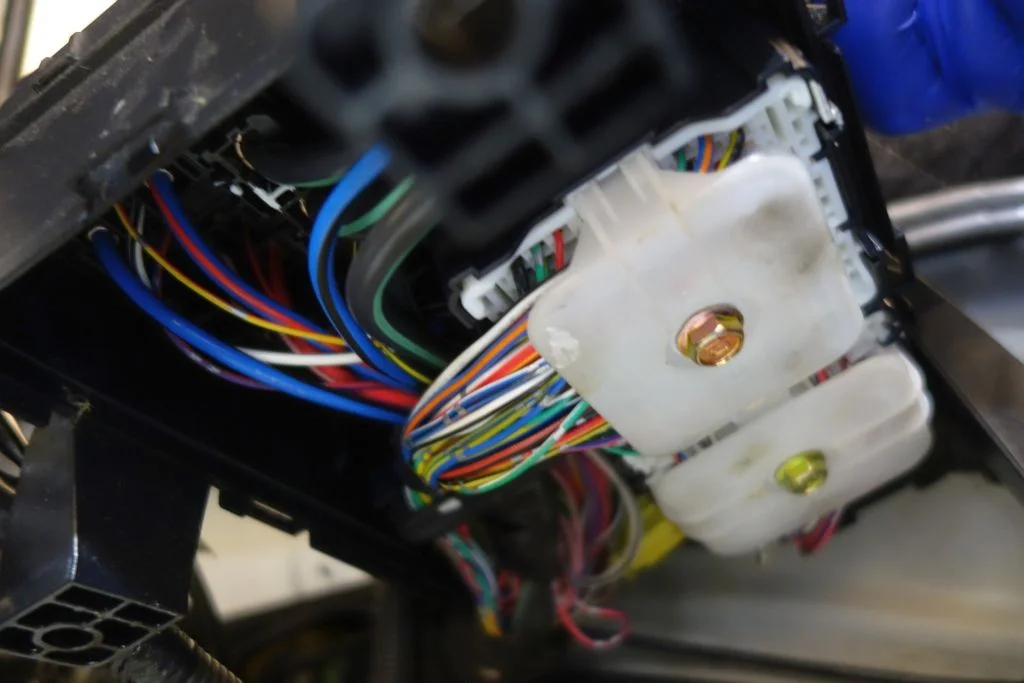

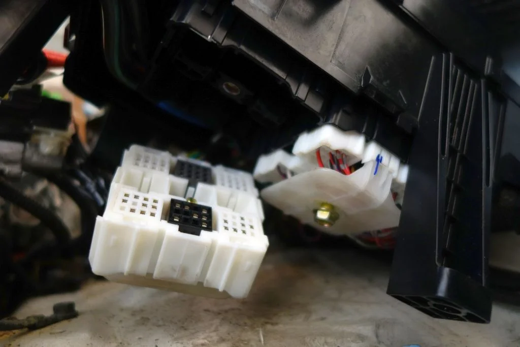

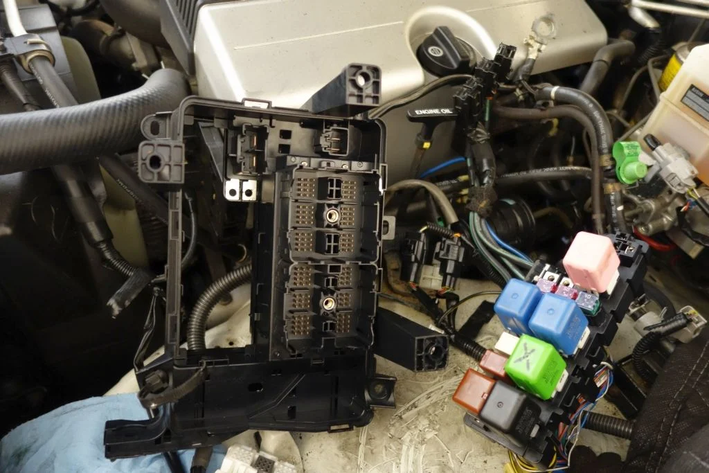

The big wiring bundle is held by a large black U-clip that is released from the top. Once that is removed, the entire wiring harness is free from the junction block. The relay block can now be removed by unbolting the two small allen bolts (3 mm):

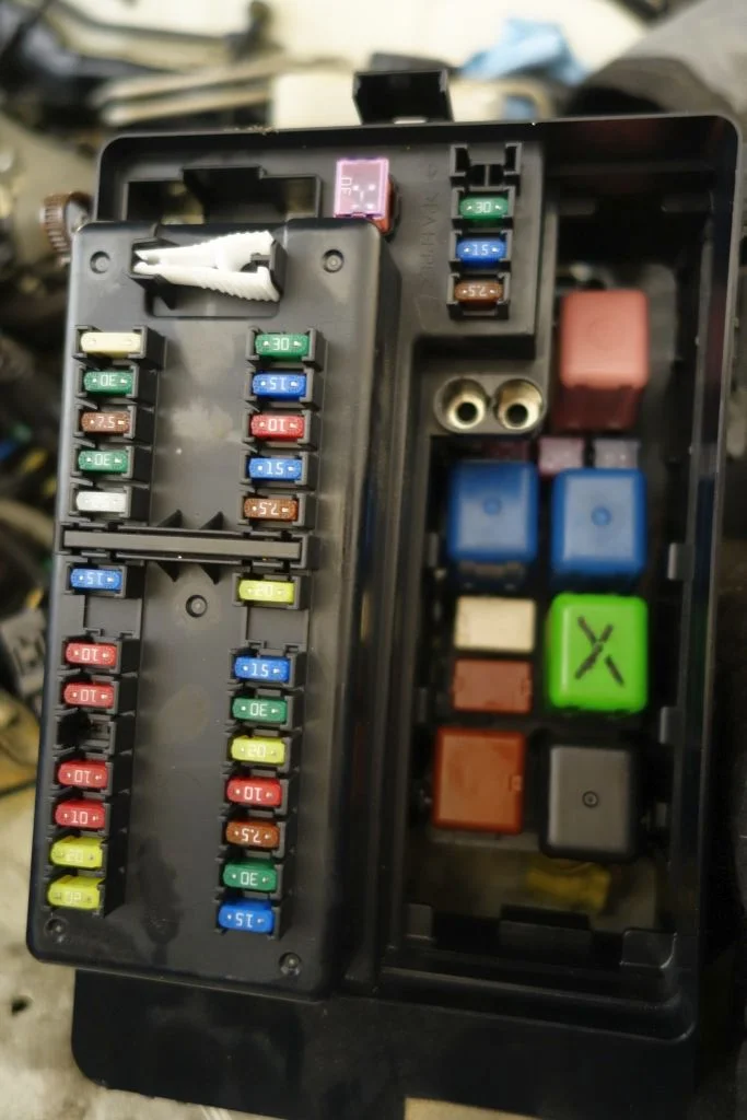

There is a Relay Block (RB) within the Main JB, where you can easily replace relays (clearly shown in photo above). There are several more inside (including the AC MG CLT relay) the Main JB itself that, according to Mr T, are impossible to replace individually.

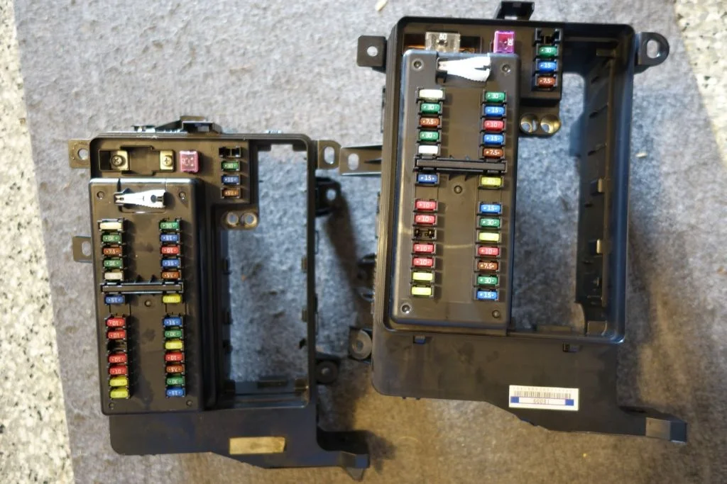

You pop those clips holding the top half onto the bottom half, it then splits. Easy.
