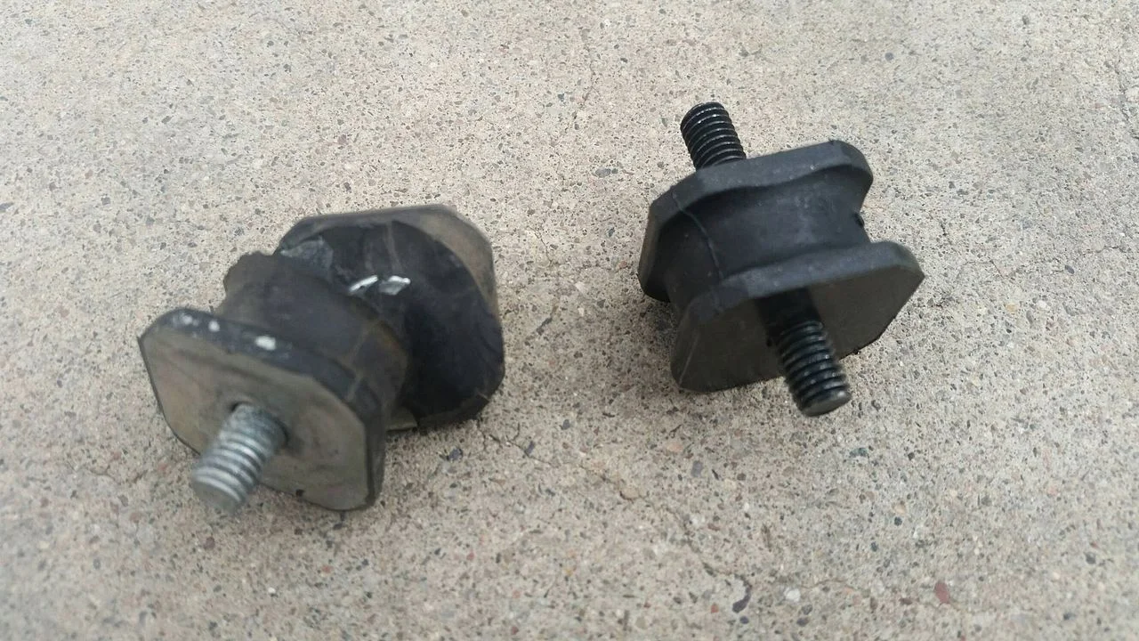

where can i get these clips and bolts ? anyone have a part no ? (1 Viewer)

where can i get these clips and bolts ? anyone have a part no ?2000 land cruiser
The clamp around the AC line with the rubber isolator is refrigerant pipe clamp 88718-60880. It doesn’t come with any of hardware.
That is correct, and you can reuse the hardware. One of the first thing I did when I got my LX470.
Very common for the rubber part the split in two. Unfortunately, it is molded to the bracket so the entire bracket needs to be replaced instead of just the rubber part.
The rubber part can be replaced, not exactly the same, but good enough for me.

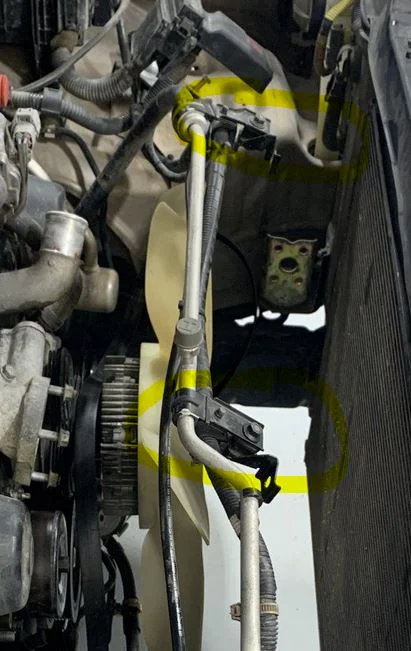

can someone post a close up picture of how these are mounted to the rad? my current setup was ziptied by the previous owner. Thanks!
