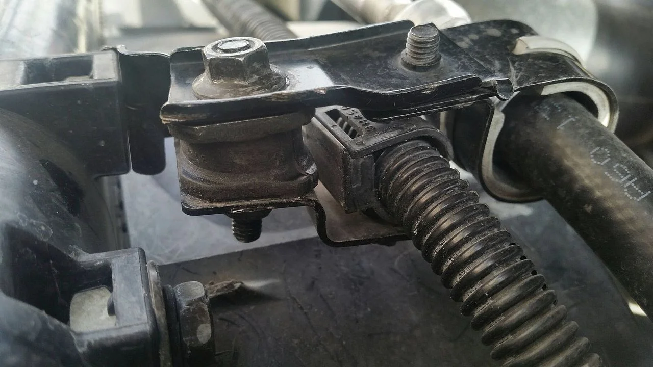

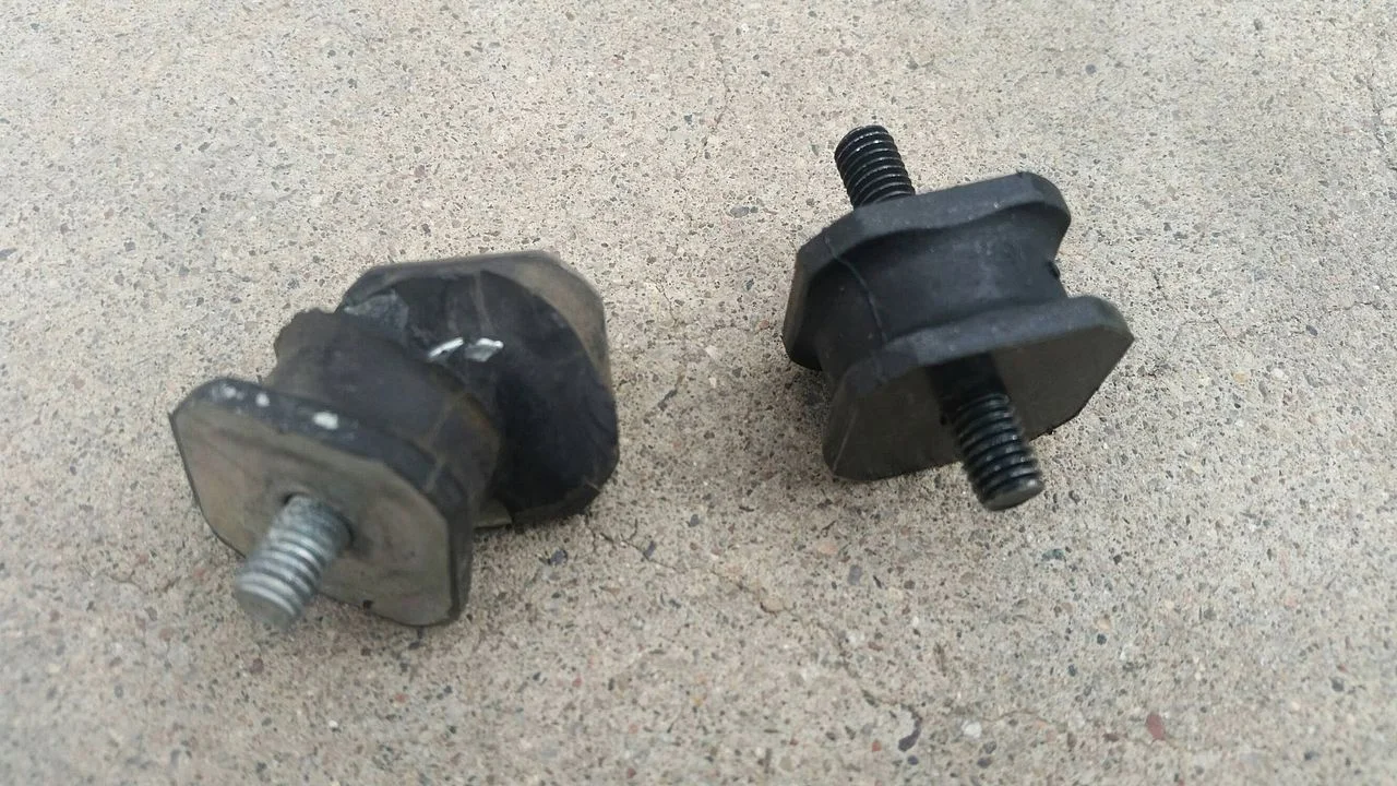

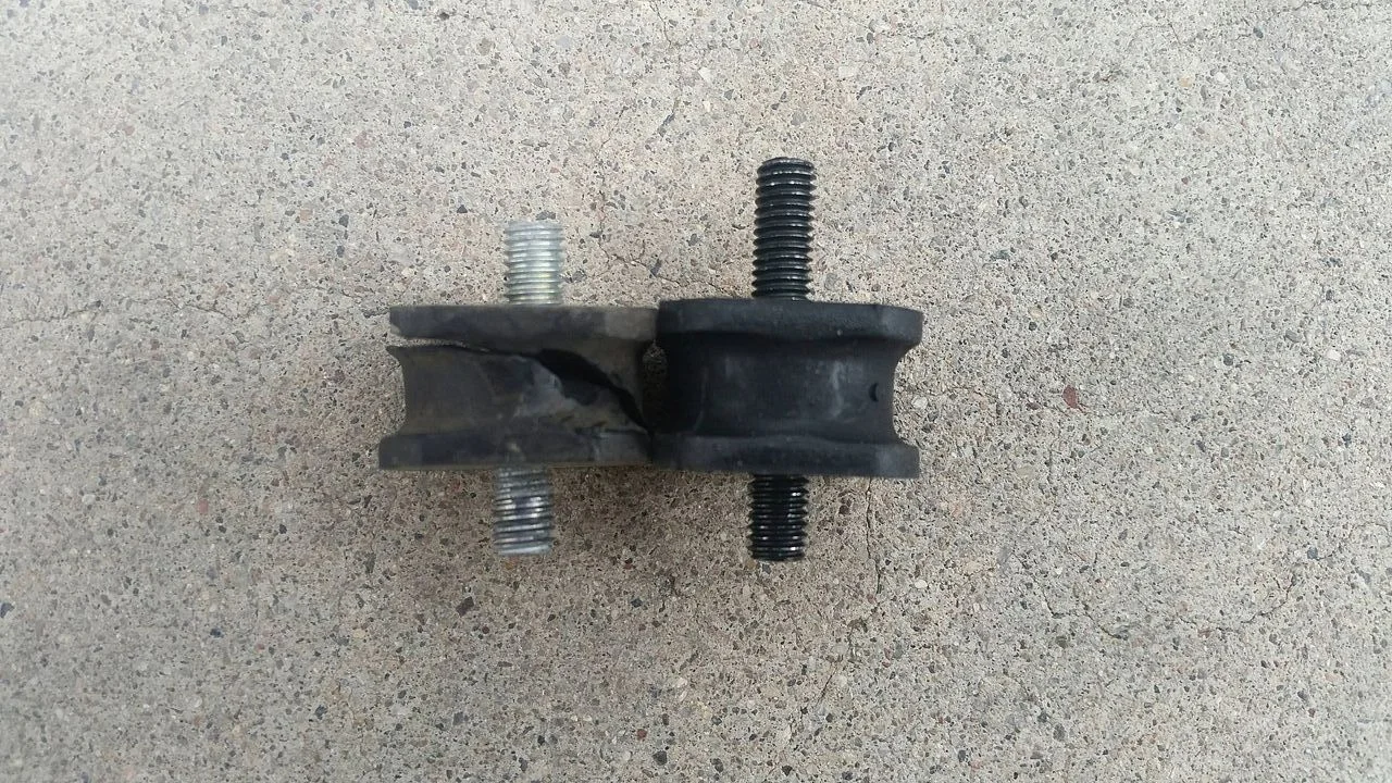

One of the insulators for AC line above the radiator broke and I don't want to pay $40 for 88718-60880. I found this Toyota part that works good enough for me. The longer thread on one side is not a problem for this application. Part number is 88467-30270. It costs $1.11 from my local dealer.

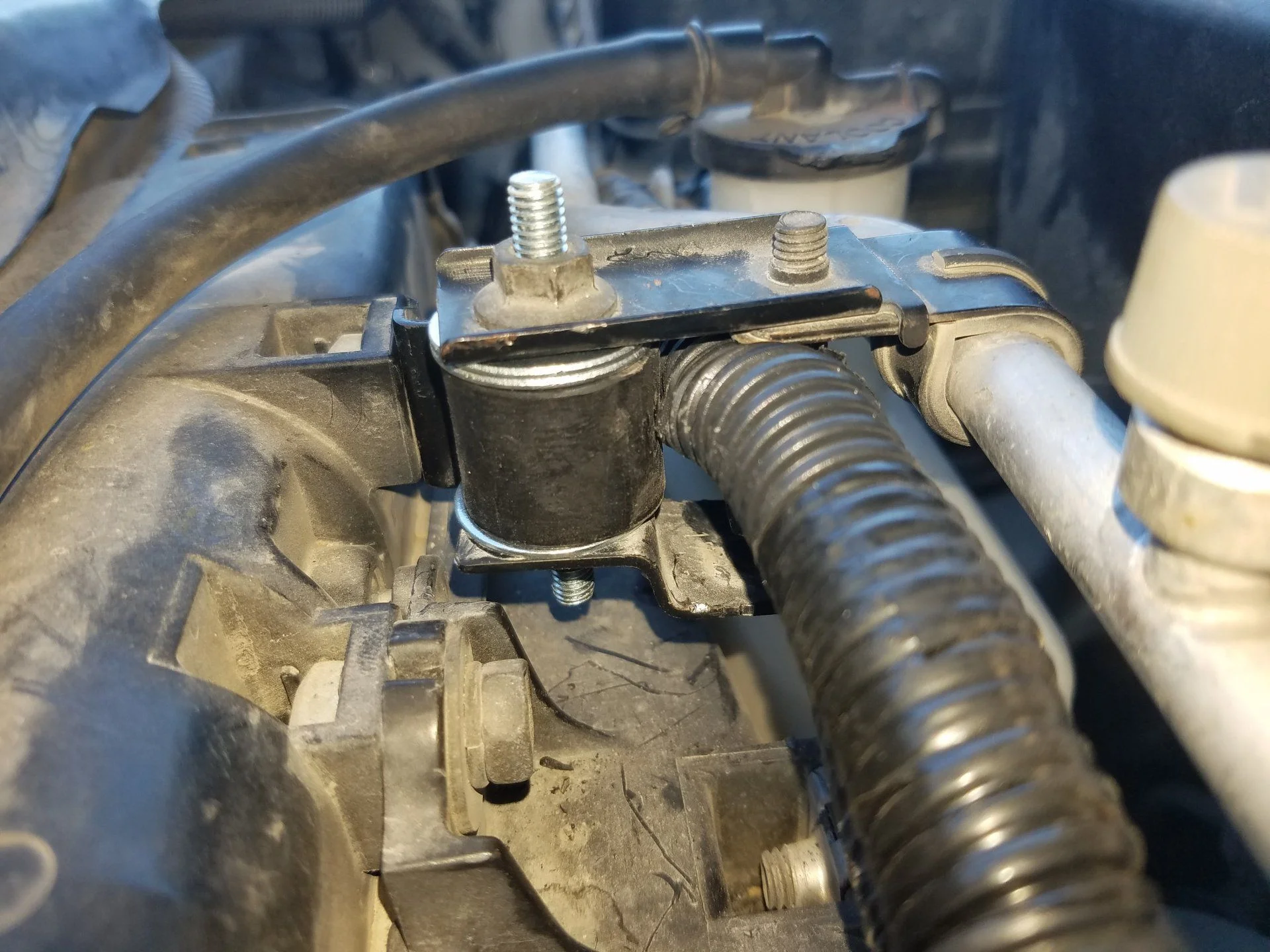

Edit: I got the Amazon isolators linked above installed on my LX today. They are a little taller than the OEM rubbers and I stacked a couple of fender washers that I had to give me a little more clearance for my HID wiring harness that runs through the bracket.
The threaded end sticks up a little higher than the originals but no issues and plenty of clearance beneath and above without touching anything. Will see how long they last.....
