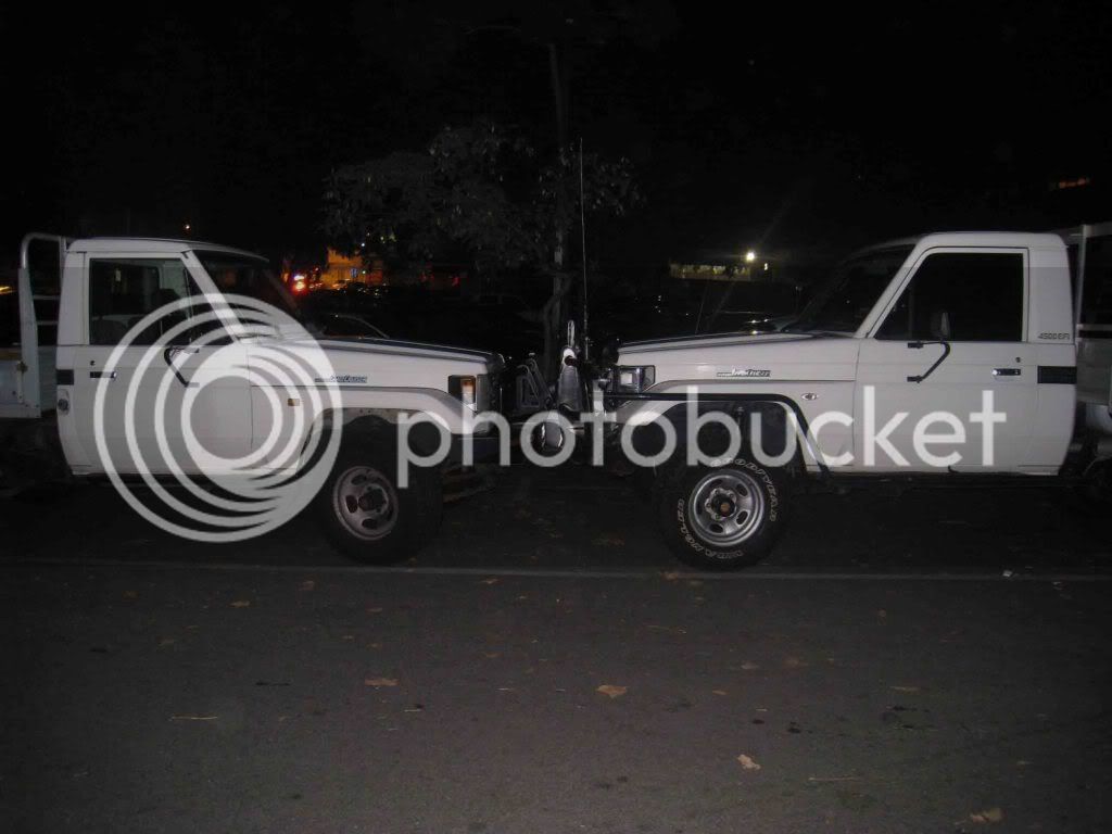

The are off the 105 series and are steel and a 5 lug ,they are off / you will find them on the Aus model 105 series GXL which is actaully a GX and toyota Aus badge them as GXLs,which are the model below the VX,they also come on the post 99 Cruiser 7x series Which share the same stud pattern and off set rim as the 105 series,
this is the 5 stud
On our GXL (gx) 80 series the come with a rim which looks very simular but is 6 stud
I have seen some 105 series alloys on a 100 series and the wheels stick out past the wheel arches
80 series 6 stud on left 105 series 5 stud on right
Also to answer your questions theres loads in Aus :D
Factory steelies
