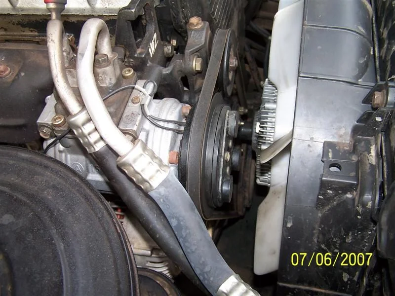

finally got my idler pulley bolted up and the compressor clutch pulley only needs to come out 1/4 of an inch, so i'm optimistic about finding another clutch that will fit. i'll post up what i find.

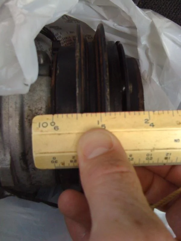

i'll measure it tomorrow and let you know. it's at the shop right now.
Do you know what your 1HZ came out of and what year? You need all the bits from a 70 or all the bits from an 80 series.
I think they changed the 1HZ compressor in 98.
Measure it like I did to get 67mm and see where that would put it. Maybe a 7*series pulley and clutch would bring it to the right spot.
The brackets look different to mine.

dang. I don't have the idler pulley to measure for sure.. BUT, I think that the one I need is 3.75". And I think an 1FZ is 3.5"
Might be time to just... build a bracket? or modify the bracket you have.
