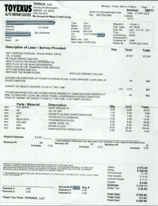

90K and again at 120K about 2 months ago, I bought w/ 84K in 2018 and don't think it had ever been done.
Lexus dealers will not replace since they call it a "lifetime" fluid so I found an independent Toyota specialist
Did you happen to see what the ATF looked like? Also, your receipt indicates 4 liters, but another member just wrote that the capacity is 12 liters? What is the difference? Do they just drop the pan for the smaller quantity replacement?
It's time. And note that you should probably do a full "fluid exchange" (~12qt) not just a drain and fill (~4qt, only 1/3 of the total capacity). Some people refer to it as a Flush but to many shops that implies forcing fluid and cleaning solution through the system.. you don't want to do that.
Great, but how do they do the fluid exchange without some type of flush? I mean, what should I look to ask the the mechanic. I see that one member just posted his receipt, but it looks like only a drain and fill with 4 qts. used.
I'm still shaking my head trying to figure out how the "Toyota specialist" managed to complete an engine oil change w/ new oil filter and only use 5.5 quarts of 0w-20 oil 🤔
Good Eye 👀, as soon as the tech started it to back it out of the bay when I arrived the low oil warning light came on so he added the ~ 2 quarts before I left the lot, didn't make me feel confident in their work, will I DIY or look for somewhere else next time, most likely ;)
