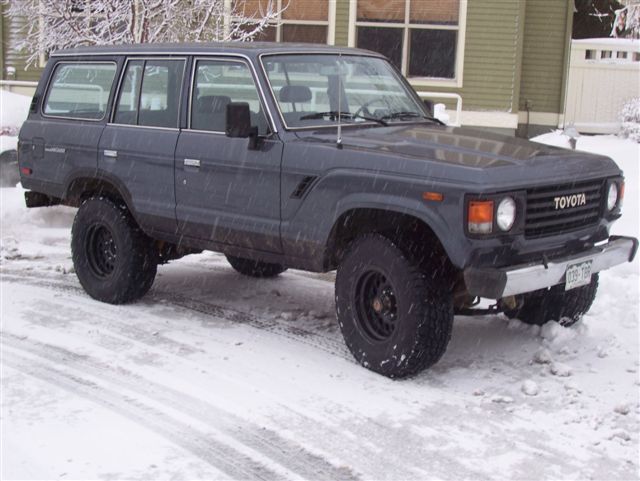

Yeah, this is what I get for being a cheap-o. I saw a set of 5 for $300 that should have fit and bought them instead of spending $600 on a set that does fit. Real nice Clark.
Pro Comp Xtreme Rock Crawler Series 98
Part Number 9898-7983S3-5
9x17 3.5 BS
No rubbing caliper or tre, 83 FJ60. No spacers yeah.
http://www.summitracing.com/parts/pcw-98-7983s3-5/overview/

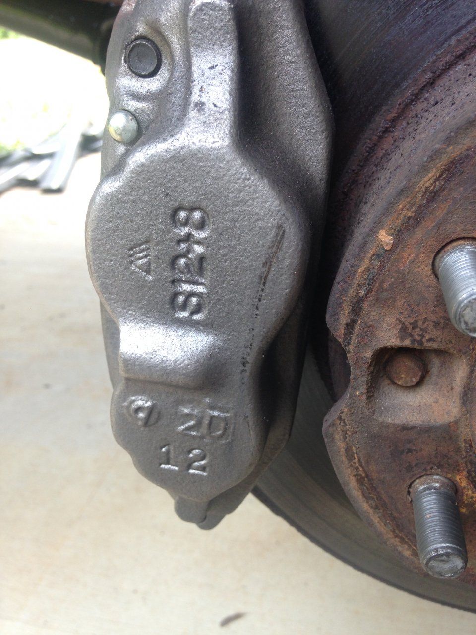

one thing I just discovered...if you have the front disk brake calipers off a 4runner, they must be a tad bit wider than the stock 60 caliper. So you either need a 1/4 inch spacer on the front with these wheels or some do some light grinding on the caliper for clearance. I have the same wheels just got to screwing around with them today on my 86 fj60... I put on the only 1/4 wheels spacers I could find in town. I'm running 17 inch 12.50 Toyo all terains. The above wheels only took 4 months to get to me. The front wheels just barely "kiss" the caliper when the lug nuts are tight....but they do and so you have to make some choices.
or apparently go back to stock type front caliper....

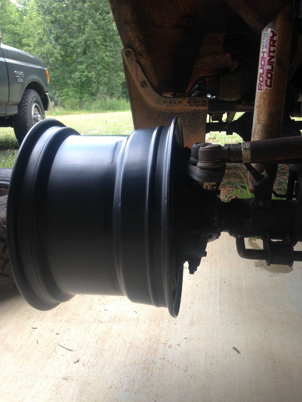

These worked. Barely enough space for d window and caliper, but no issues. PCW51-5183F 15x10 3.75 backspace

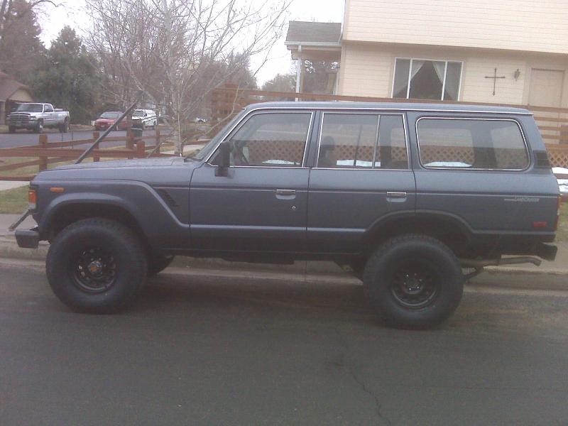

Does anyone recognize this setup? Wheel/Tire size and suspension type please? I'm very curious about it and can only find it as a Pinterest pin. Any help would be MUCH appreciated!
Not enough lift to clear those tires. Probably stock springs.
Looks like an 8-hole alloy wheel. I'd guess 15x8. Maybe these?
Tires, probably a 33x12.5

Those wheels do not fit without the use of a spacer.
just grind down the caliper, its no big deal

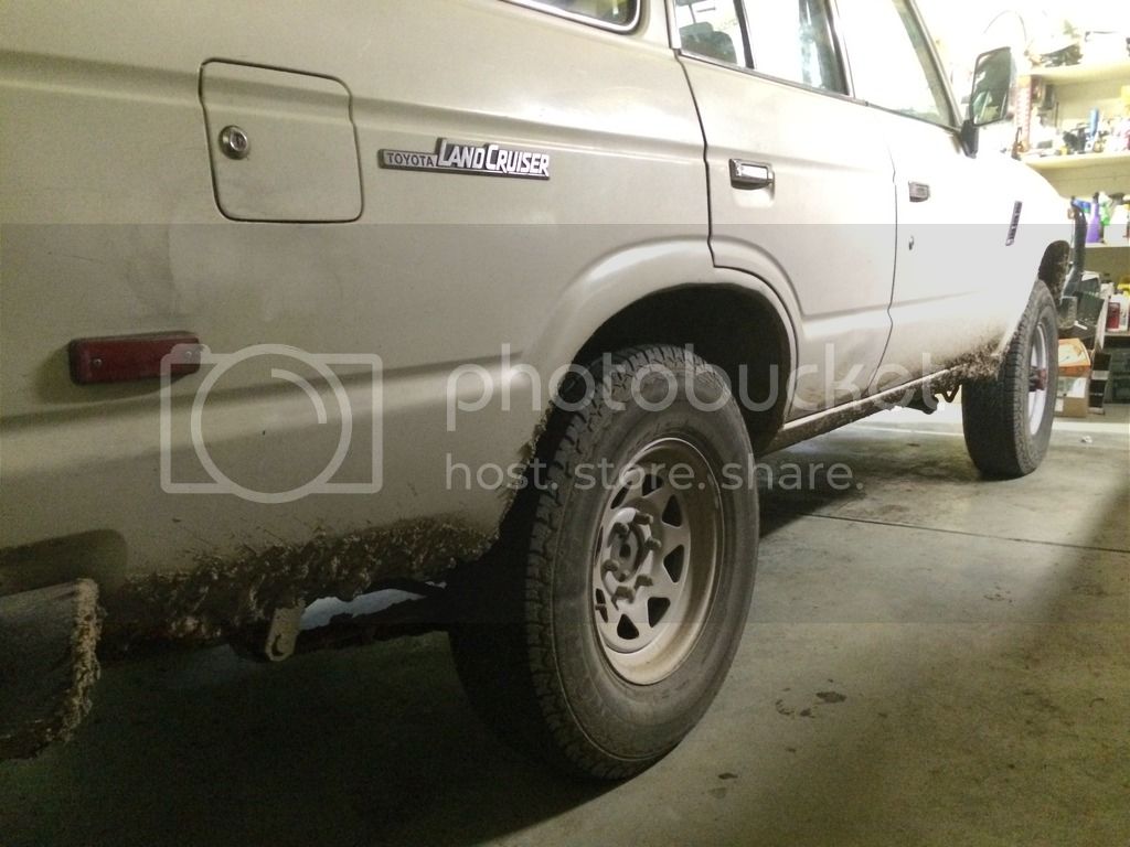

These are doing the trick for me. 16x6 with 235/85r16's. I actually picked them up for my '40 but since it's a ways from being roadworthy they are the '62 which came with bald 32x9.5 swampers on stock wheels.
Dexstar 16x6 steel wheels, PN 017-144-12. Fit with no mods and the best part ....all of $37.44 each.
15X6 655 White Spoke | 017-144-12 | Nuera Trailer Parts
I Got them from a local shop for about $40 a piece. So, $160 for wheels, and you can get a set of 4 BFG KO2's in 235/85 for $580 shipped from 4Wheel Drive Hardware. Can't beat that combo for $740. (I was going to buy a set the other week , it was $536 shipped last time I looked, but the prices went up! Dang! I bought the wife a set of Blizzaks for the 4Runner instead..)

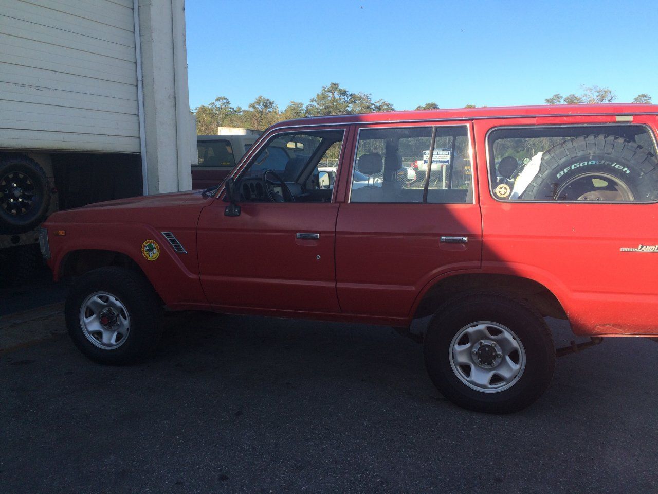

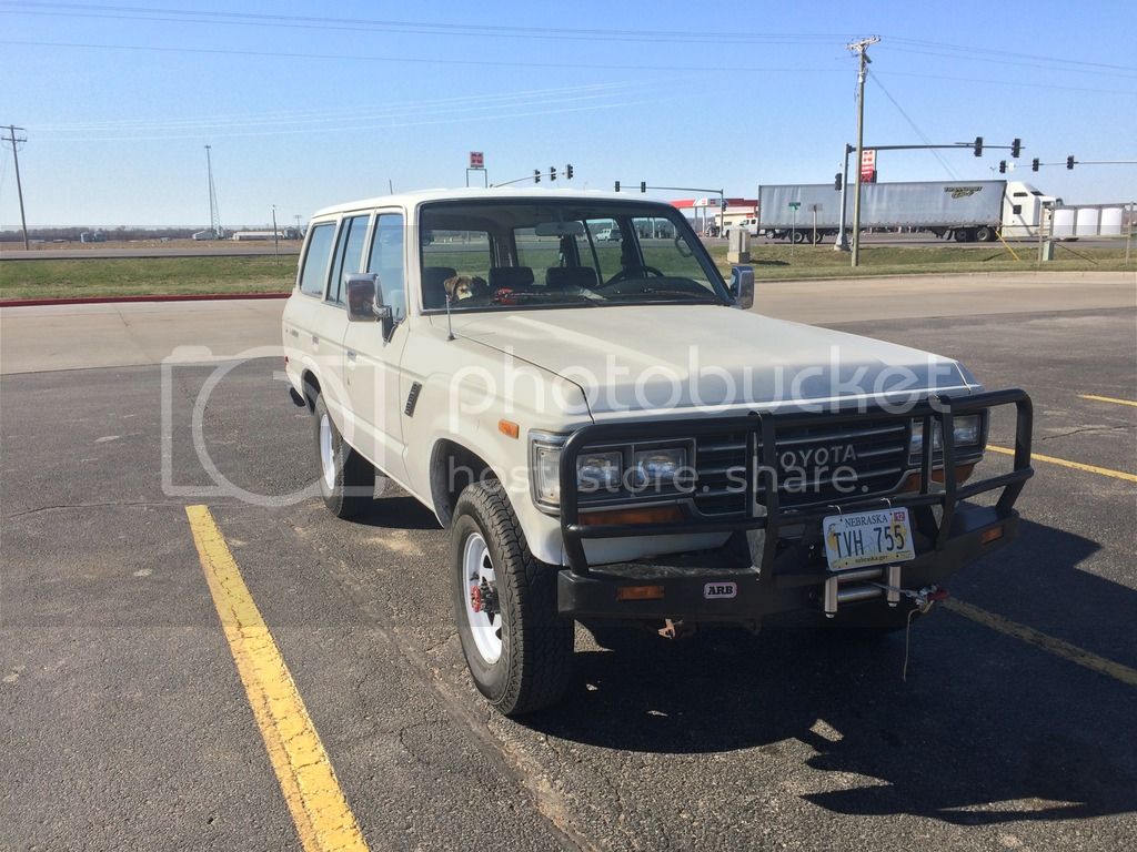

Friend just bought a 62 with these wheels...anyone know what they are? Tires are 31x10.50R15. Sorry for the quality took pics at night. Thanks,
