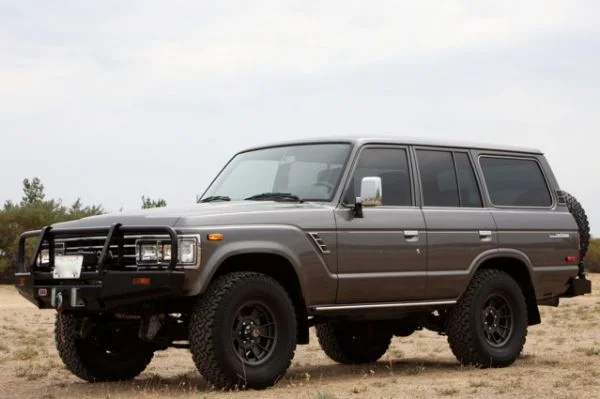

people have done this set up, but heres mine.
- Old man Emu light lift.
- SCS F5 wheels 16x8 3.5 bs.
- 285/70r16 k02 all season

i have a 16x8 3.625 backspace rim on my truck and they just fit without hitting the tie rod. do these 3.5 backspace rims work without spacers? i want some for my summer tires just don't want to run spacers
@franklin40 are you thinking of backspacing backwards or am i :idea:? the lower the backspace, the more poke, the more poke the farther from tie rod. I'm .125 inches wider then you.
i like the width of the front, but i wish the rear would stick out another half inch just for looks. i don't think they make half in spacers because the lug bolts would be to small
Looks good :cool:

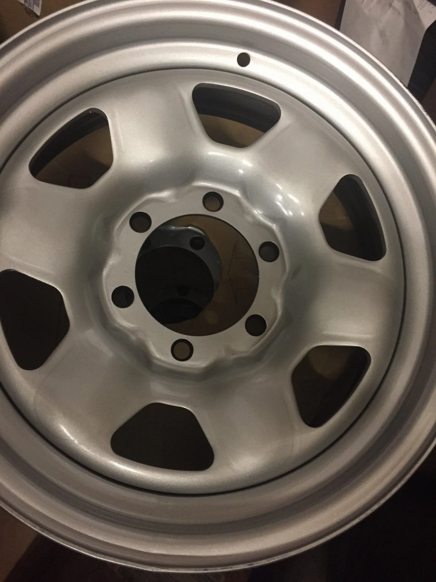

I'm a big fan of the 60262's, I run them on a few Cruisers.
I'll have them on this soon too!

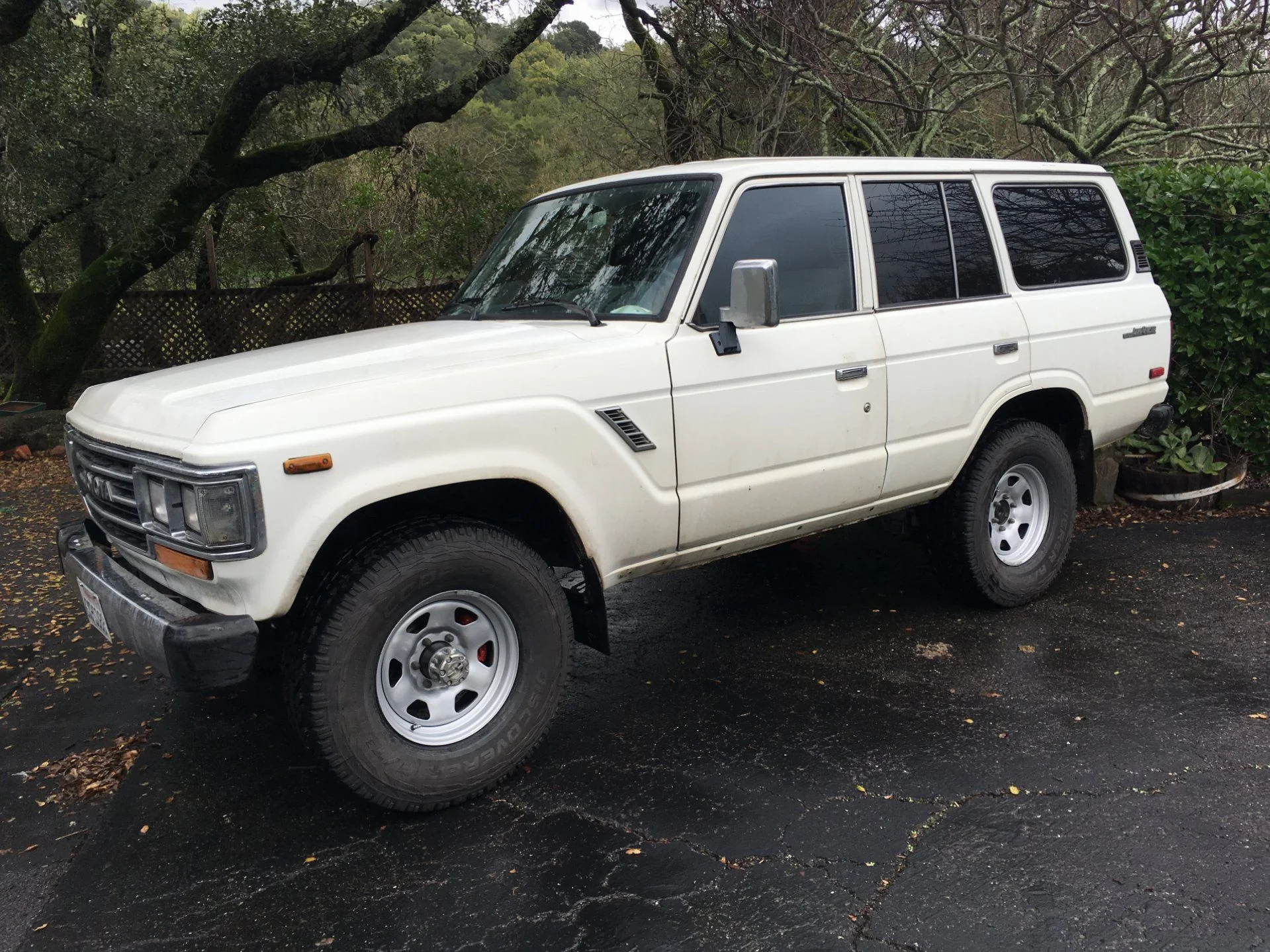

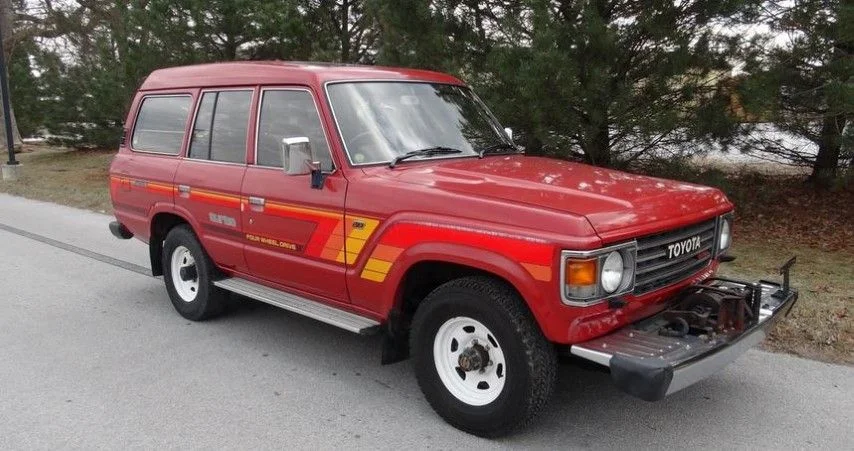

Ok folks-Got the 70 series 16x7 oem Toyota wheels mounted up. They look great, if I do say so myself.
Black powder coated 15" oem 60/62 wheels currently for sale in classifieds, and gray summit racing/wheels vintiques steel smoothies 16x8 for sale soon!
OK, a photo:
Note - the 3FE, H55f, FJ62 transfer case, and OME suspension have not yet been installed, but it gives you general impression of how they'll look.
That's it this picture has made my mind up. I am ordering 5 of these instead of 5 split rims from my buddies Saudi FJ45! Can't wait to get these on my
60 with some new Toyo sneakers.

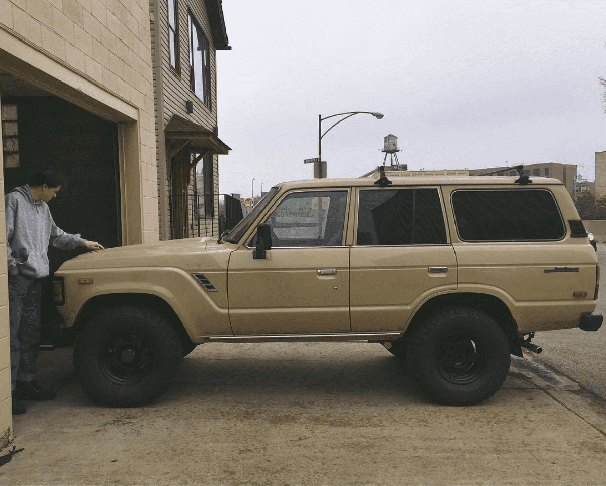

After approximately seventeen and a half billion reads of this thread . . .
Wheel Vintiques 16x7, 4" backspace from Summit Racing. Part #12-670604
Powder coated with #7037 (need to double check this #)
BFG KO2 235/85/16
Some weird OME leaf pack that nobody understands. To be x-heavy plus in coming months.
Don't mind the stink bug. It's not as bad as it looks and will be remedied during ^^
cid:52D33D6C-0691-4EF6-AE08-0EA1D298D4D3
Oh, and . . . TorFab! Competent, efficient and great to deal with.
Looks great!! Ordering those wheels soon. Looks like RAL color 7037. :)
