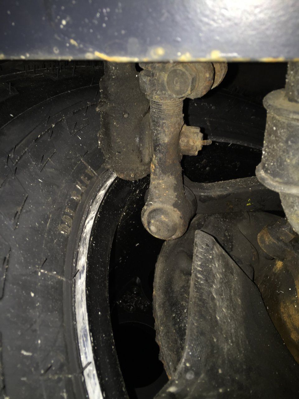

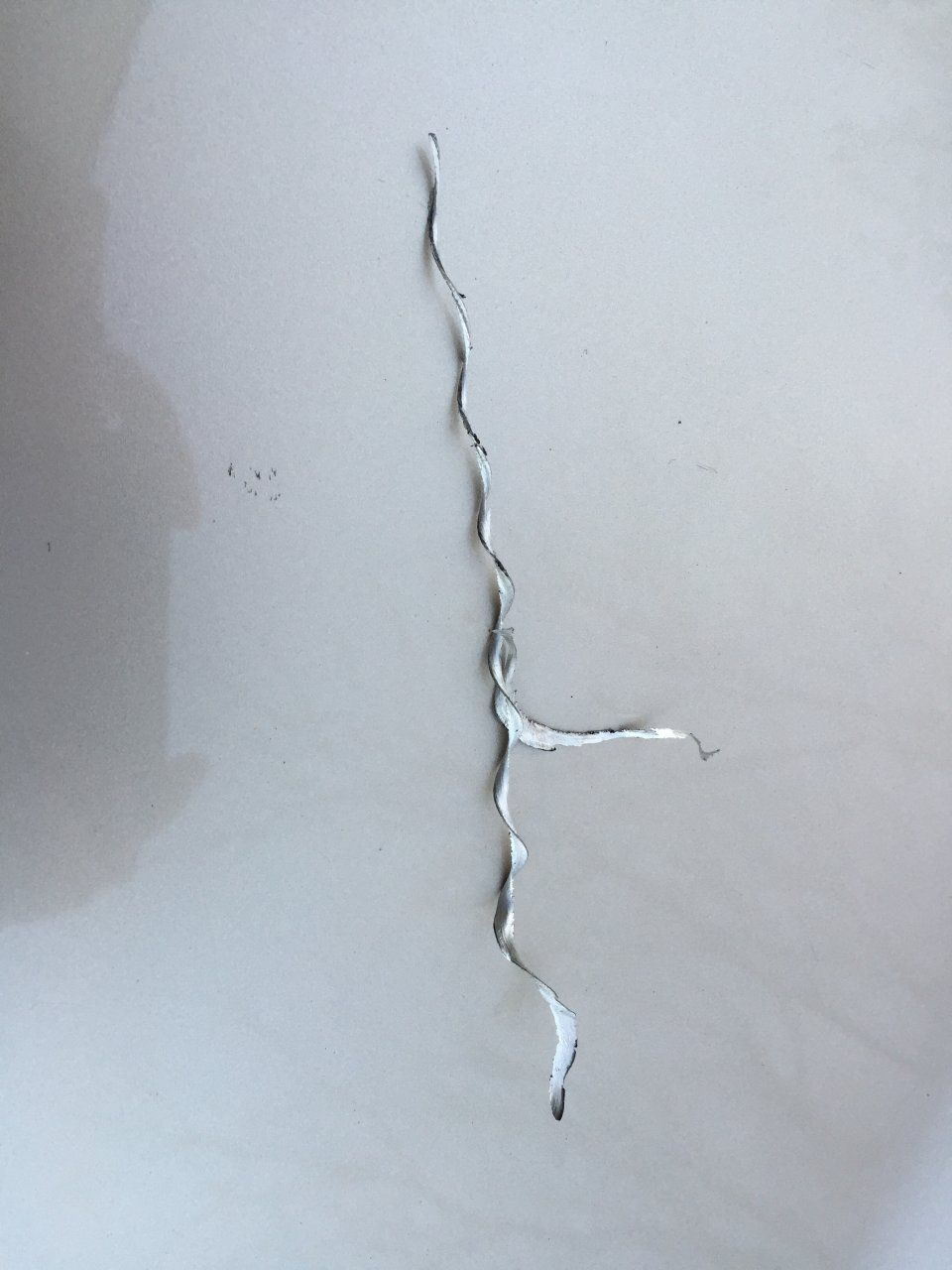

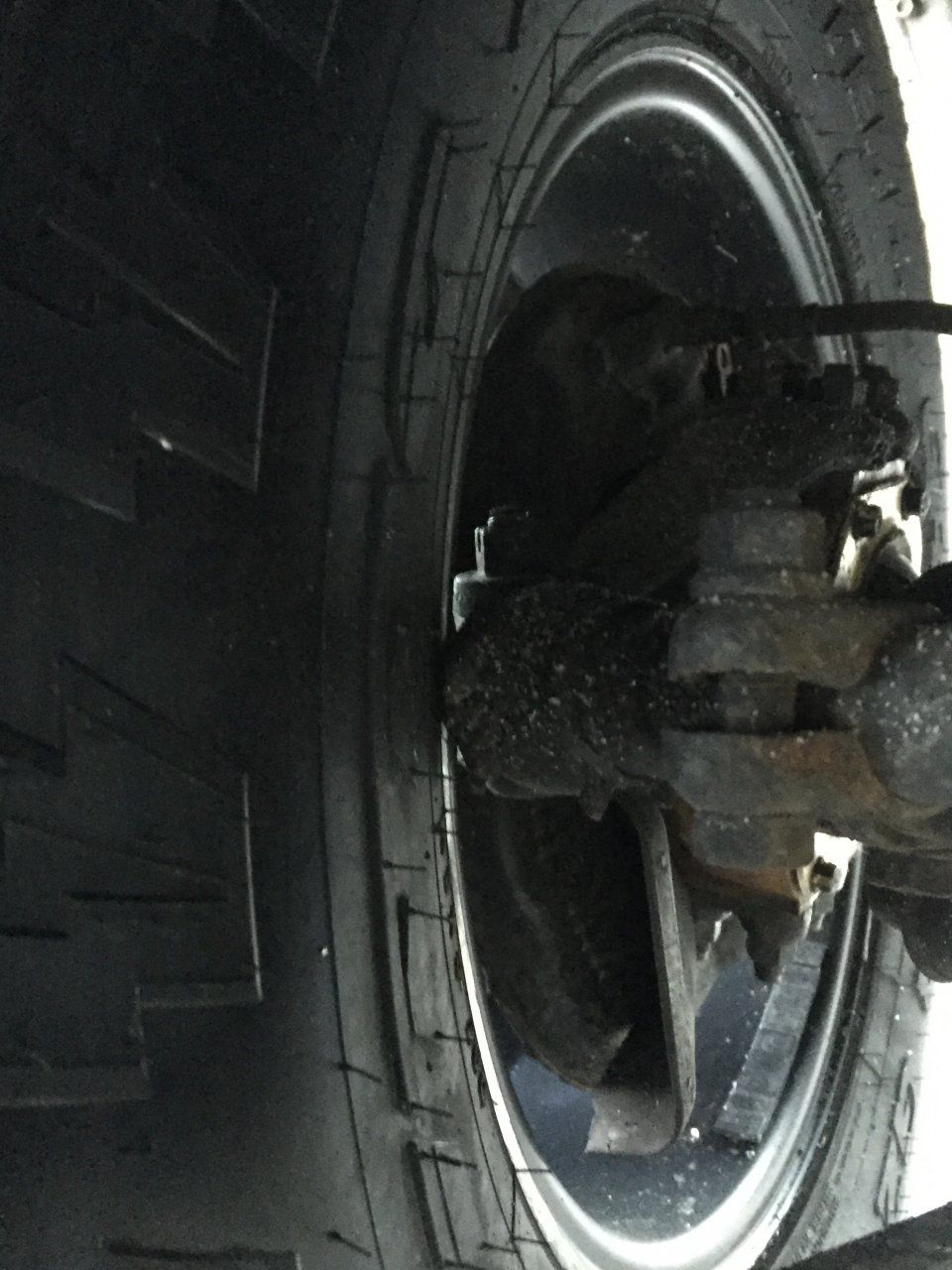

The 17 inch trackers are rubbing on the passenger side. A few left turns quickly shaved a piece of the wheel off. The shop I used gave it to their best guy to fit and he missed this. Unless there is some other customization we come up with, I don't think this is feasible without spacers. In which case I will send them back using the guaranteed to fit or full refund clause. Not sure how people "grinded" the TRE to make wheels fit, in this case they fit until you make a left turn!
Ouch!!! Some might not have that close of a touch like yourself, do you know what backspacing/offset the wheels have? Stock is 3.675" on the 15" rims, which are 15x6 if I remember correctly. So if you have 8" wide wheels but less that 3.5" backspacing that may be part of the problem.
Here is a better pic from directly below. You will see the culprit only exists on the passenger side ... I thought the inner component was the TRE that would be the problem, but when you crank the wheel, it is the outer piece that rubs. I knew this was a risk so not a huge surprise of course.

yea hopefully. if they honor the return, i will attempt the 16's shortly. The inside of the wheels were scratched already when they arrived anyways. I am now also wondering if your 60's have a different design for this arm that is rubbing (EDIT: because i have a 62...). the ends fit inside the wheels no problem, it is the part that connects an inch or two further on the passenger side that kills it.

I got my 16s based on Therons thread. They look awesome but it's apparent that the 17s and 16s don't fit. Your 17s rub on a different area than my 16s did. I was able to grind down the end of a tie rod about 1/8-1/4 inch to get the wheels to fit. Not ideal. If I didn't catch that Theron had a different front end installed then that may explain why his 16s went on without issue (unless he had an issue but didn't mention it). I love the Trackers and the KO2s. My other alternative were the Black steel wheels from 4 Wheel Parts.

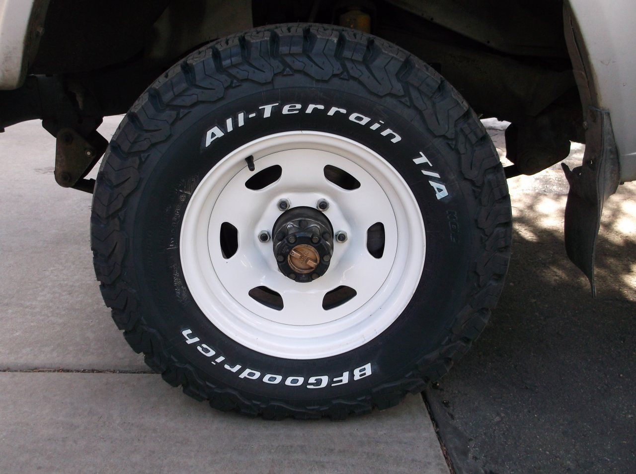

For my '86 FJ60 with OME suspension I decided to go with the Toyota 16X6 steel rims (42601-60262-03) with BFG 235/85R16 T/A KO2s for the following reason:
Any particular reason you are going with 15's @ToddH? Say the same shpeel that my friends that own a truck accessories shop told me.... If you are buying new rims buy what is standard for todays vehicles. GOOD 15" tires are starting to get really hard to find, and that does not count good ALL TERRAIN tires. Your best bet to ensure that you have good tire selection is to move to either 16" or 17" rims and go for a sizing that is similar to what you are looking for in the 15". Down the road this will save you time and money as you are less likely to run into fitment issues, lots of shops will not mount bigger tires on old stock rims if they are not of the MFG suggested width, and you will ensure you have more availability in rural areas should something happen.
The wheels are pricey, but I really like the looks.

I don't know the backspacing off-hand, but they fit just right. They're originally installed on 70-Series Land Cruisers sold in non-US markets. They're very similar in appearance to the FJ60/FJ62 chrome spoke wheels, but they're powder coated at the factory.
